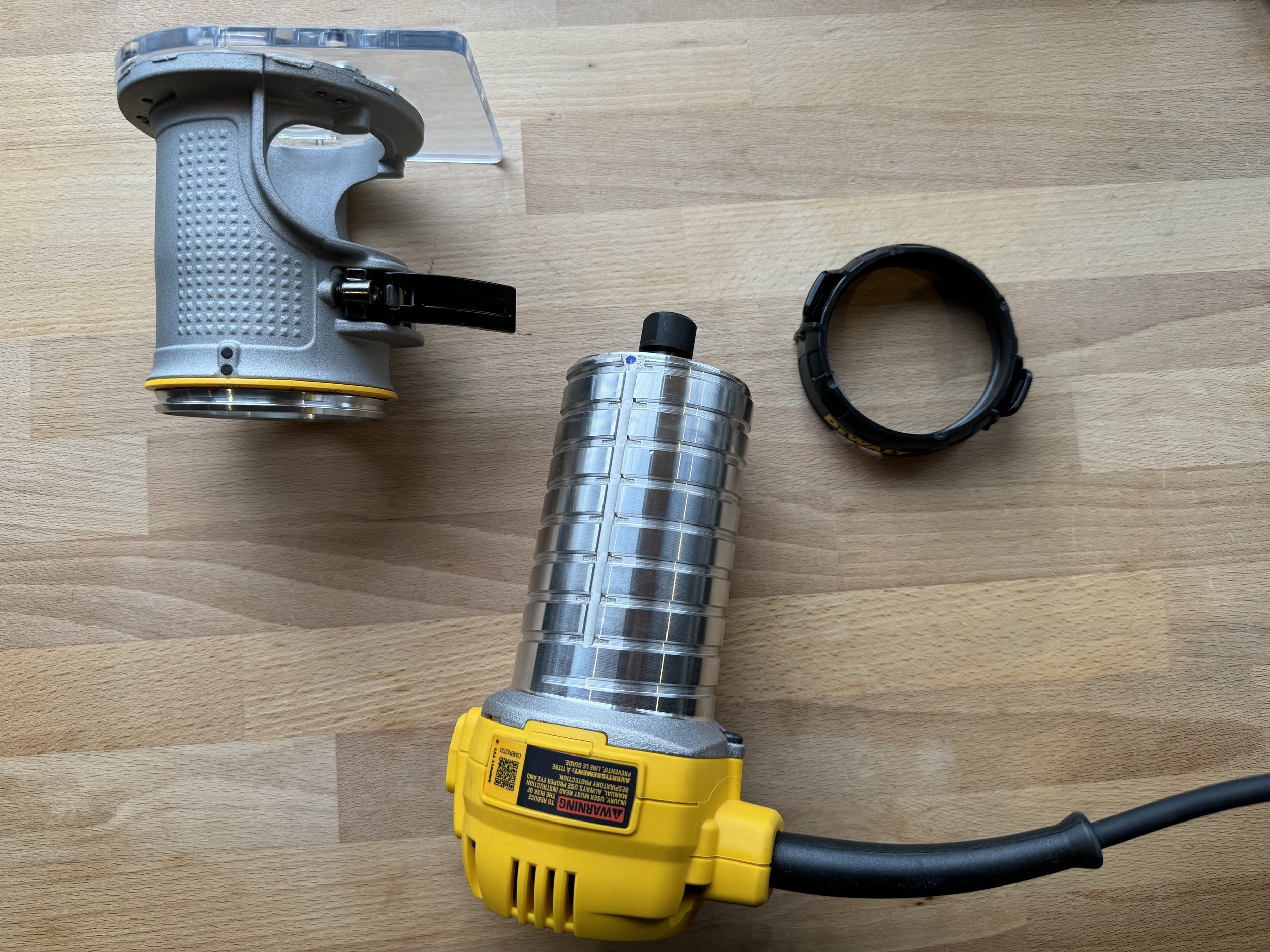

Removing the router body from the base
Remove the router body from the router base. Set the base aside, we won’t need it.

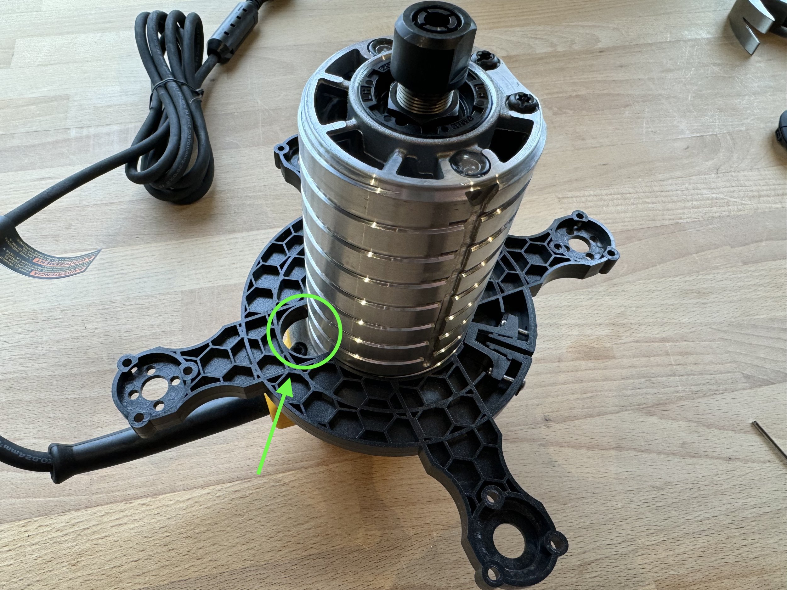

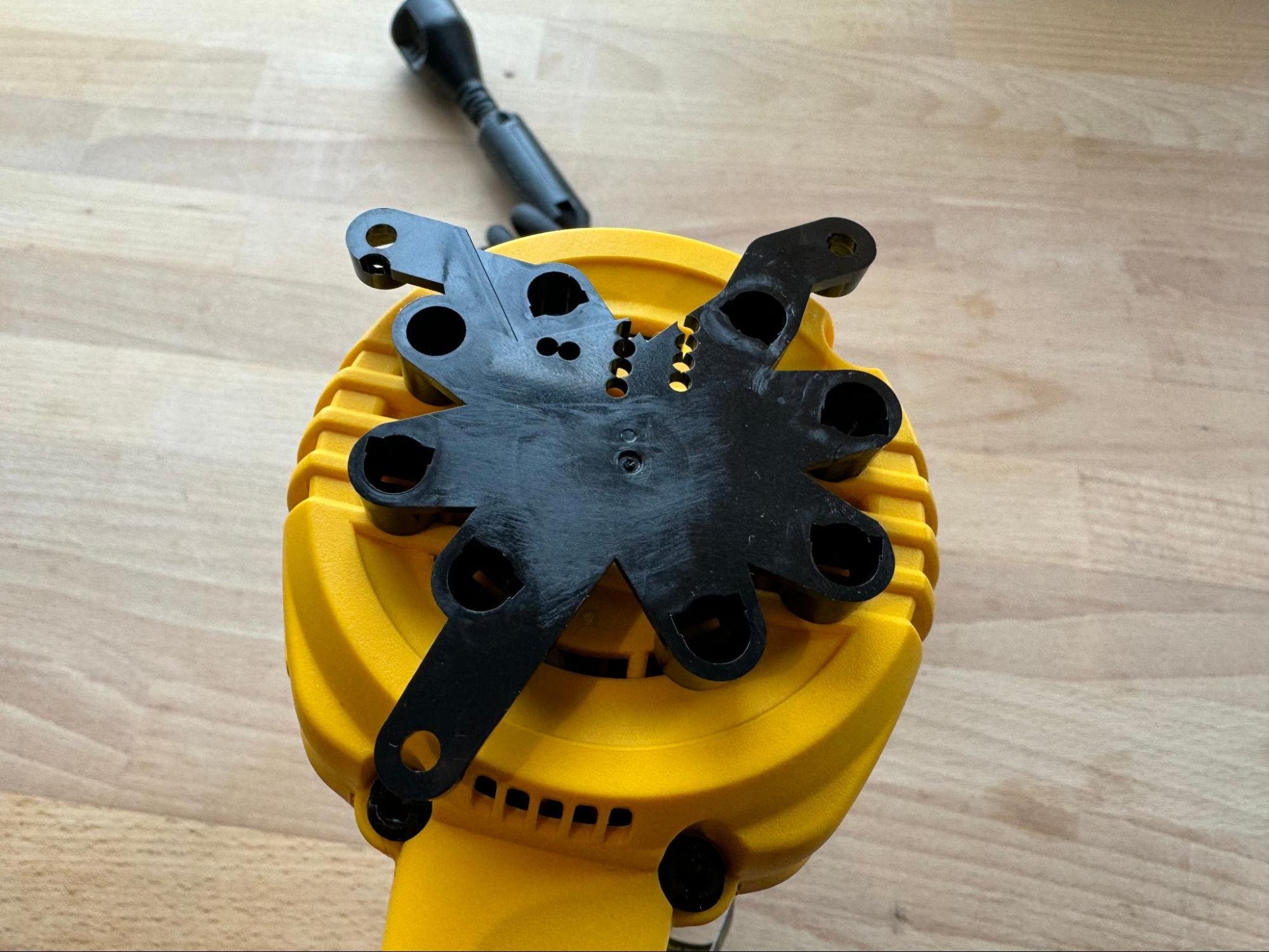

Attaching the PCB mounting plate
Attach the PCB mounting plate to the top of the router. The orientation of this part is important so be sure that it’s not rotated 180 degrees. The power cord is down in this photo. Use a firm slap or a tap on the table to press it in place.
Note: This part has been reported to fit not quite right on the 240 volt version of the router. See a potential modification to this part here.

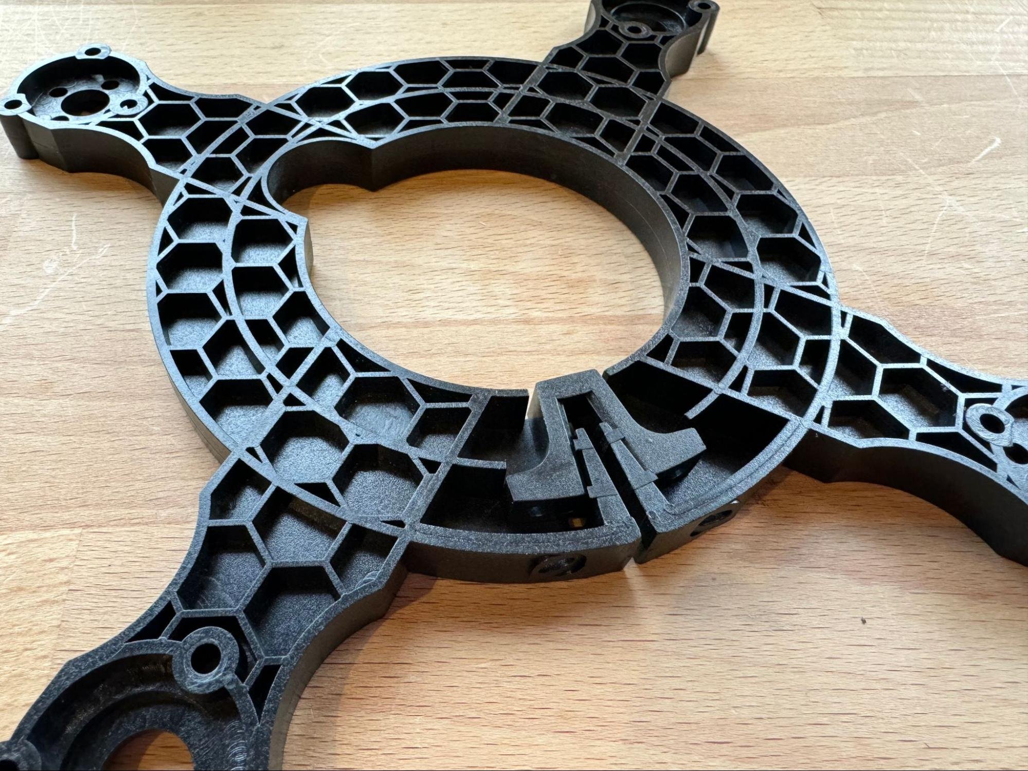

The first router clamp
Next find the first router clamp. Note that this is actually two parts together.

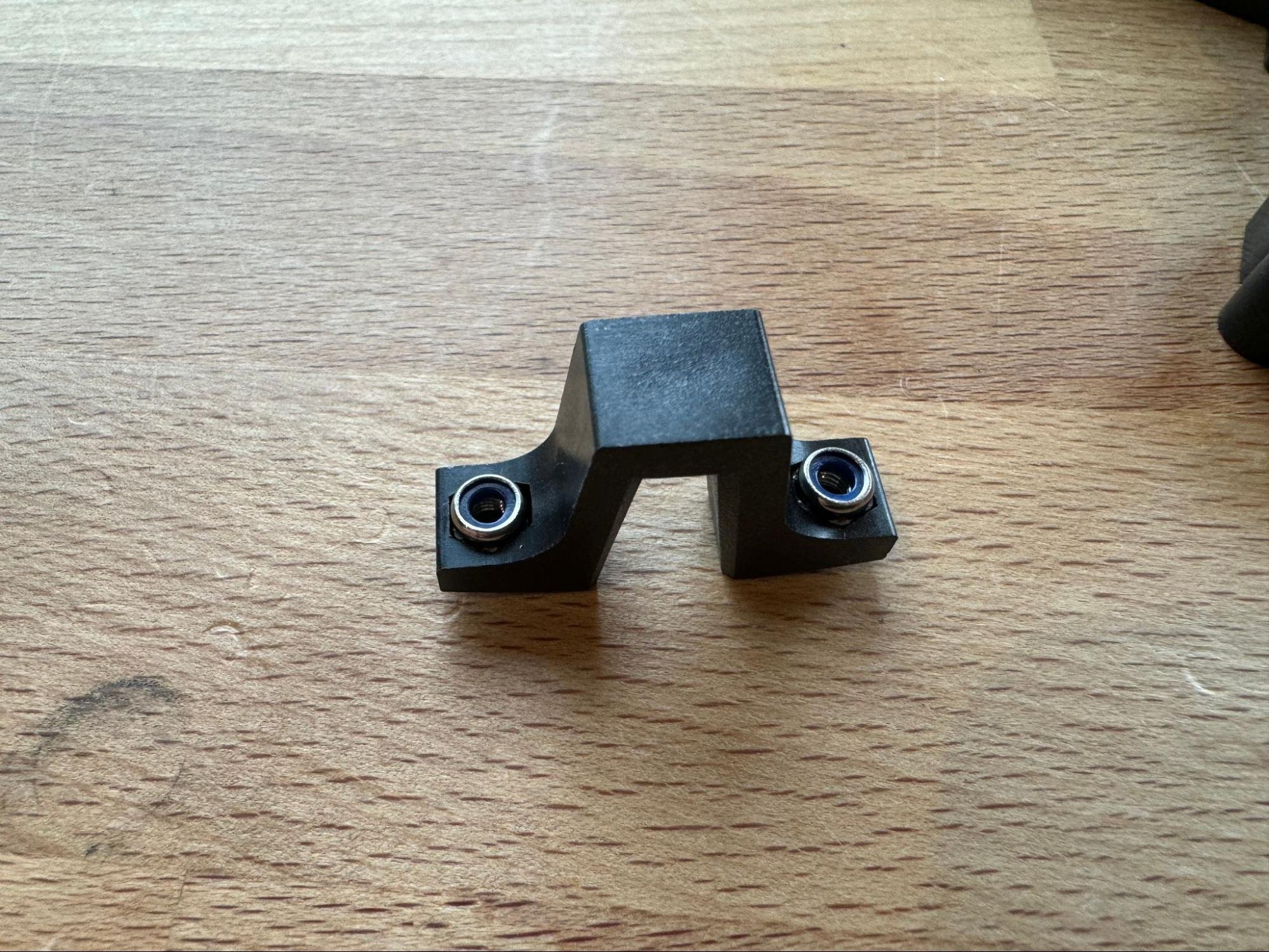

Separating the wedge and inserting lock nuts
Separate the clamping wedge and insert two lock nuts..

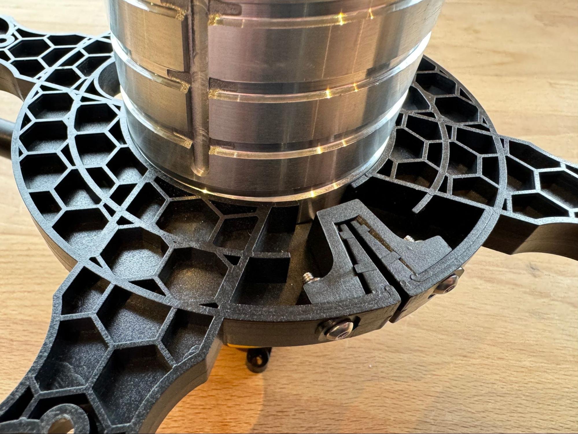

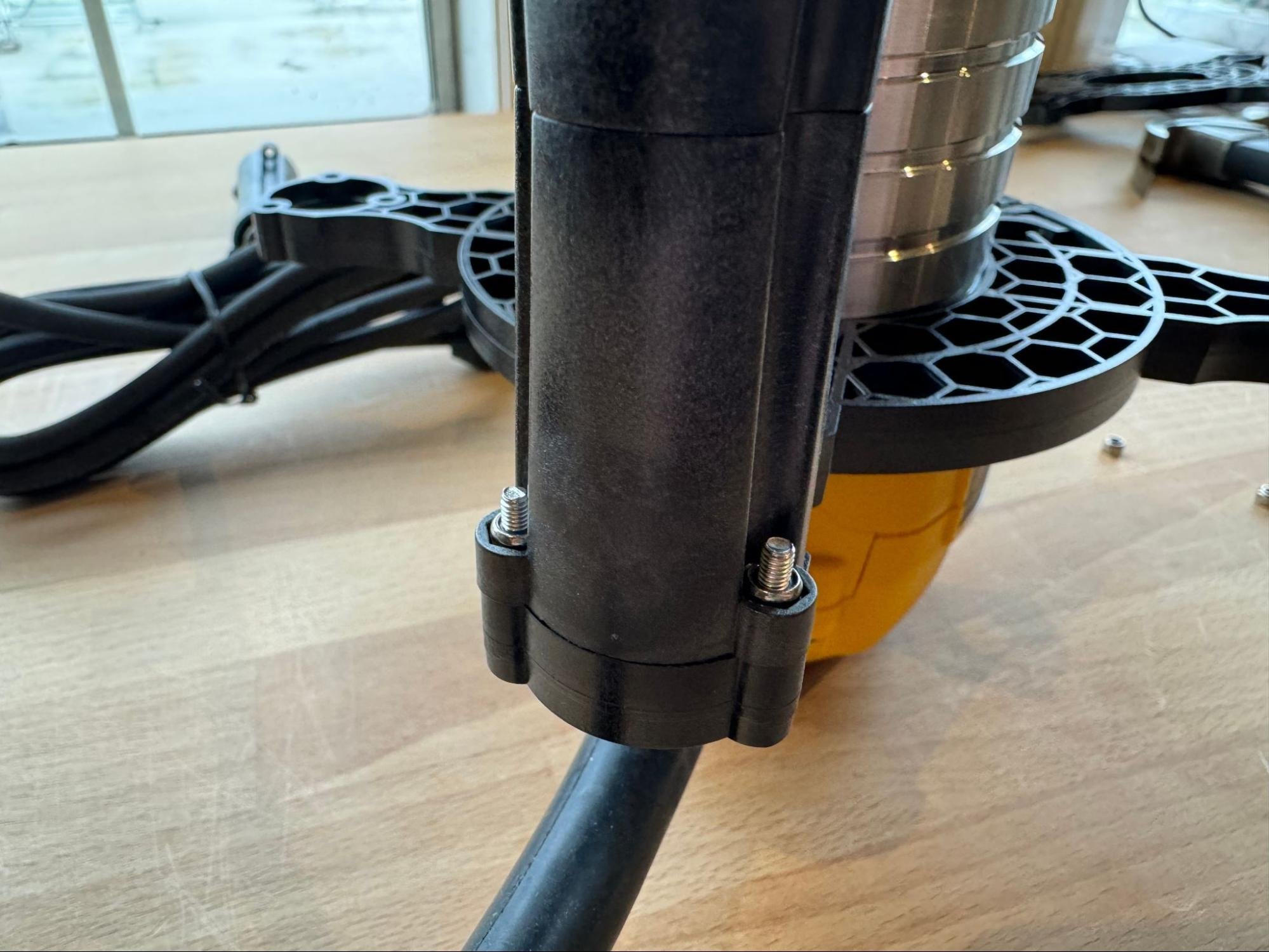

Sliding the clamp down the router
Put the wedge back on the clamp and add two bolts so that they just barely start to engage the threads on the bolt. Then slide the clamp down the router. Note that the notch in the clamp should be towards the power cord.
Tightening the clamp bolts
Next, tighten the two bolts to lock the clamp in place.

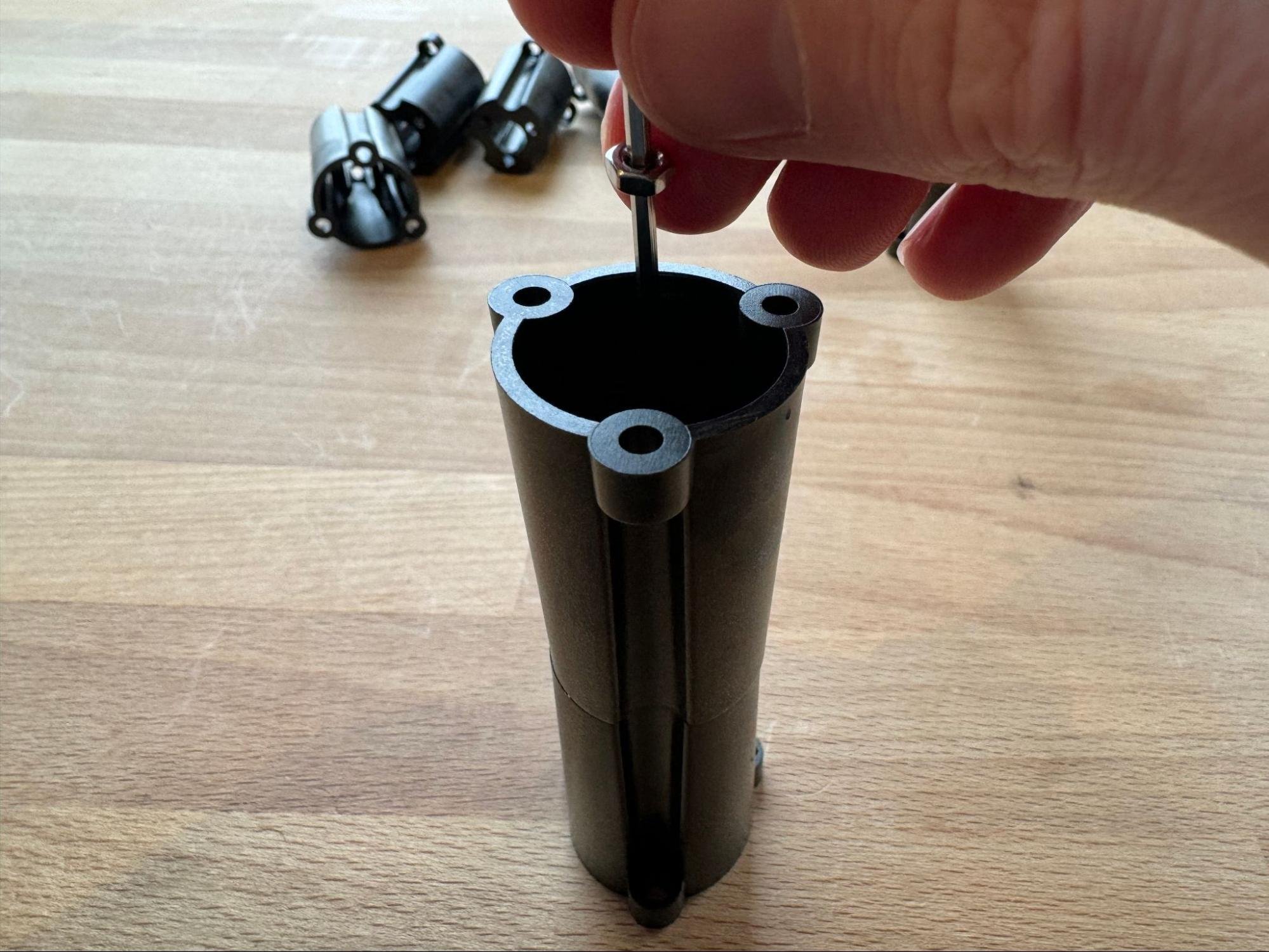

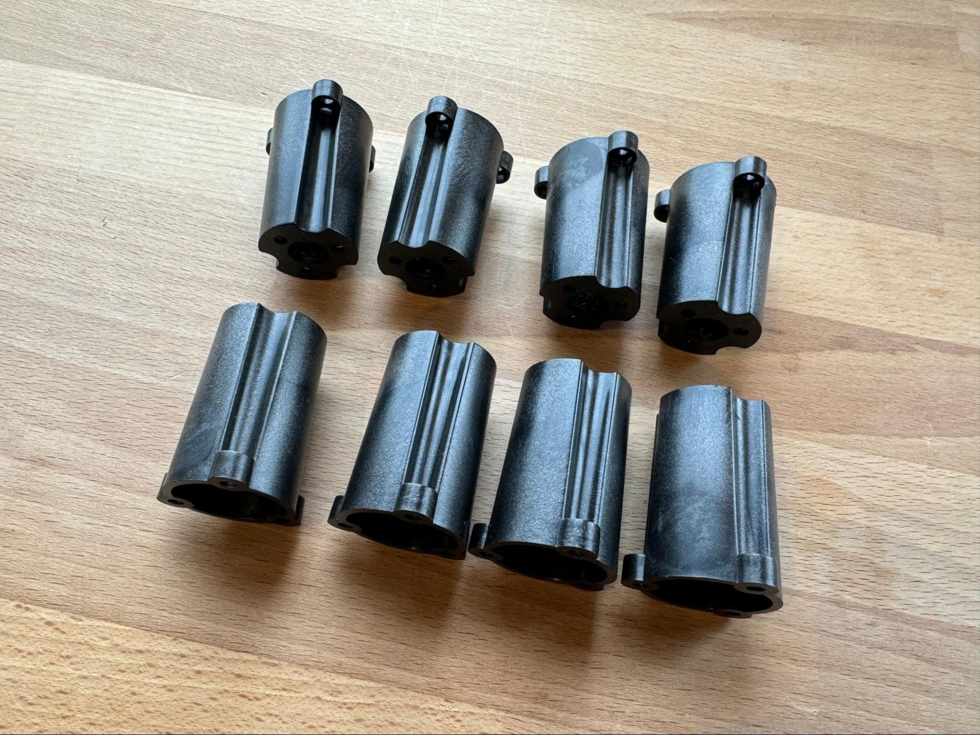

The eight upright pieces
Next, collect the eight pieces which make up the Maslow4 uprights.
Guiding nuts into the upright recesses
Stack two on top of each-other and then use the Allen wrench to guide a nuts into place in the three recesses at the bottom. I used the regular nuts instead of the lock nuts here because I find it easier.
Adding a bolt from the other side
Then add a bolt from the other side. I like to thread the bolts in from the bottom while letting gravity hold the nuts in place.

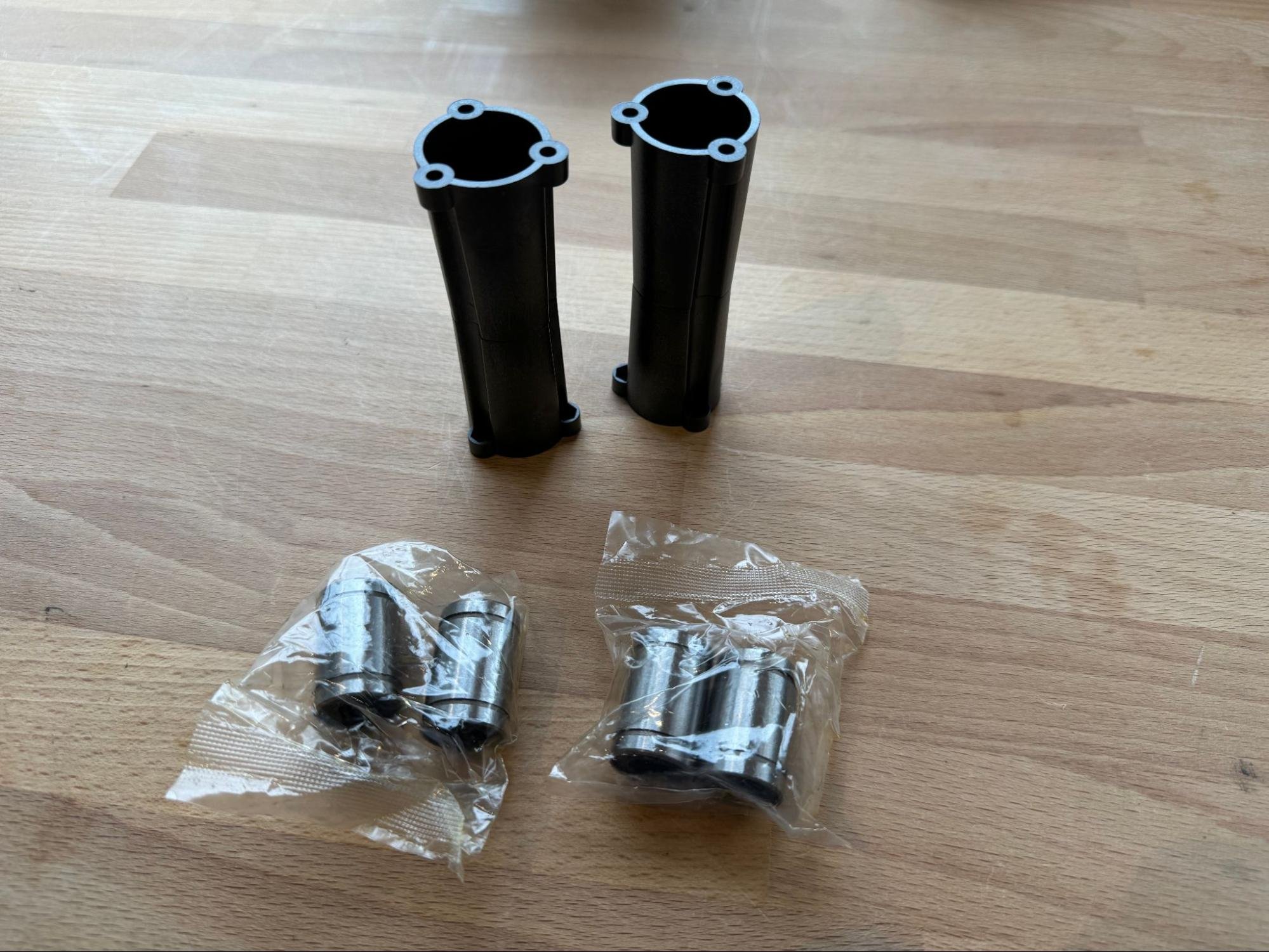

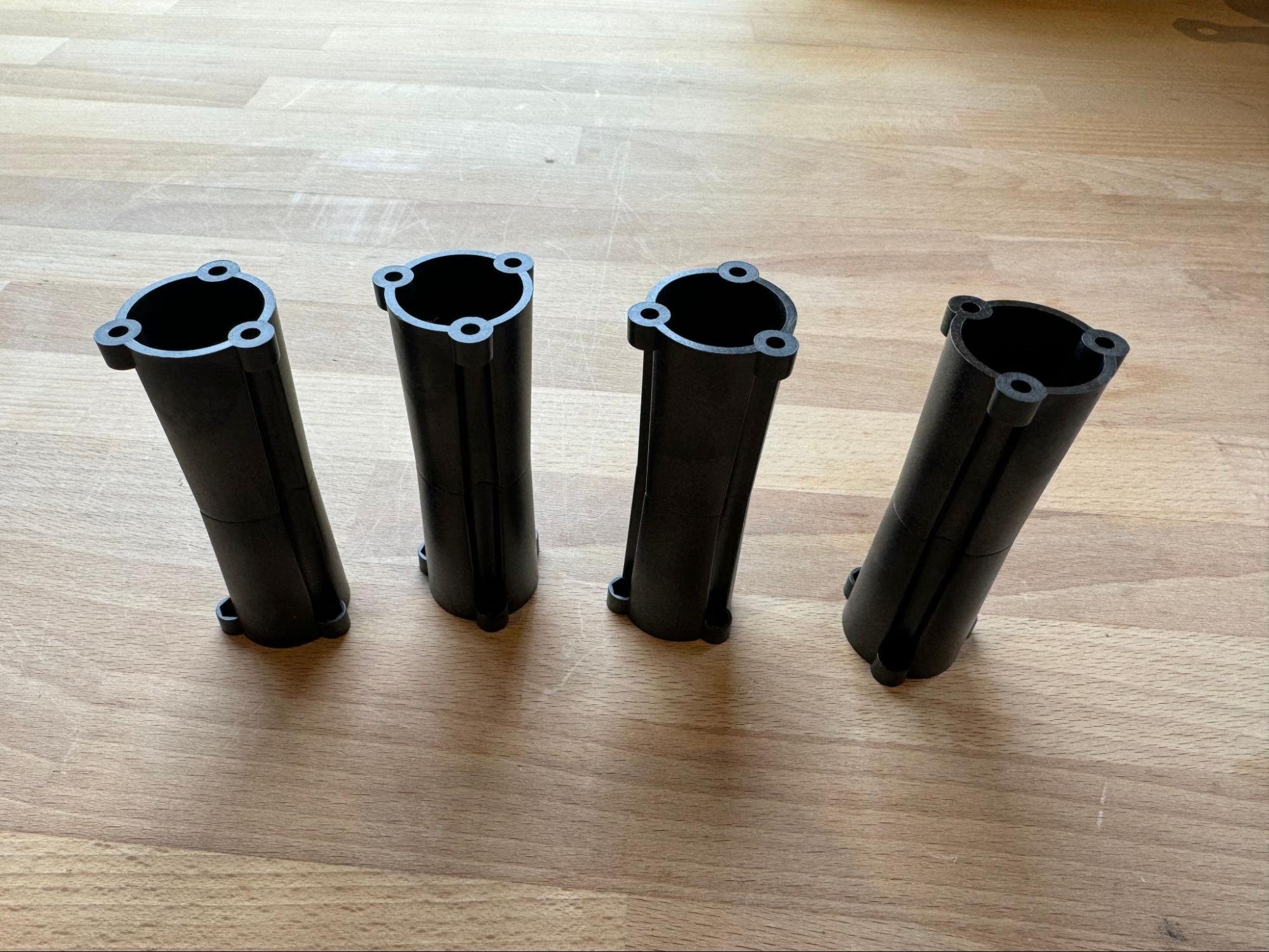

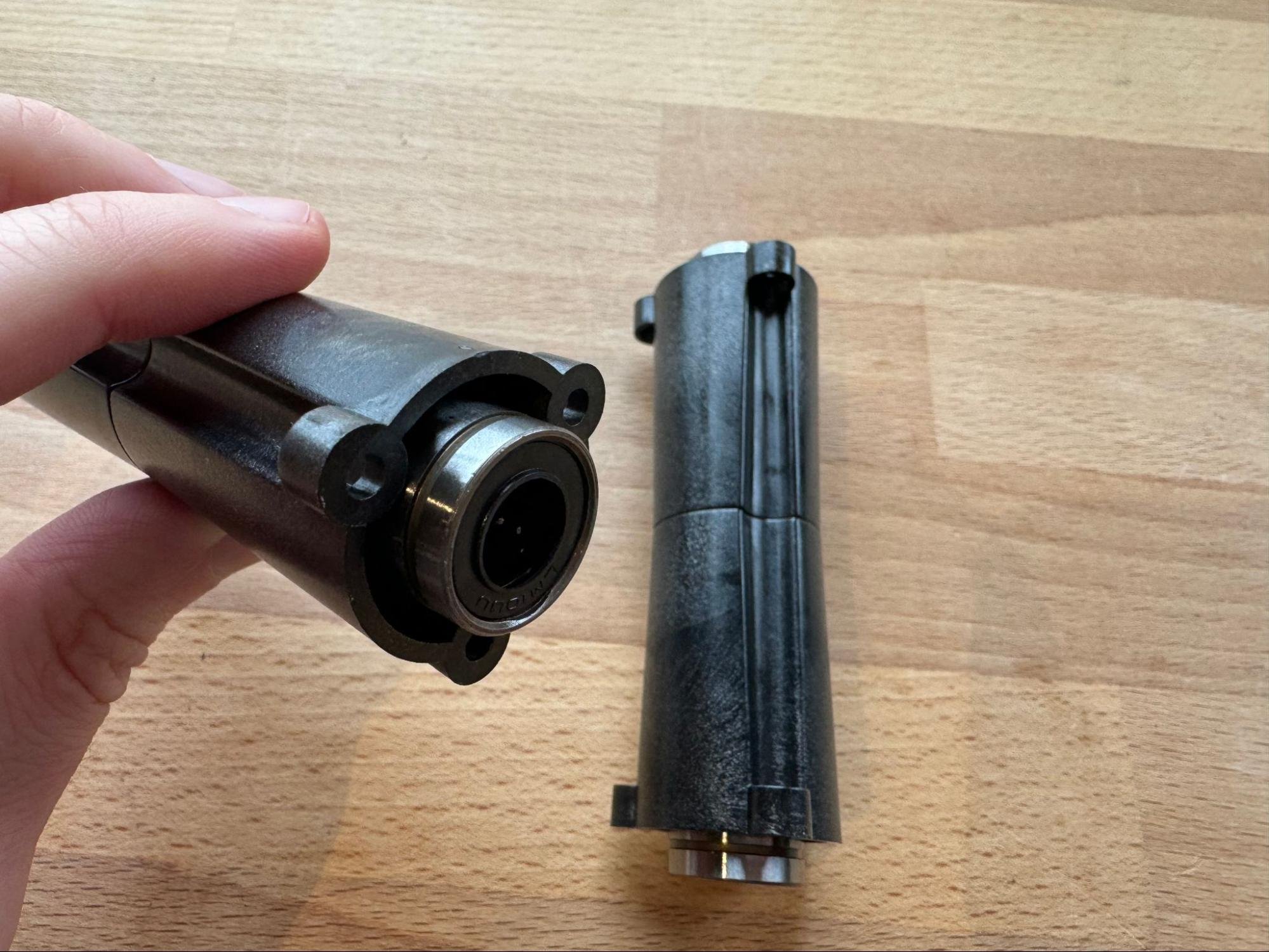

The linear bearings and two uprights
Next collect the linear bearings and two of the uprights.

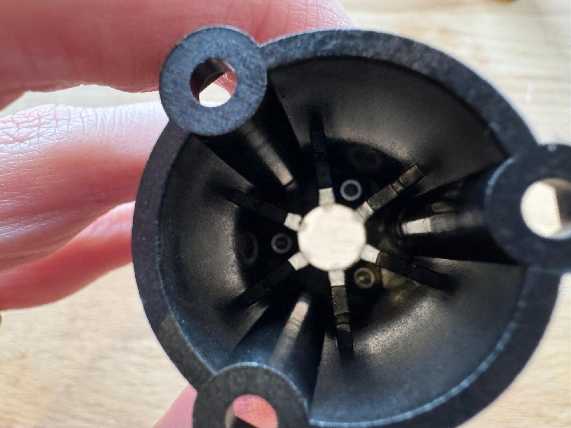

Pressing a linear bearing into each end
Press a linear bearing into each end of those two uprights.

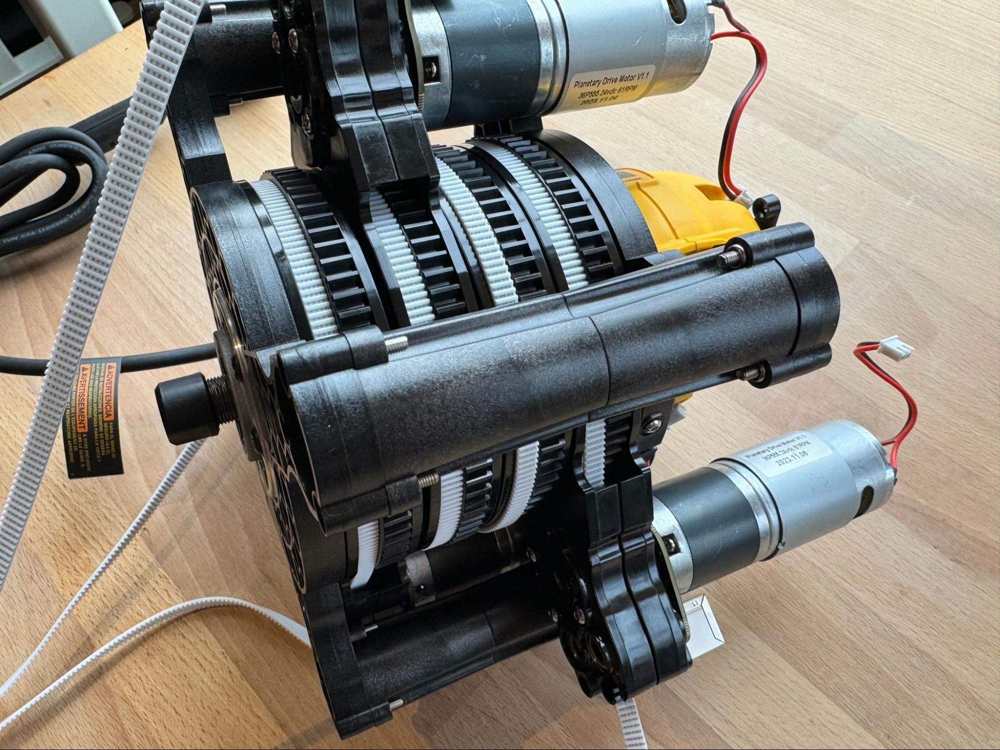

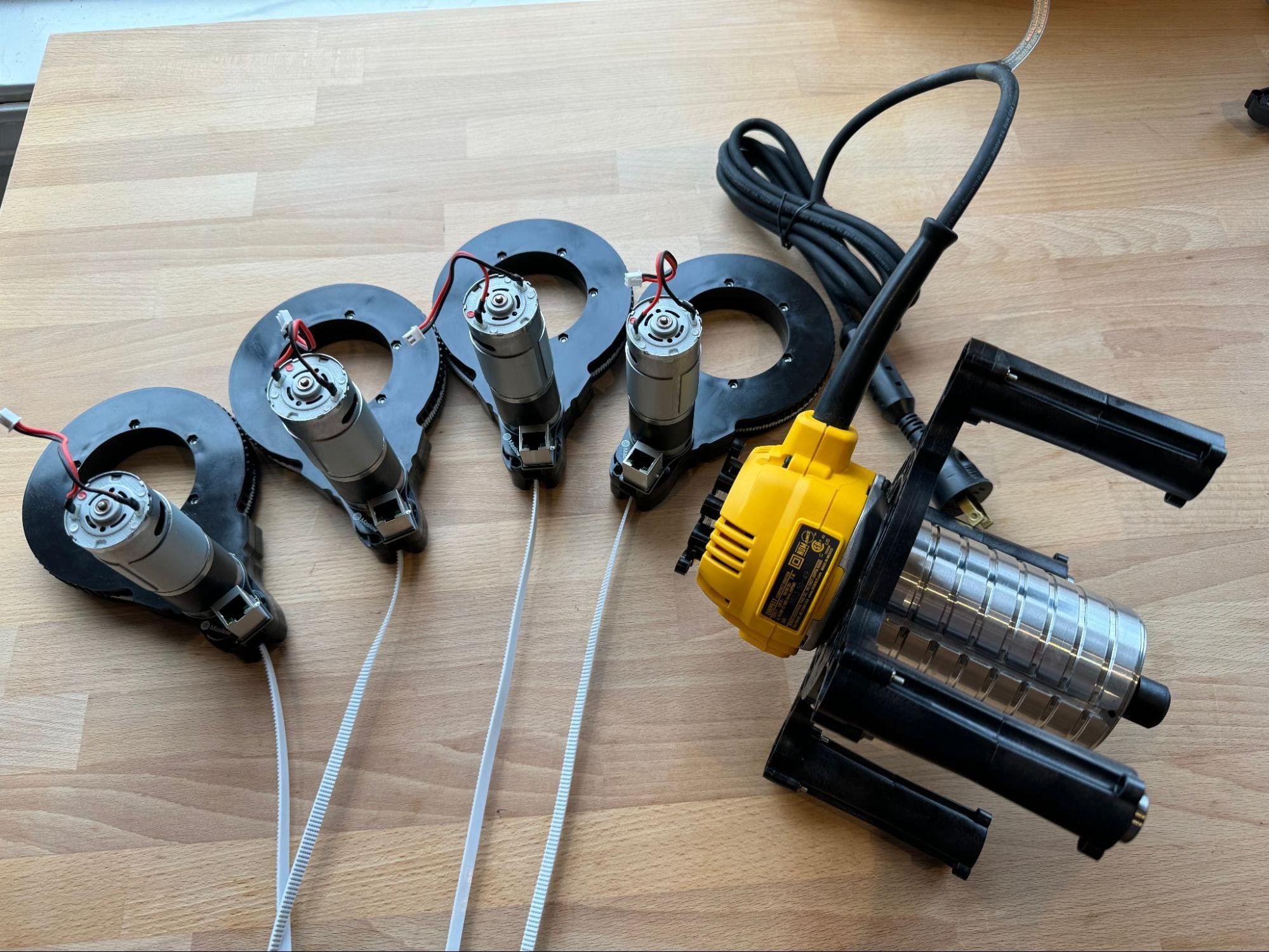

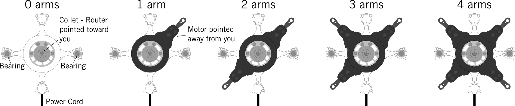

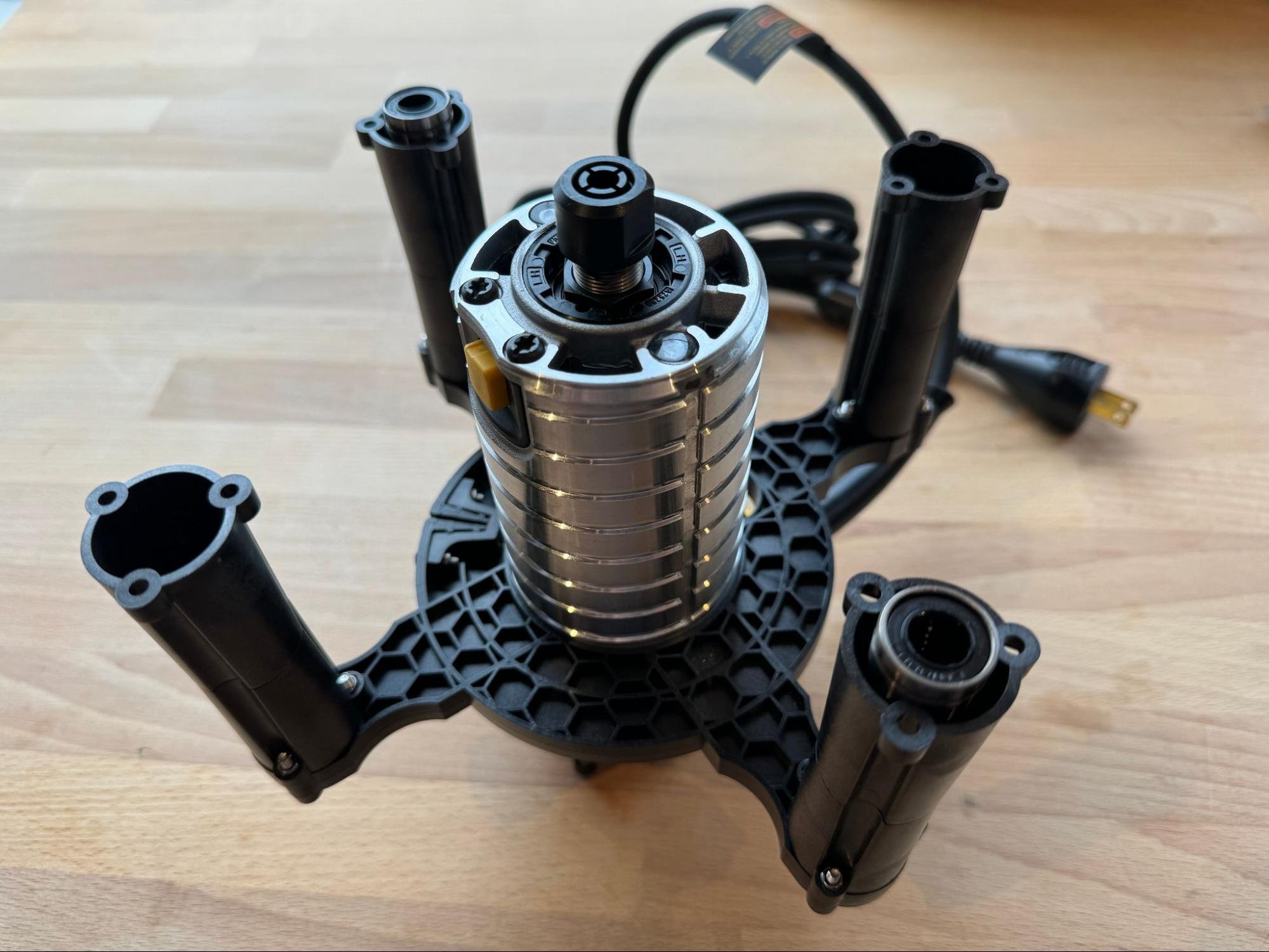

Gathering the four arms
Gather the four arms that we built previously.

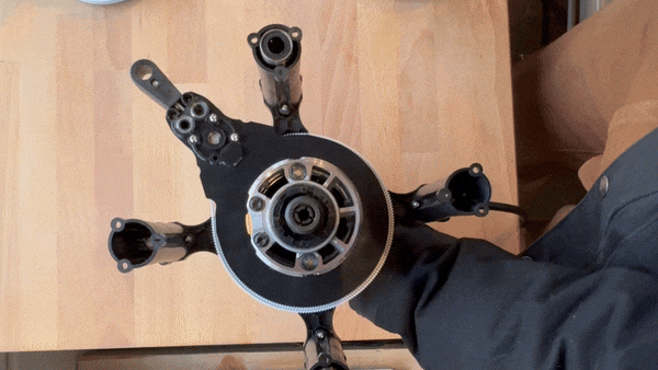

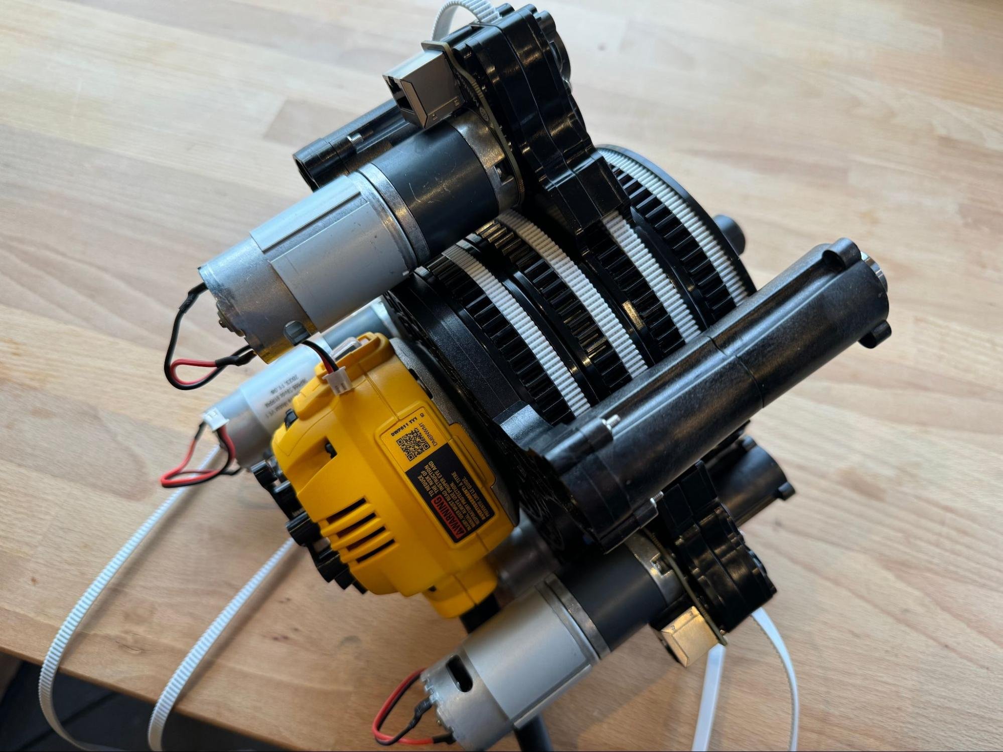

Sliding the arms onto the router
And slide them onto the router. Note that the order that they go on is important. See the illustration below for the correct order.
Correct arm assembly order
Credit to jwolter for creating this helpful image
Assembly process animation
Here is a gif showing the assembly process. Note that the power cord is to the right in this clip.
And here is a video: Arm Installation Video

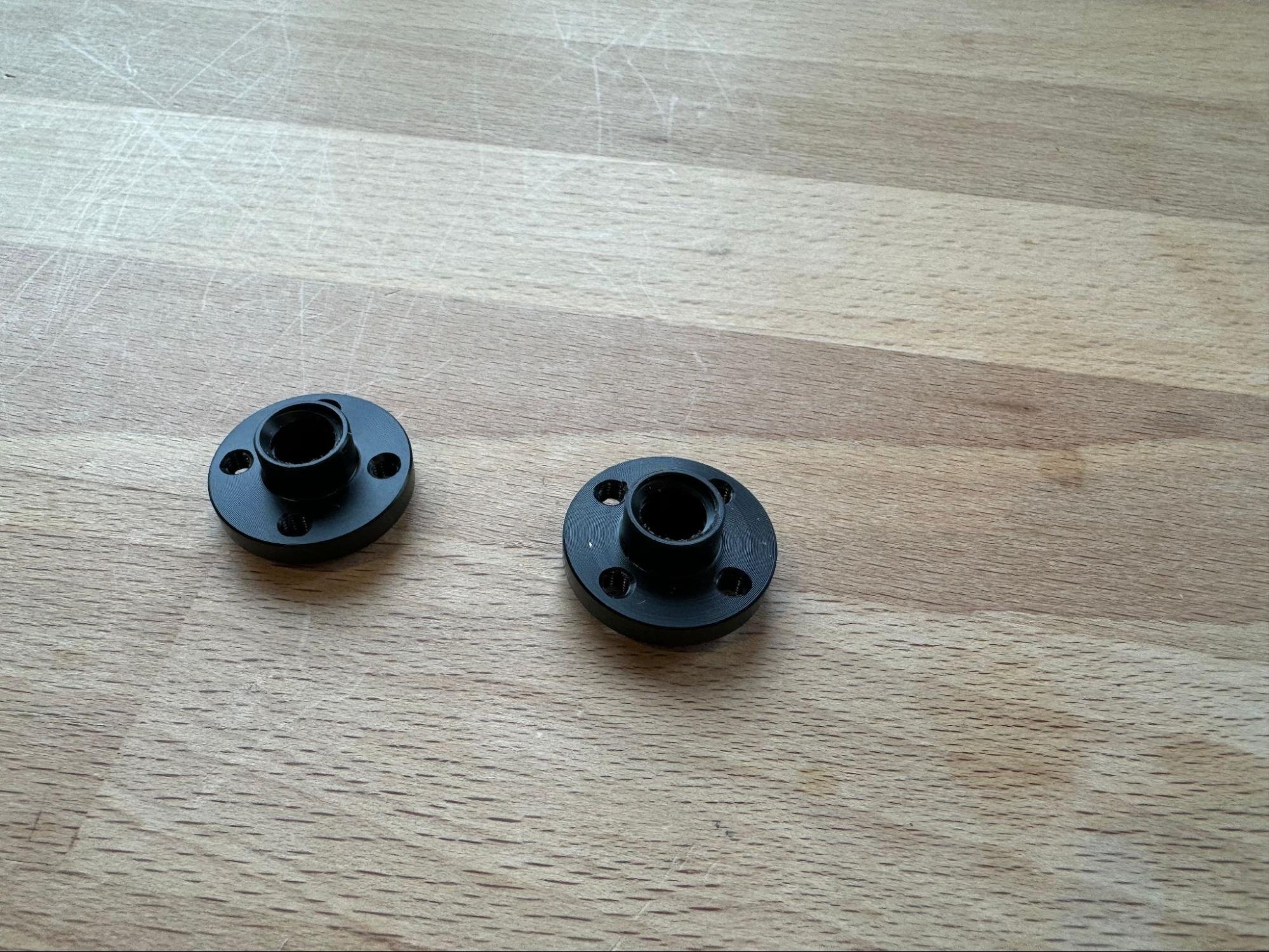

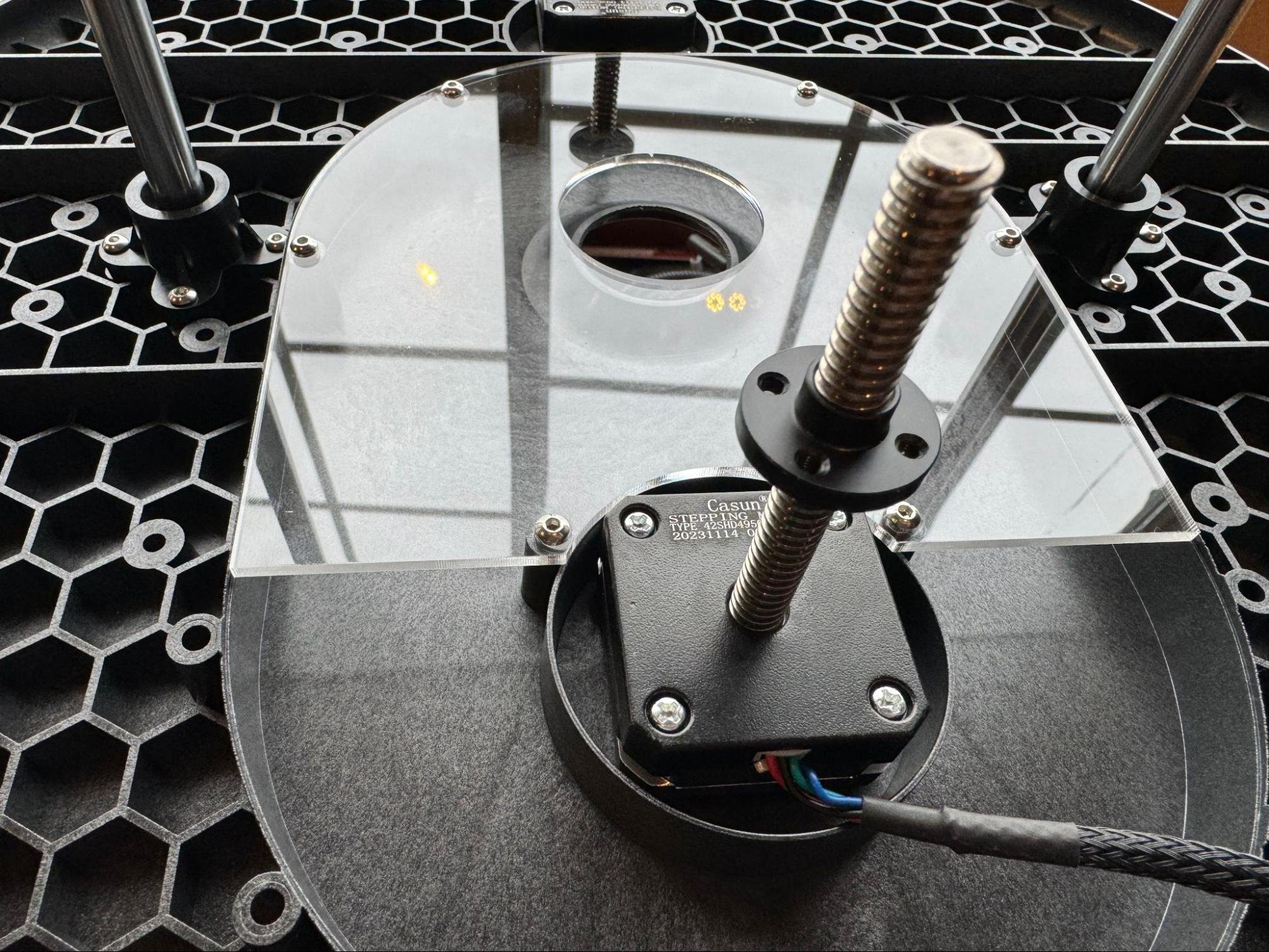

Removing the leadscrew nuts
Next remove the two leadscrew nuts from the z-axis stepper motors attached to the sled.
The leadscrew nuts
They will look like this.

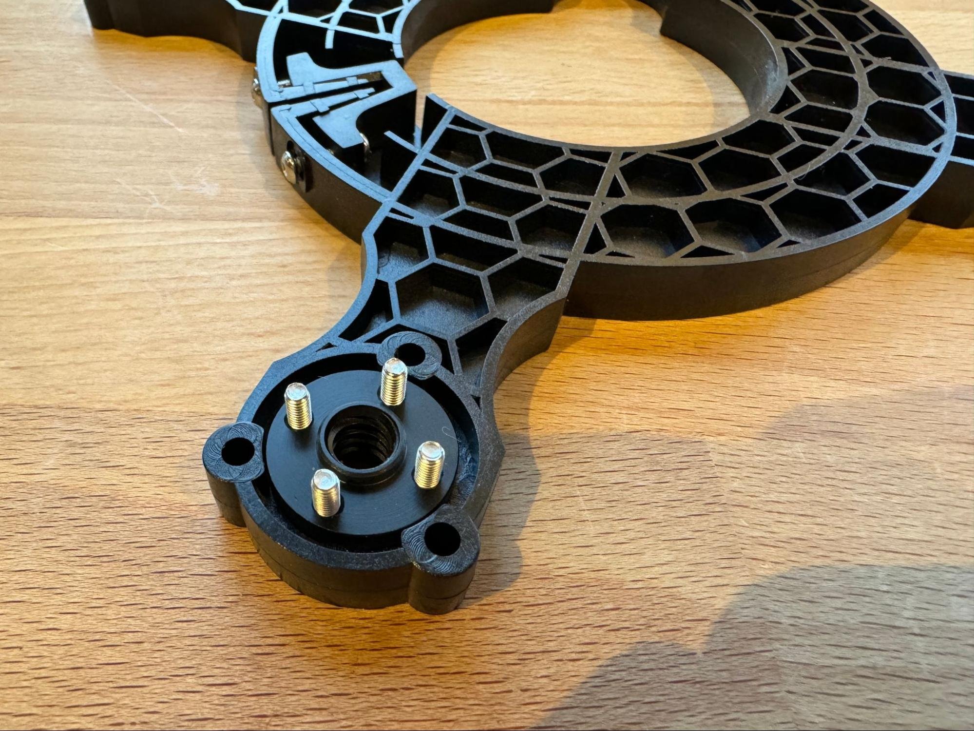

Bolting the leadscrew nuts into the second clamp
The two lead screw nuts will bolt into the second router clamp like this. The nut has a longer side and a shorter side. The direction is not critical, but I put the longer side down as shown in the picture.
Repeat the process of adding nuts and bolts to the clamping wedge on the lower clamp the same as on the upper router clamp.

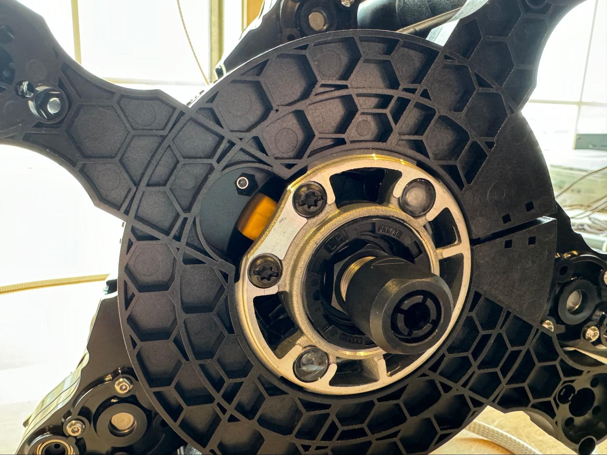

Flipping the router clamp into place
Flip the router clamp into place on the router so that the notch in the clamp aligns with the yellow button on the router.
Tighten the bolts to lock the clamp in place

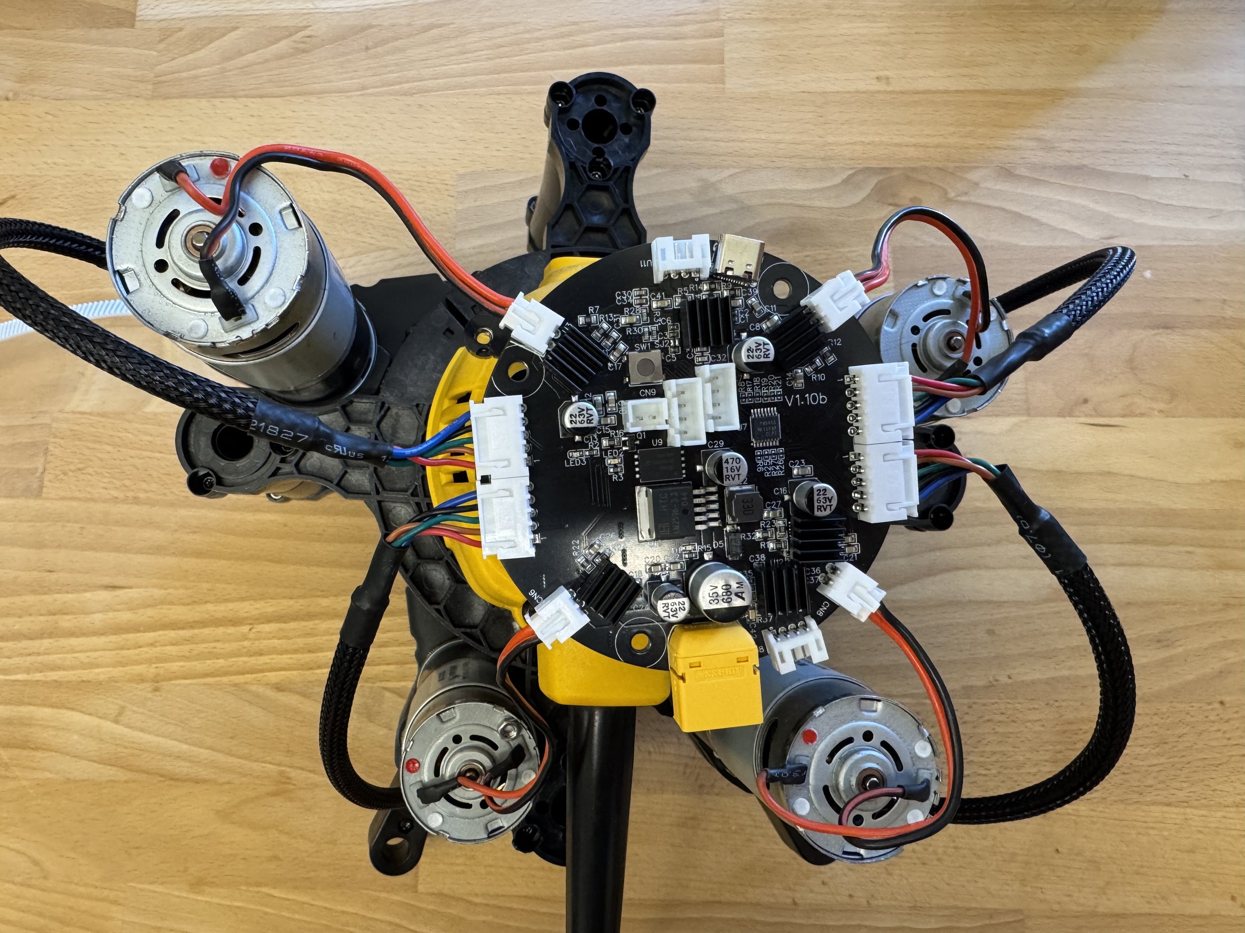

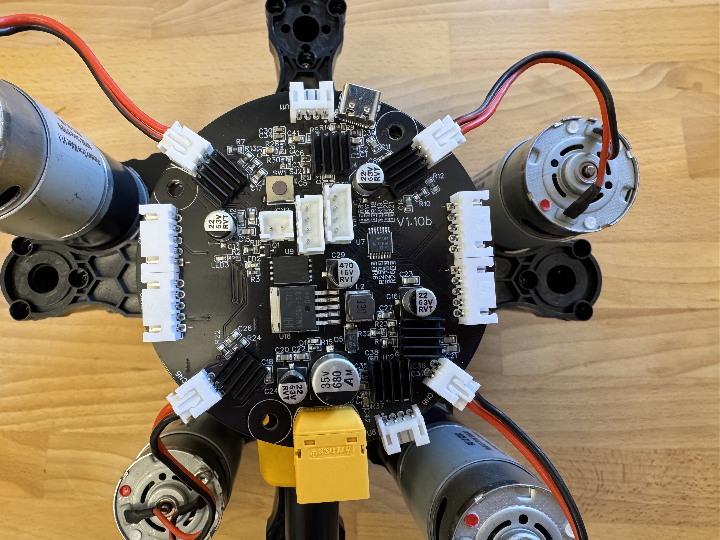

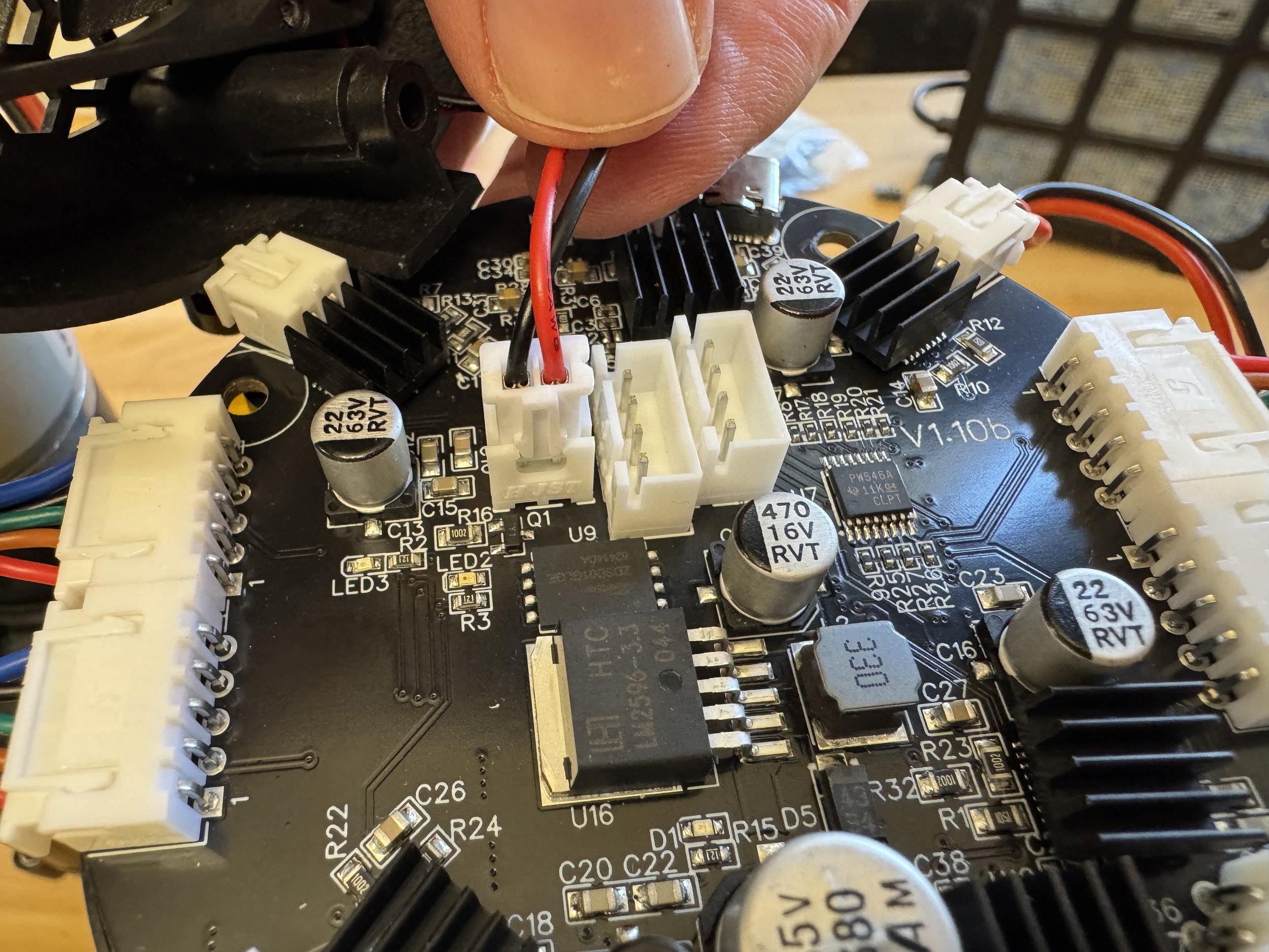

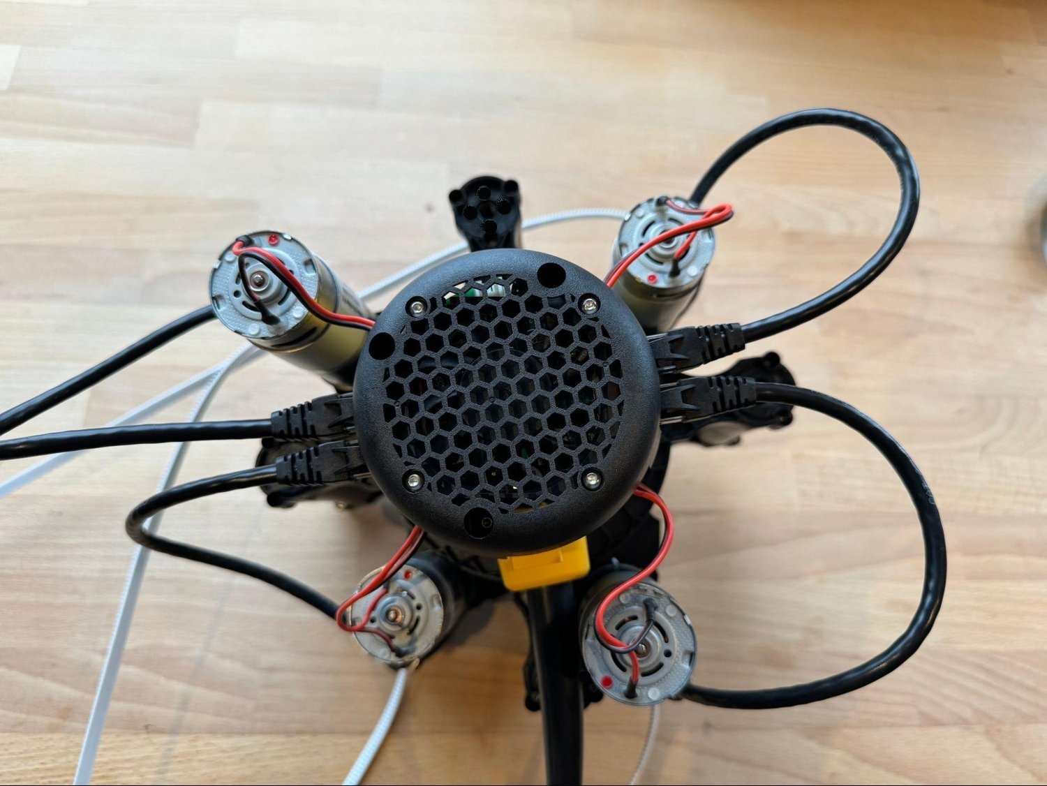

Placing the main controller board
Place the main controller board on top of the router and plug in the four motors.
Connecting the encoder cables
Use the four JST-XH cables to connect the encoders to the controller board.

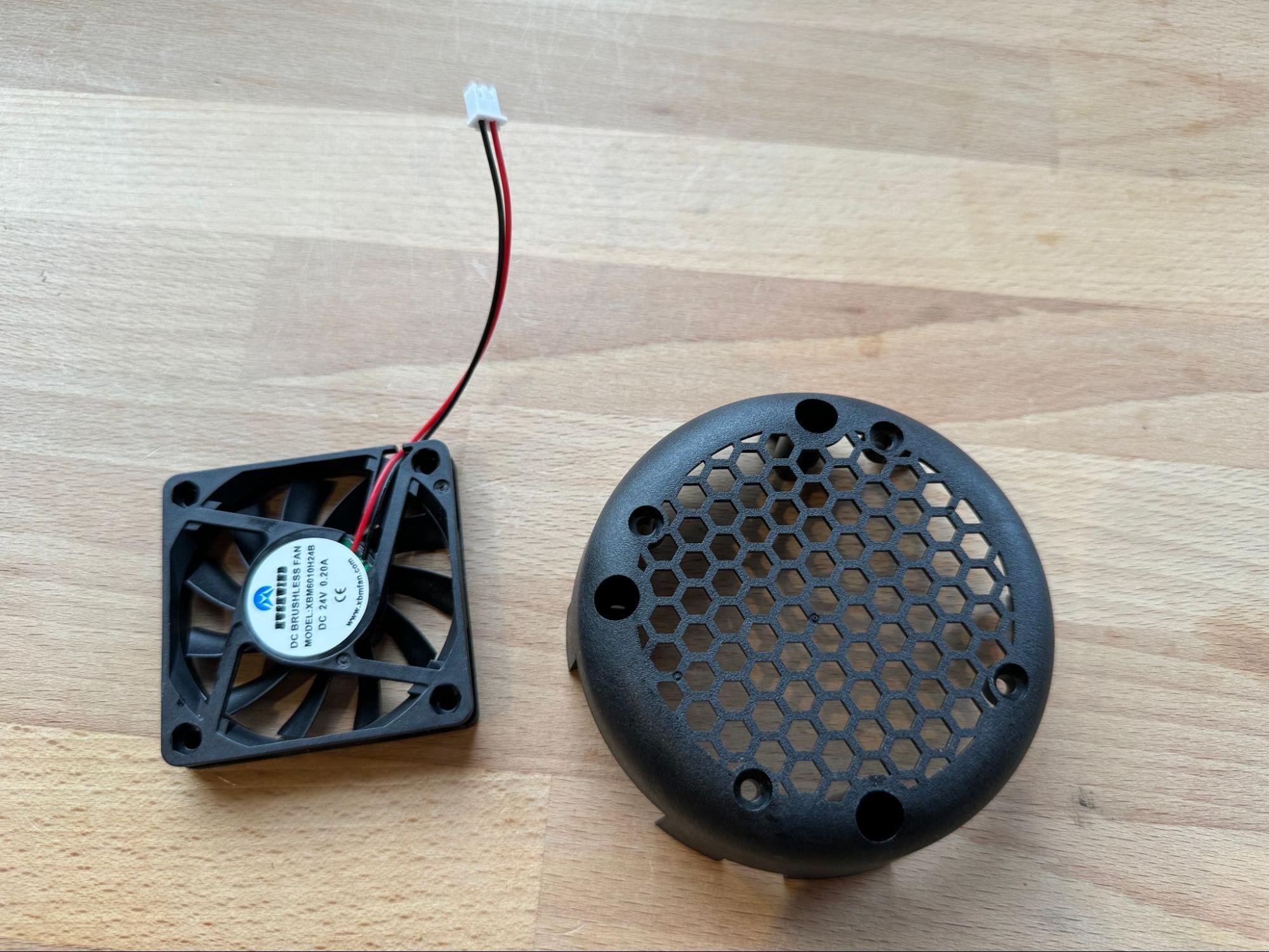

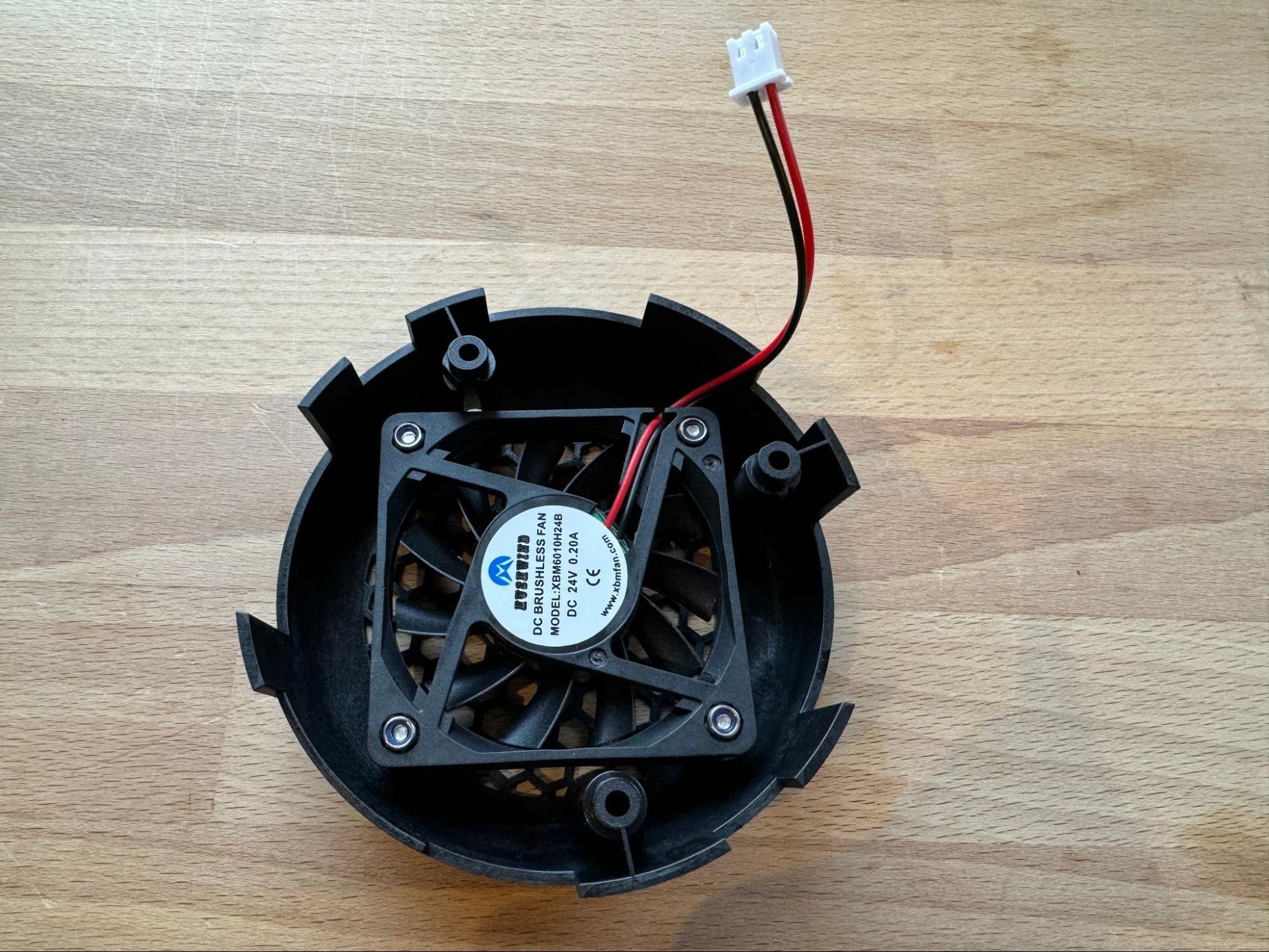

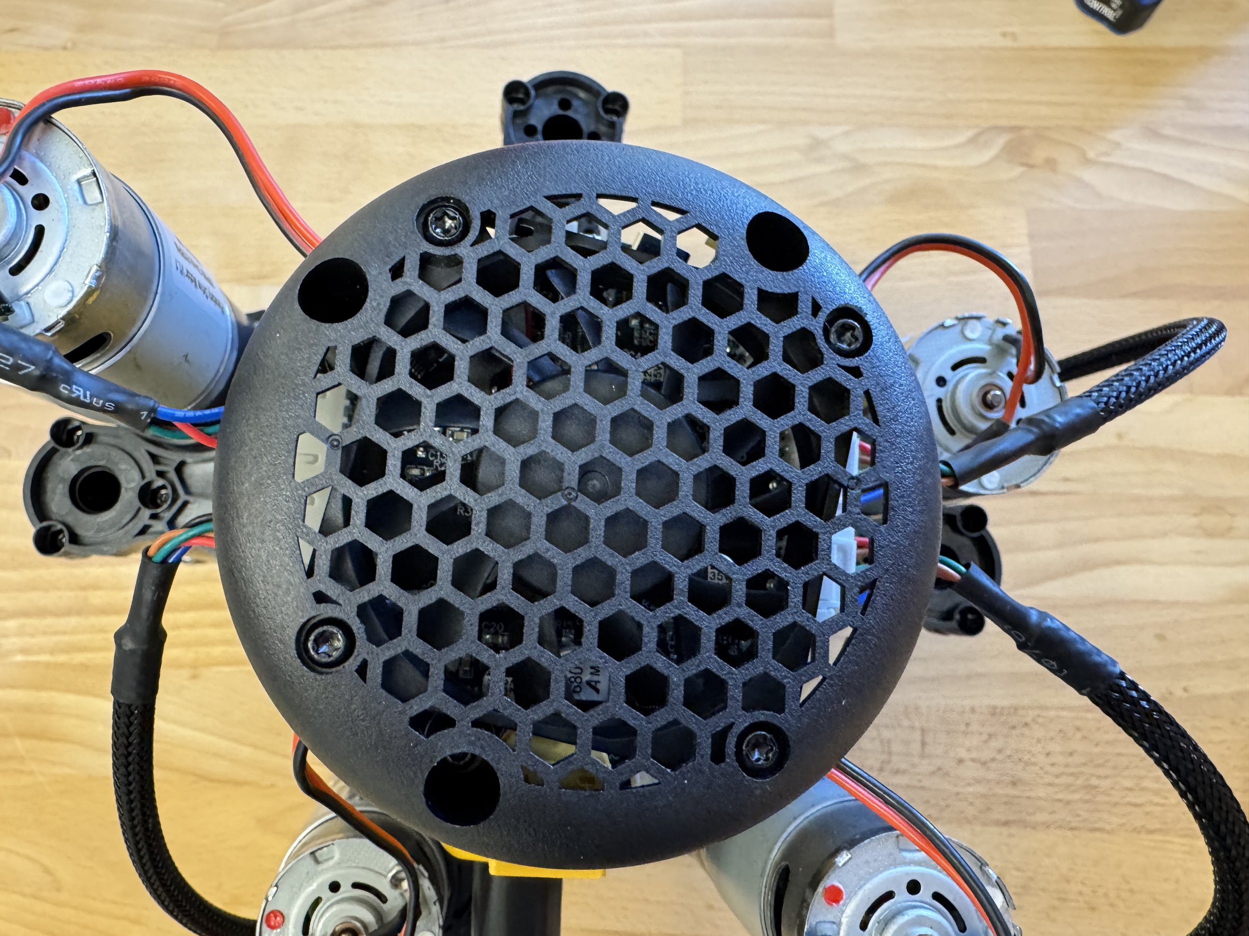

The cooling fan and PCB cover
Next collect the cooling fan and the PCB cover
Bolting the cooling fan into the cover
Bolt the cooling fan into the controller cover using four bolts.

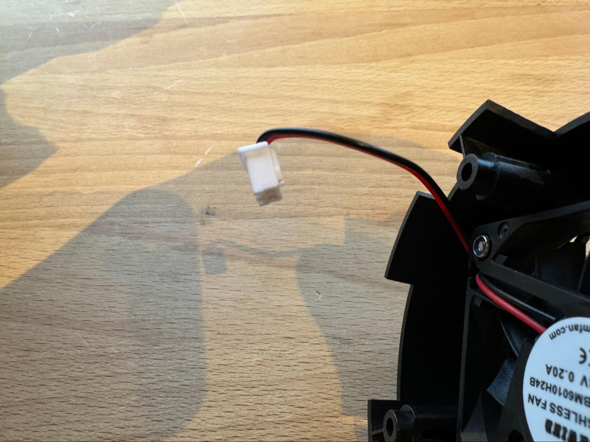

Bending the fan wire
Add a slight bend to the fan wire close to the connector. This will help keep the wire directed so that it won’t go into the fan blades once everything is assembled.
Plugging in the cooling fan
Plug the cooling fan into the controller board.
Bolting the PCB cover, board, and router together
Finally bolt the PCB cover, the controller board and the router together using three bolts and three nuts placed underneath.
