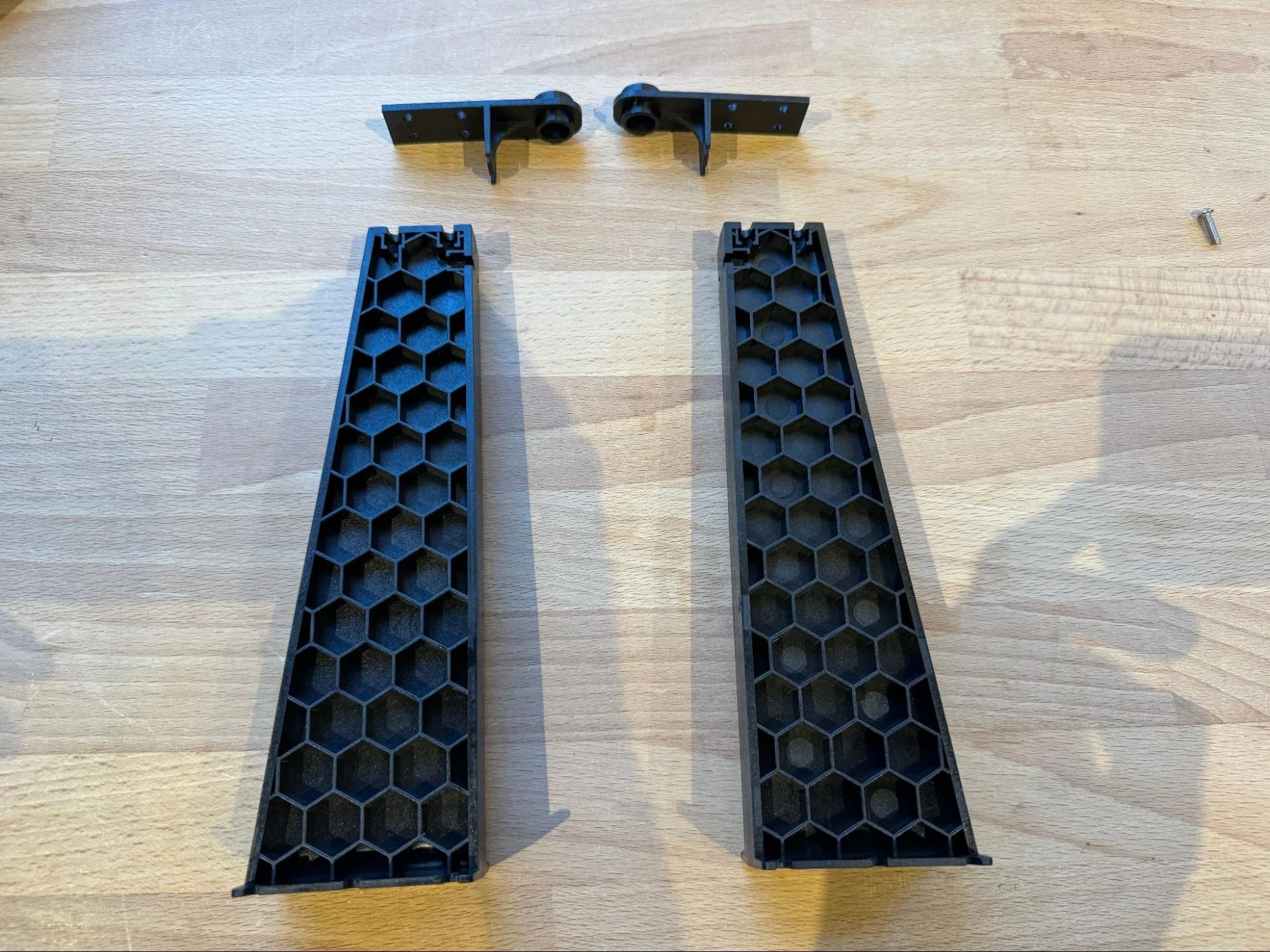

The two linear rod supports and support tops
First collect the two linear rod supports and the two linear rod support tops.

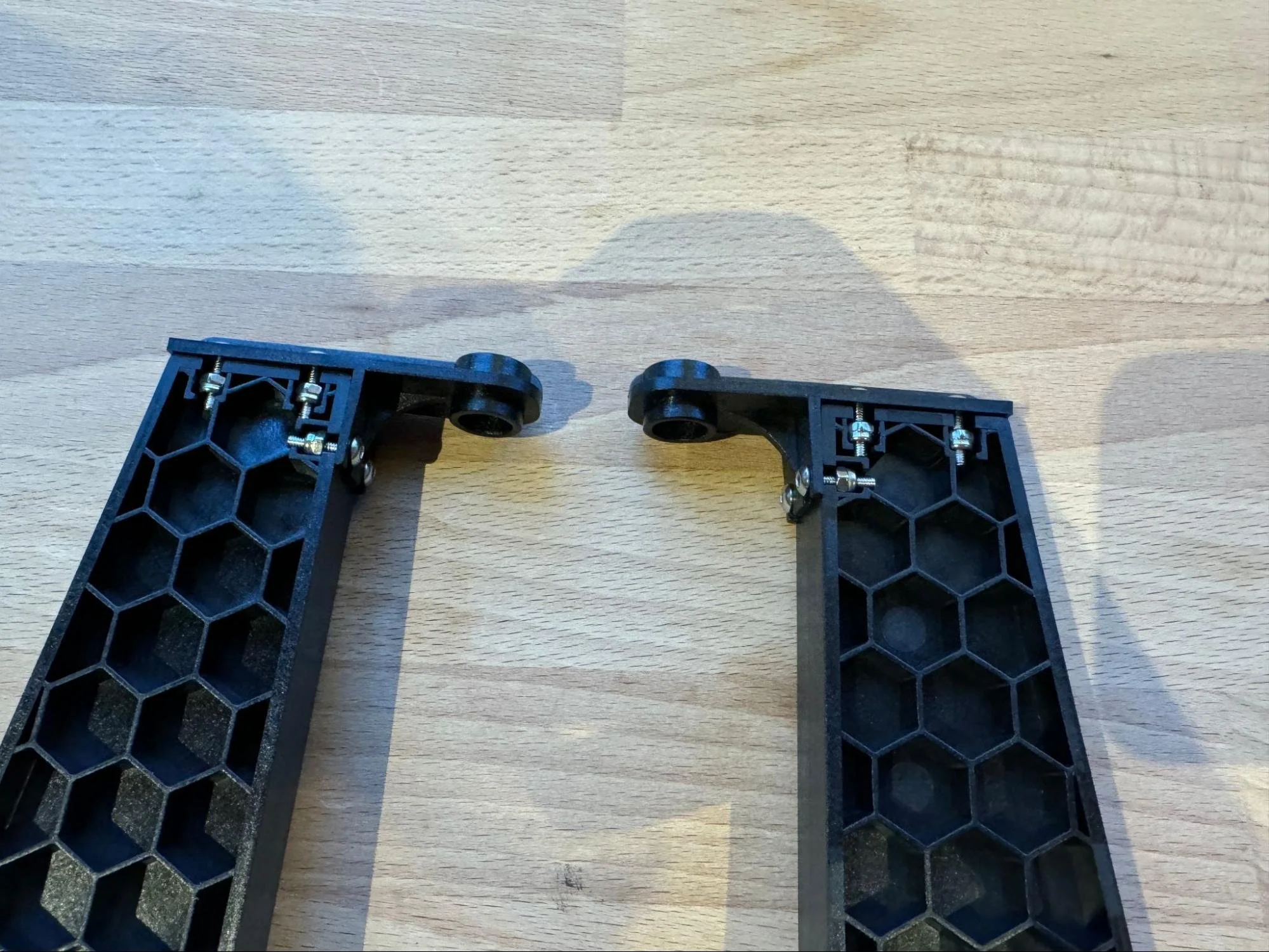

Attaching the support tops
Attach the tops using six nuts and bolts each.

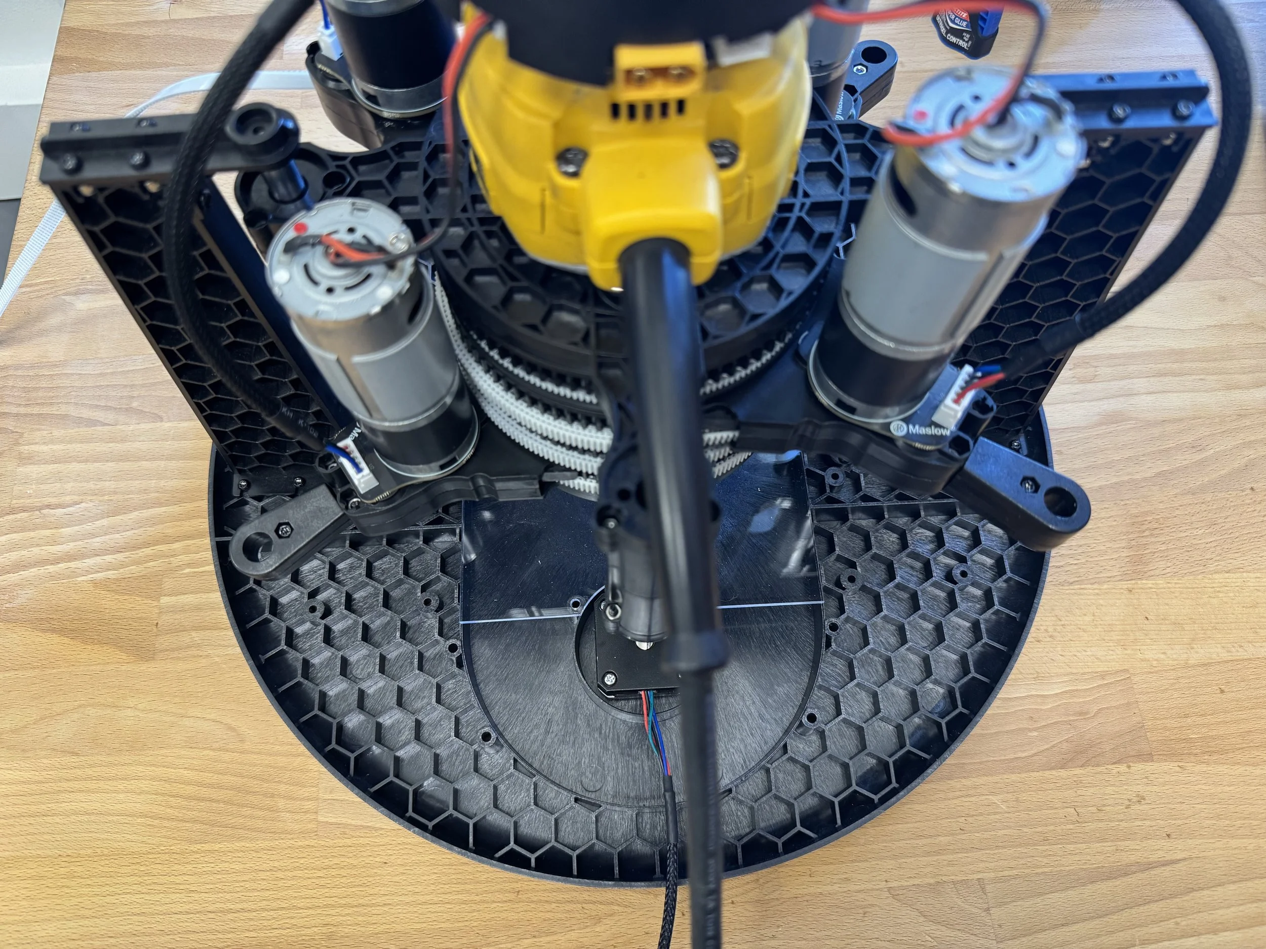

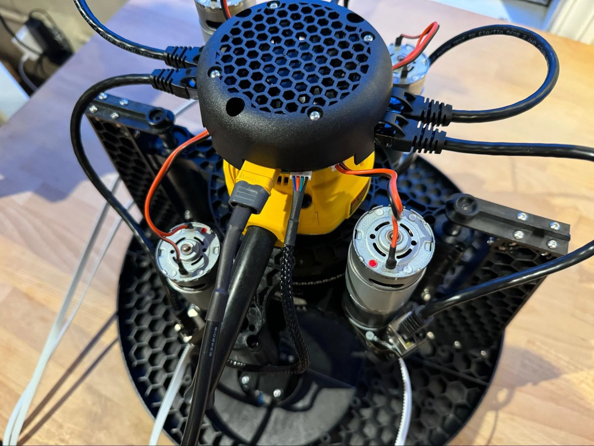

Place the router assembly onto the sled assembly orientated so that the power cord lines up with the dust collection port outlet.
Placing the router assembly onto the sled

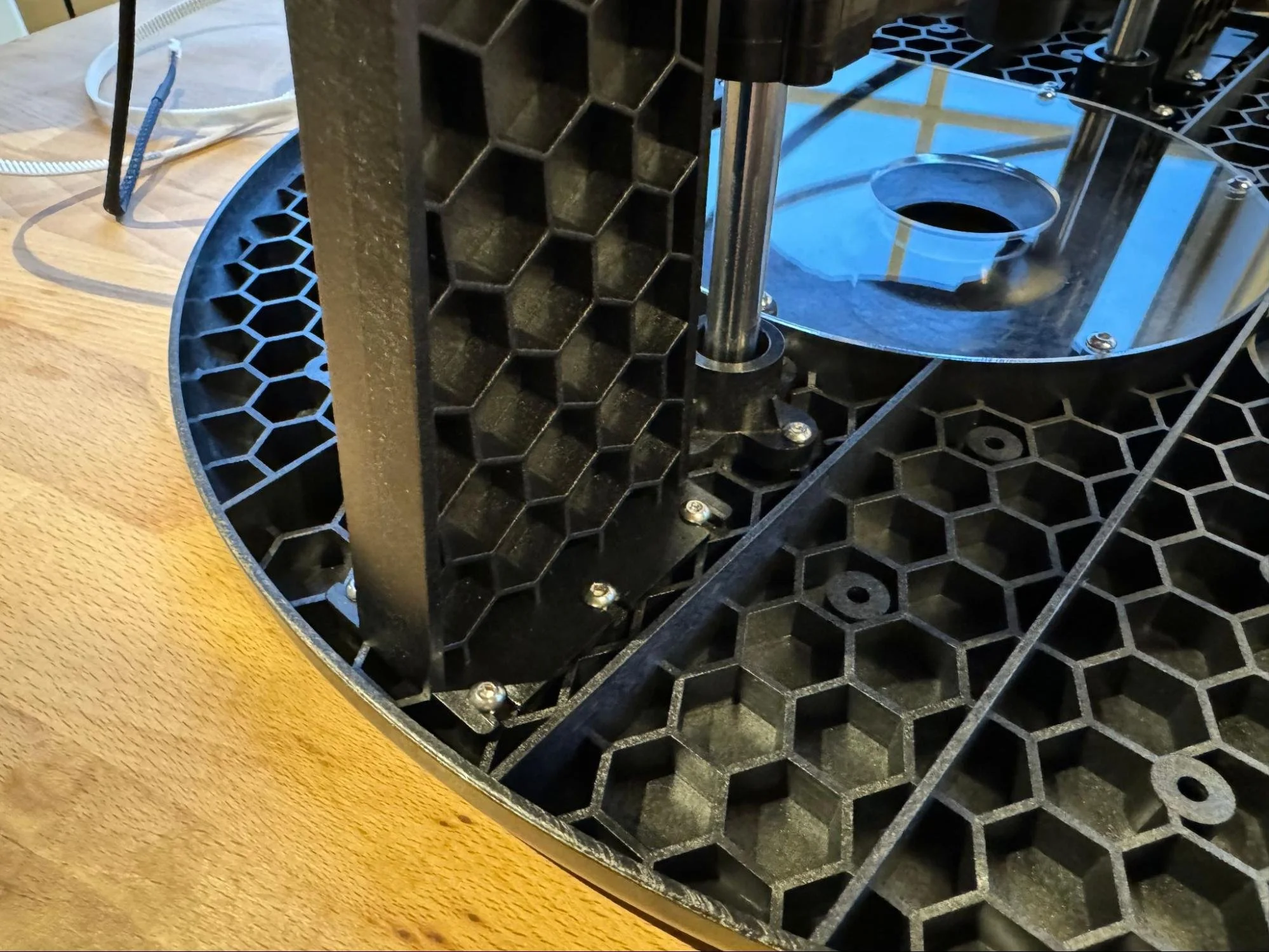

Joining the linear rod supports to the sled
Join the linear rod supports to the sled using six bolts each. There will be a small gap between the base of the upright and the sled initially, go around in a circle tightening each bolt gently to remove it.

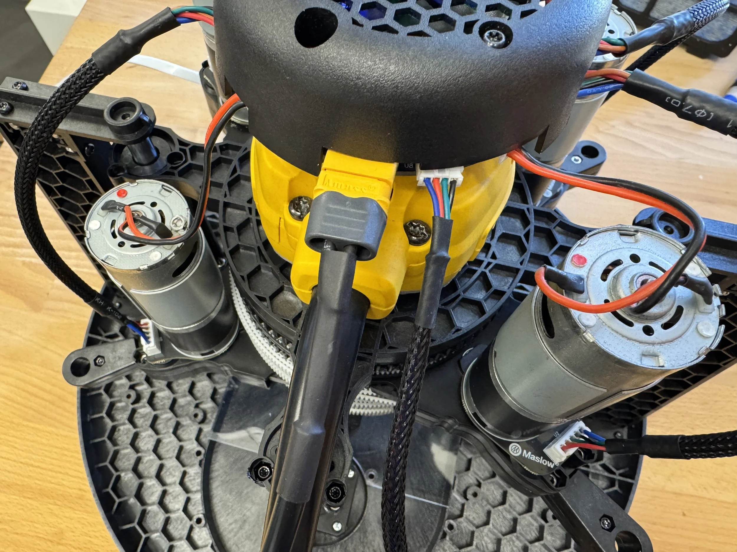

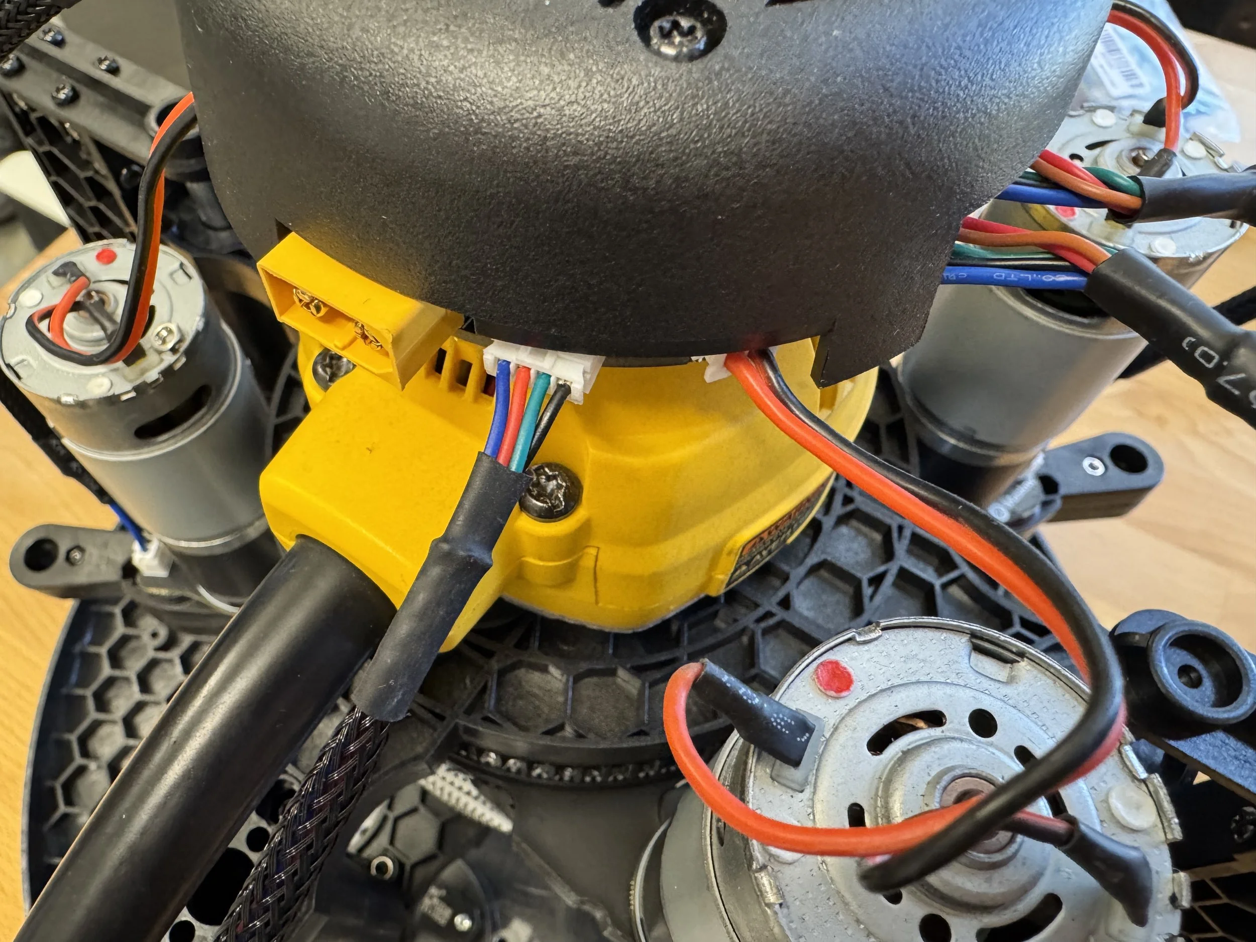

Plugging in the stepper motors
Plug the two stepper motors into the controller board.
Plugging in the power cord
Plug in the power cord.
That’s it! Your Maslow4 is complete.
Next let’s learn how to update the firmware, update the user interface, and run the calibration process in the Quick Start Guide.
Note that at the end of this step your belts will be partly extended. We will retract them using the automatic belt retraction function after we update the firmware.
