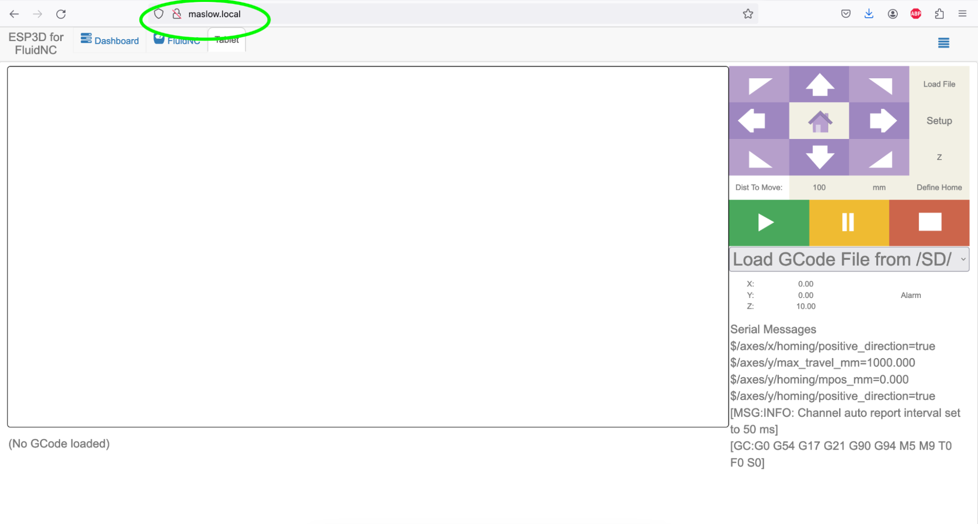

Step 3: Access the Web Interface
The interface may auto-open when you connect. If not, enter 192.168.0.1 in your browser’s address bar.
Web Interface Overview
The Maslow 4 web interface provides all the controls you need to operate your CNC machine without installing any additional software.
Main Dashboard
The main dashboard displays:
- Machine status
- Current position (X, Y, Z coordinates)
- Connection status
- Quick access to common actions

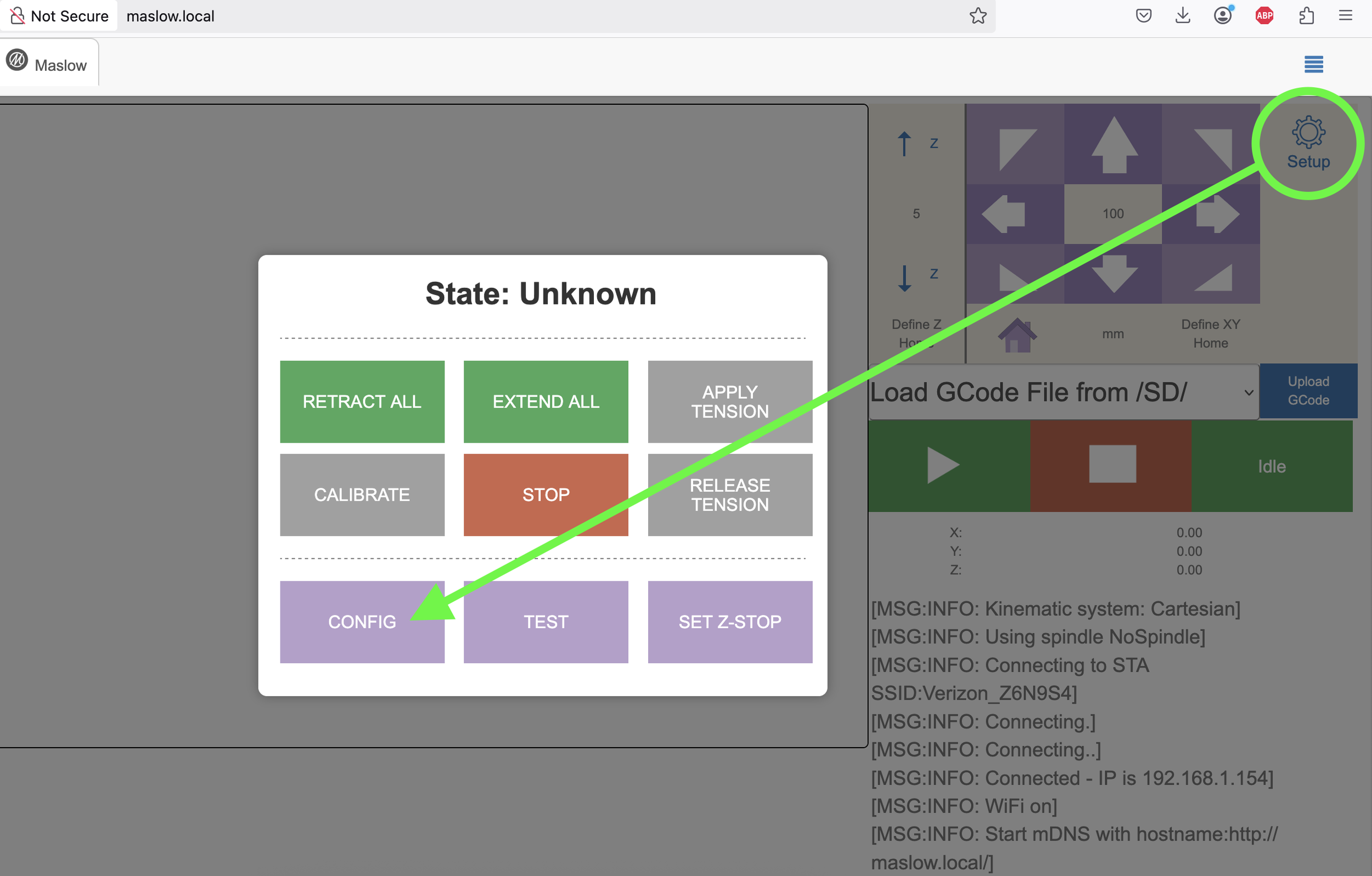

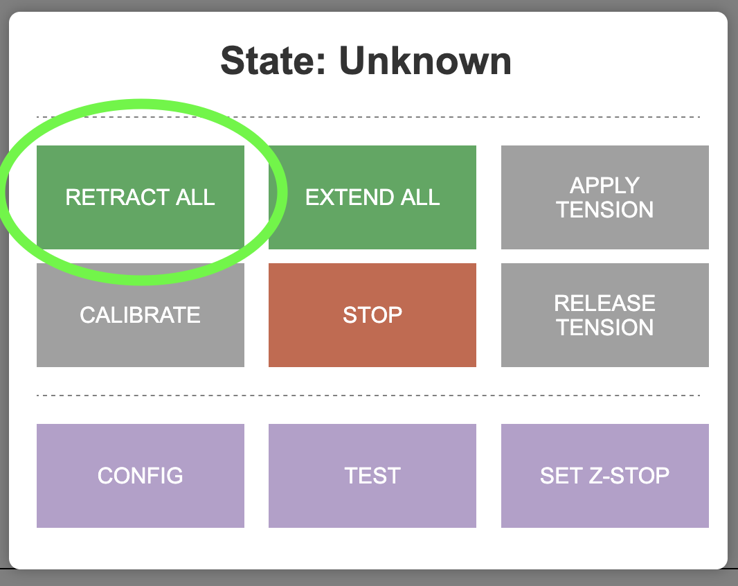

Actions Menu
The Actions menu provides access to:
- Home Position: Define and return to the home position
- Move Machine: Manual jog controls for X, Y, and Z axes
- Calibration: Run the calibration wizard
- Run G-code: Execute uploaded G-code files

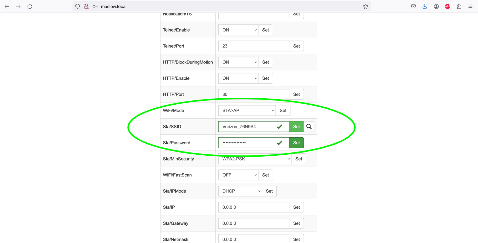

Configuring WiFi (Optional)
You can configure Maslow to join your home WiFi for networked access from any device on your network.
Steps to Connect to Home WiFi
- Access the web interface via the default
maslownetwork - Navigate to the “FluidNC” tab or “Network” settings
- Enter your home WiFi credentials
- Save and restart the machine

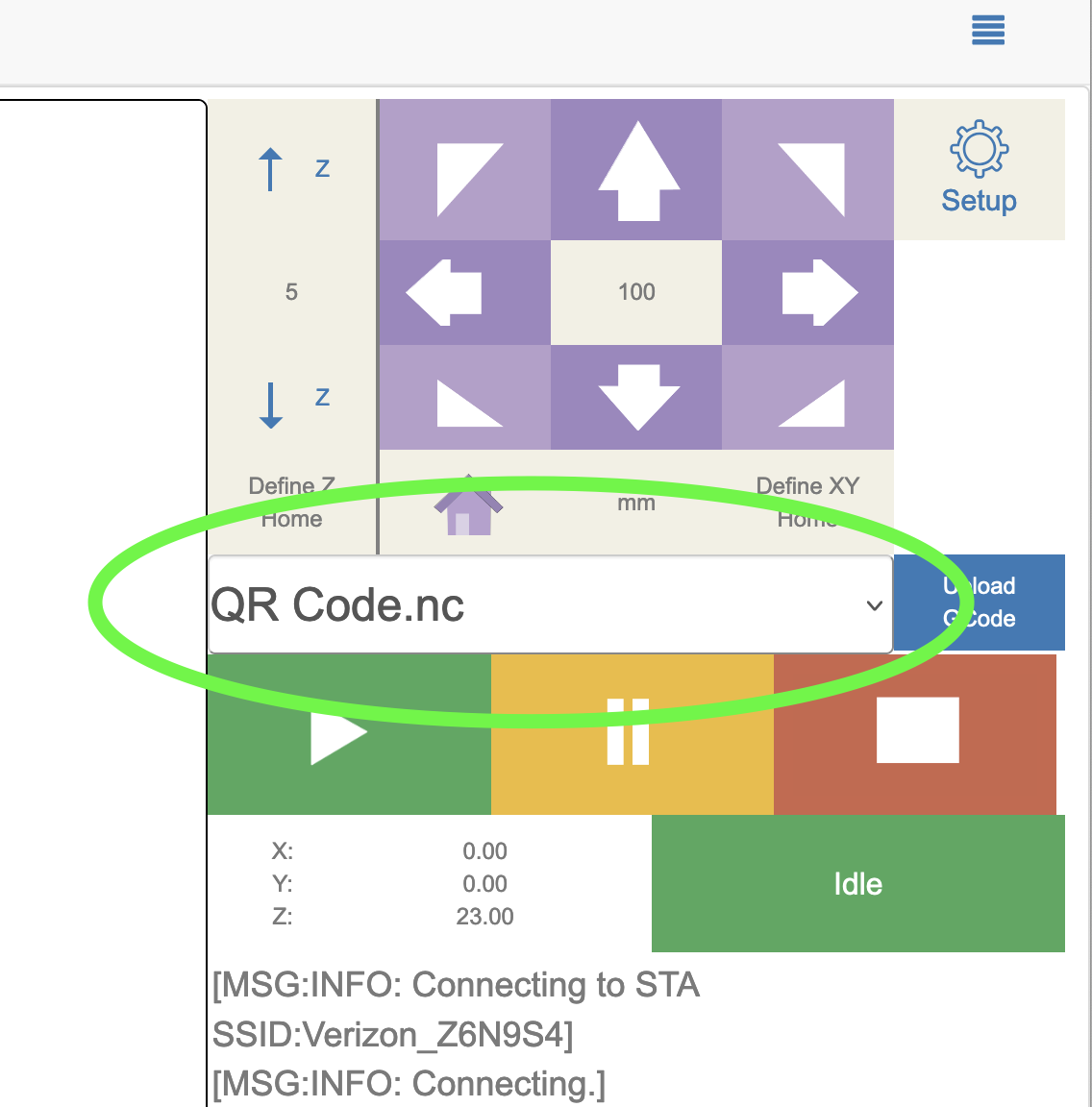

Uploading and Running G-code Files
Uploading Files
- Navigate to the “Files” or “Actions” menu
- Click “Upload files”
- Select your
.ncG-code file - Wait for the upload to complete
Running a G-code File
- Select the uploaded file from the list
- Set the start position (or pick a specific line if resuming)
- Click “Run” to start the job
- Monitor progress from the dashboard

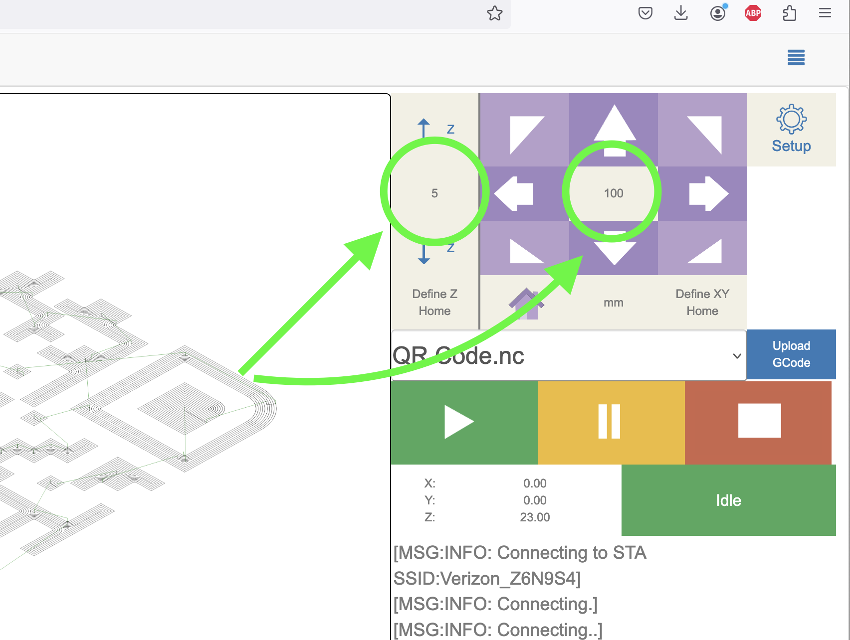

Visualizing Tool Paths
The web interface can display a visual preview of the tool path, helping you verify the job before running.

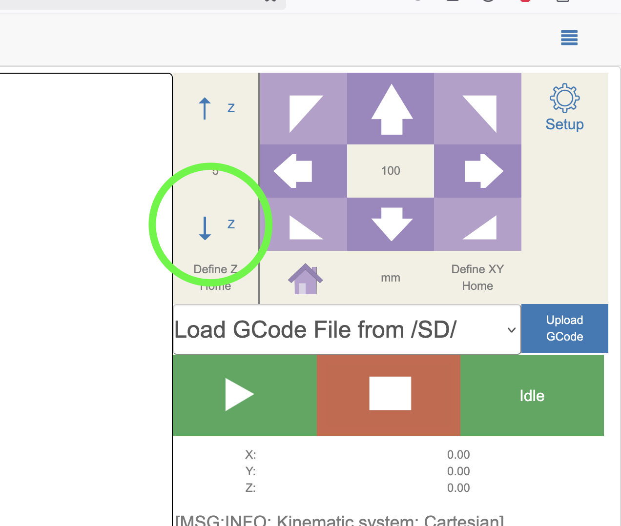

Manual Machine Controls
Jog Controls
Use the arrow buttons to manually move the machine:
- X-axis: Left and right movement
- Y-axis: Up and down movement (on vertical setup)
- Z-axis: Router depth control
Zeroing Position
Set the current position as zero for any axis:
- Move the machine to your desired zero point
- Click the “Zero” button for the appropriate axis
- Confirm the new zero position

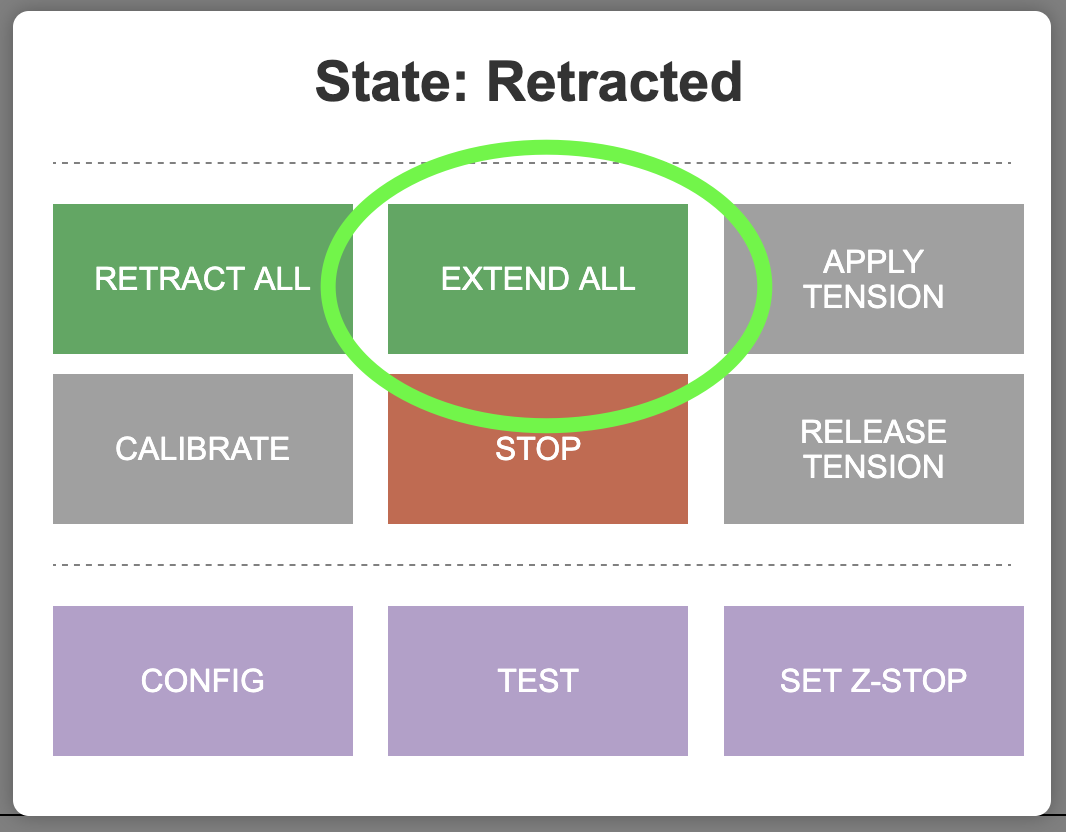

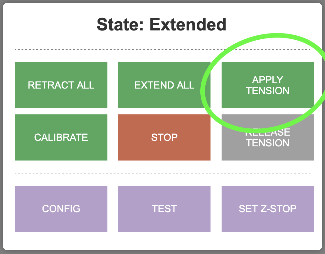

Extending and Retracting Belts
The belts can be extended or retracted using the controls in the interface.

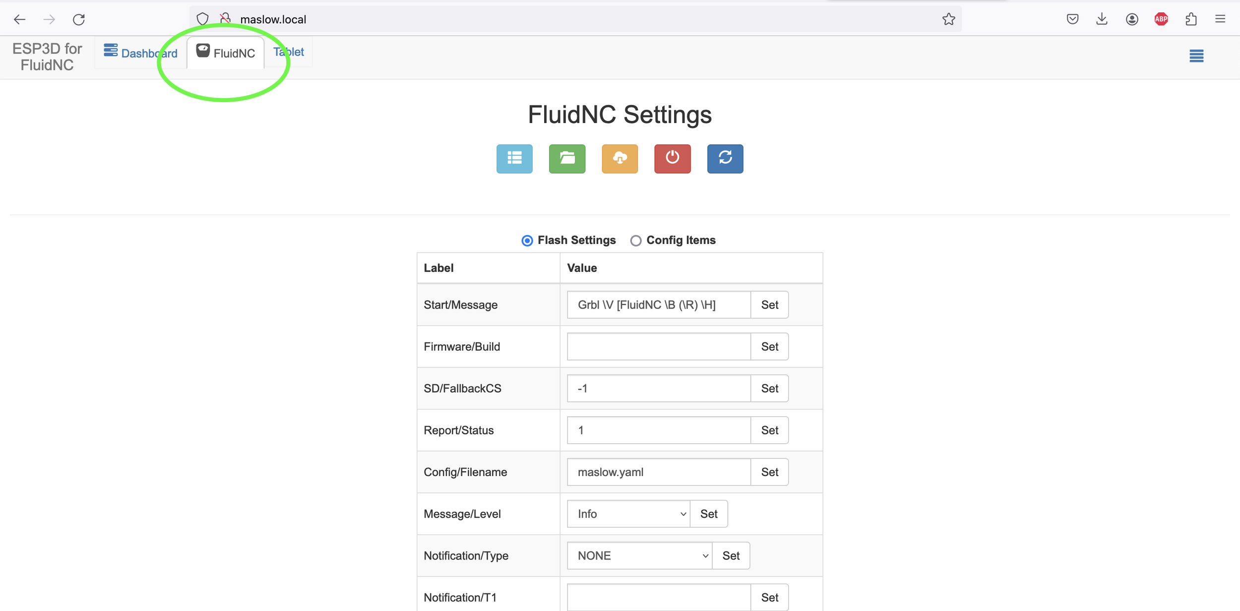

Updating Firmware
Keeping your firmware up to date ensures you have the latest features and bug fixes.
Firmware Update Process
- Download the latest firmware from GitHub Releases:
firmware.binindex.html.gzmaslow.yaml
Access the web interface and go to the “FluidNC” tab
Click “Update the Firmware” and select
firmware.bin -
Upload the other files using the file upload function
- Restart the machine
Note: If updating from a version before 1.0 to after 1.0, a USB cable is required. See the official documentation for USB update instructions.

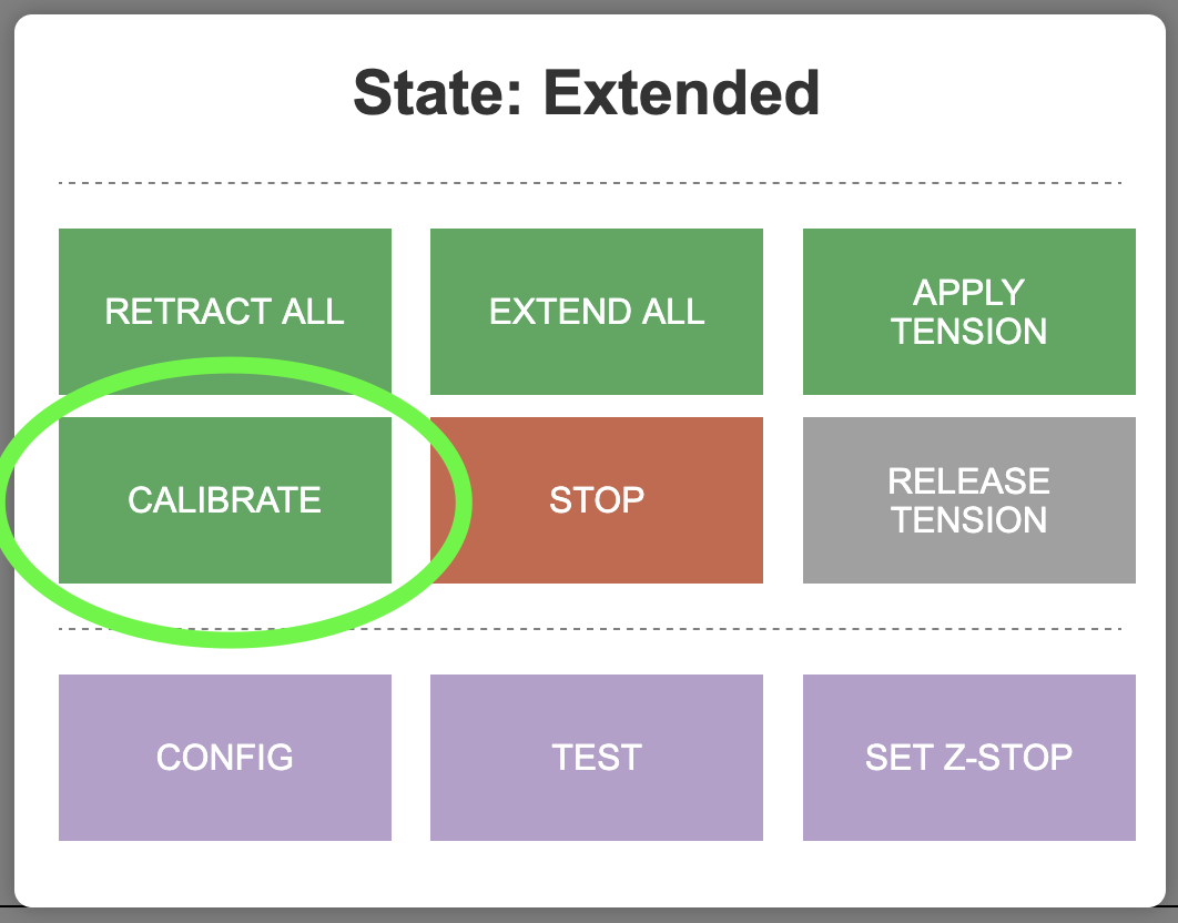

Calibration
Access the calibration wizard from the Actions menu. The wizard will guide you through:
- Belt extension and retraction
- Home position definition
- Anchor point measurement
- Calibration grid setup
- Automated calibration process
For detailed calibration instructions, see Putting It All Together.

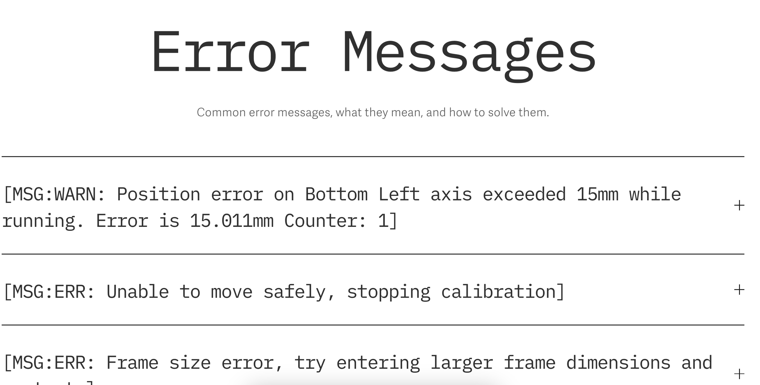

Red LED is blinking
The Red LED blinks slowly (300 ms on/off) when the machine has detected an error. Open the web interface console to read the error message. Common causes are a disconnected encoder or motor cable, a belt that has gone slack, or an emergency stop triggered during a job. After fixing the underlying problem, press Clear in the web interface (or send $X) to turn the LED off and re-enable motion.
If both the Red and WiFi LEDs flash together in a rapid double-blink, the motion-control watchdog fired. Press Clear (or send $X) to clear it. If it keeps happening, power-cycle the machine and check for large uploads or heavy WiFi traffic while the machine is running.
