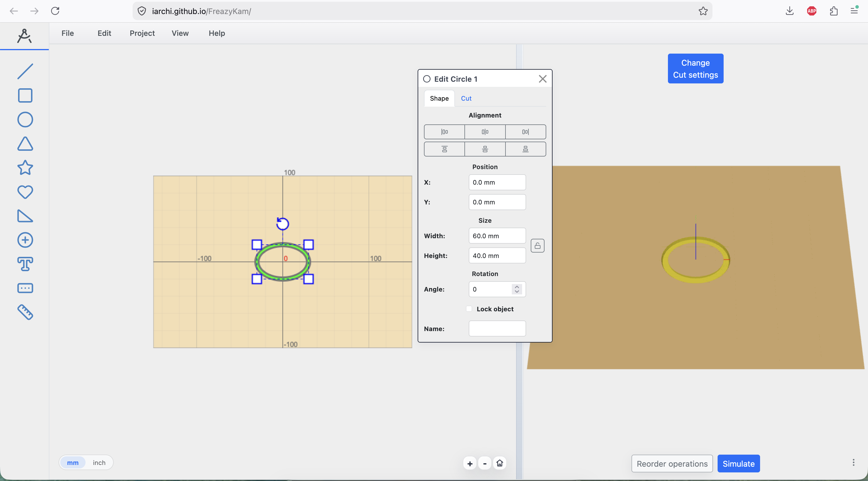

FreazyKam
FreazyKam is an excellent free online CAM option which can import .svg files or .dxf files and show how they will cut. It was developed in the maslow forums by the community so it is well supported if you encounter any issues.

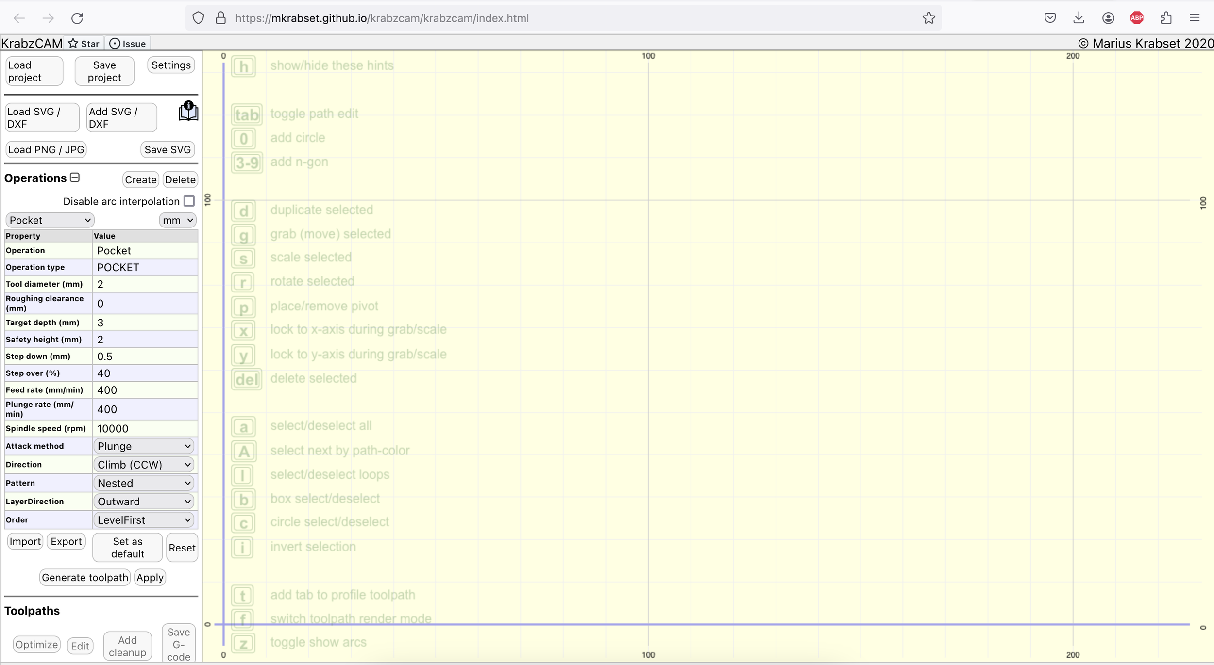

CrabzCAM
CrabzCAM is a free online (link) tool for generating Gcode from .svg files. It is actively maintained and works well, however the number of options and settings can be overwhelming.

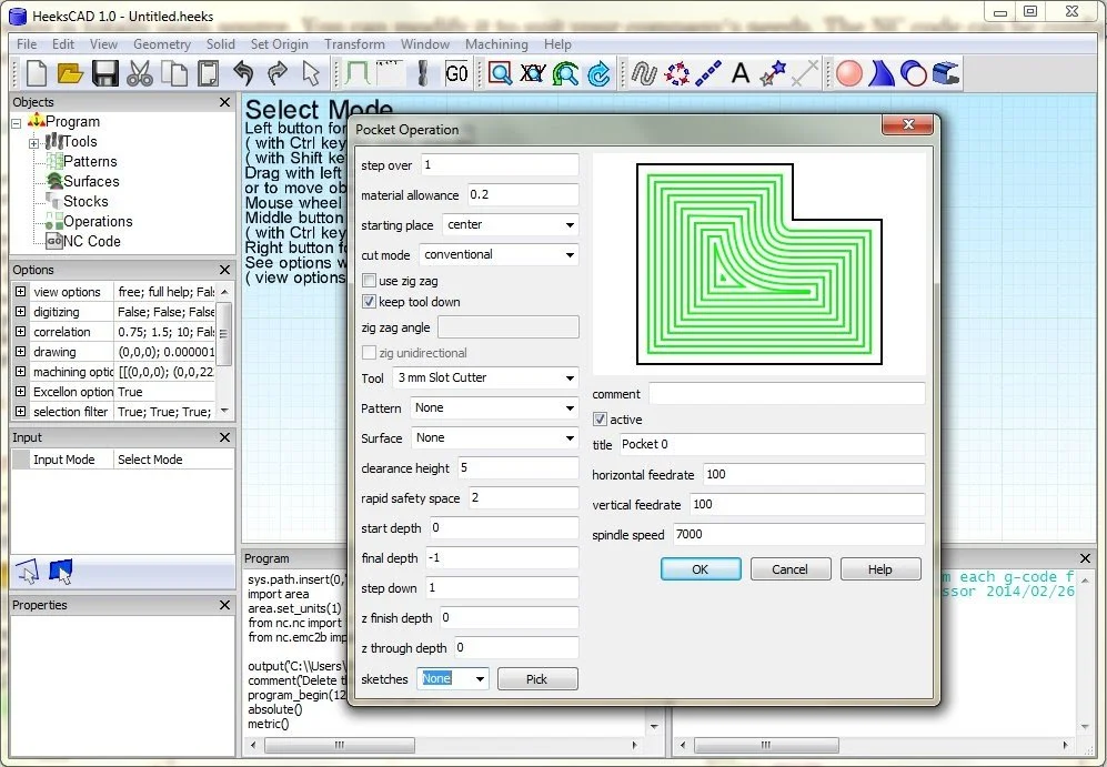

HeeksCNC
HeeksCNC is paid ($10 to own) CAM software which handles a large number of file types and can do 2D and 3D work. Windows only.

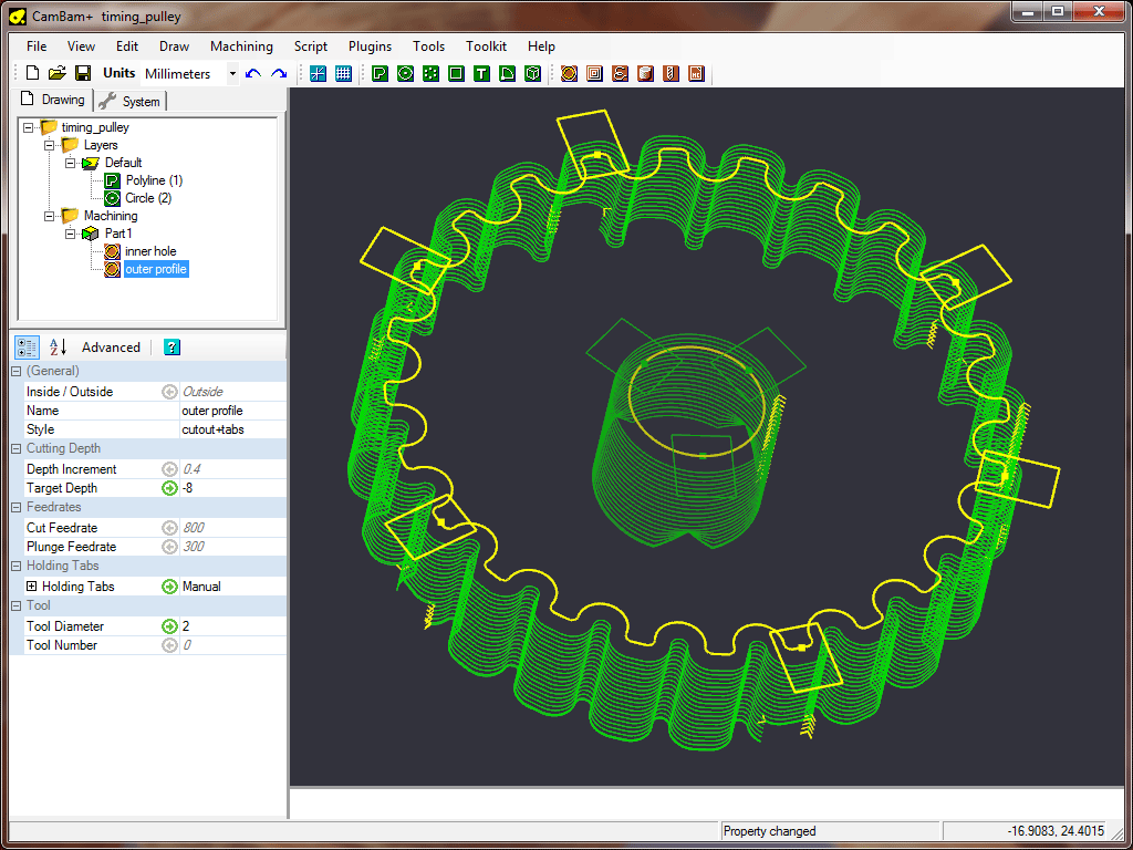

CamBam
CamBam is a paid ($150 to own) CAM software. It does 2D and 3D work and can handle .dxf files.

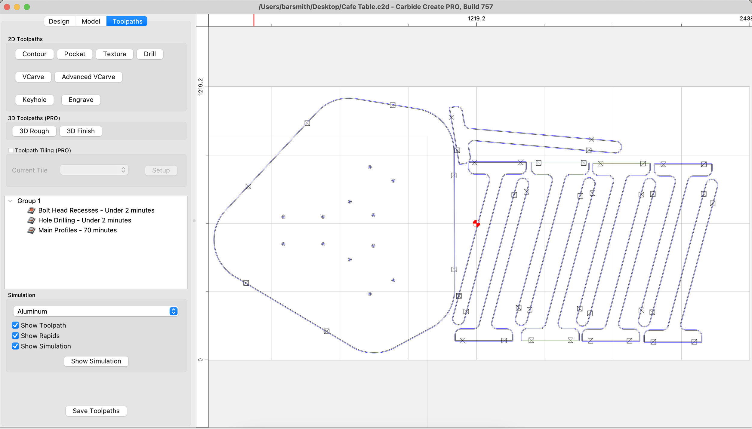

CarbideCreate
CarbideCreate is paid ($120/year) CAM software which works well for 2D and basic 3D work. CarbideCreate is one of the only options which works on Mac.

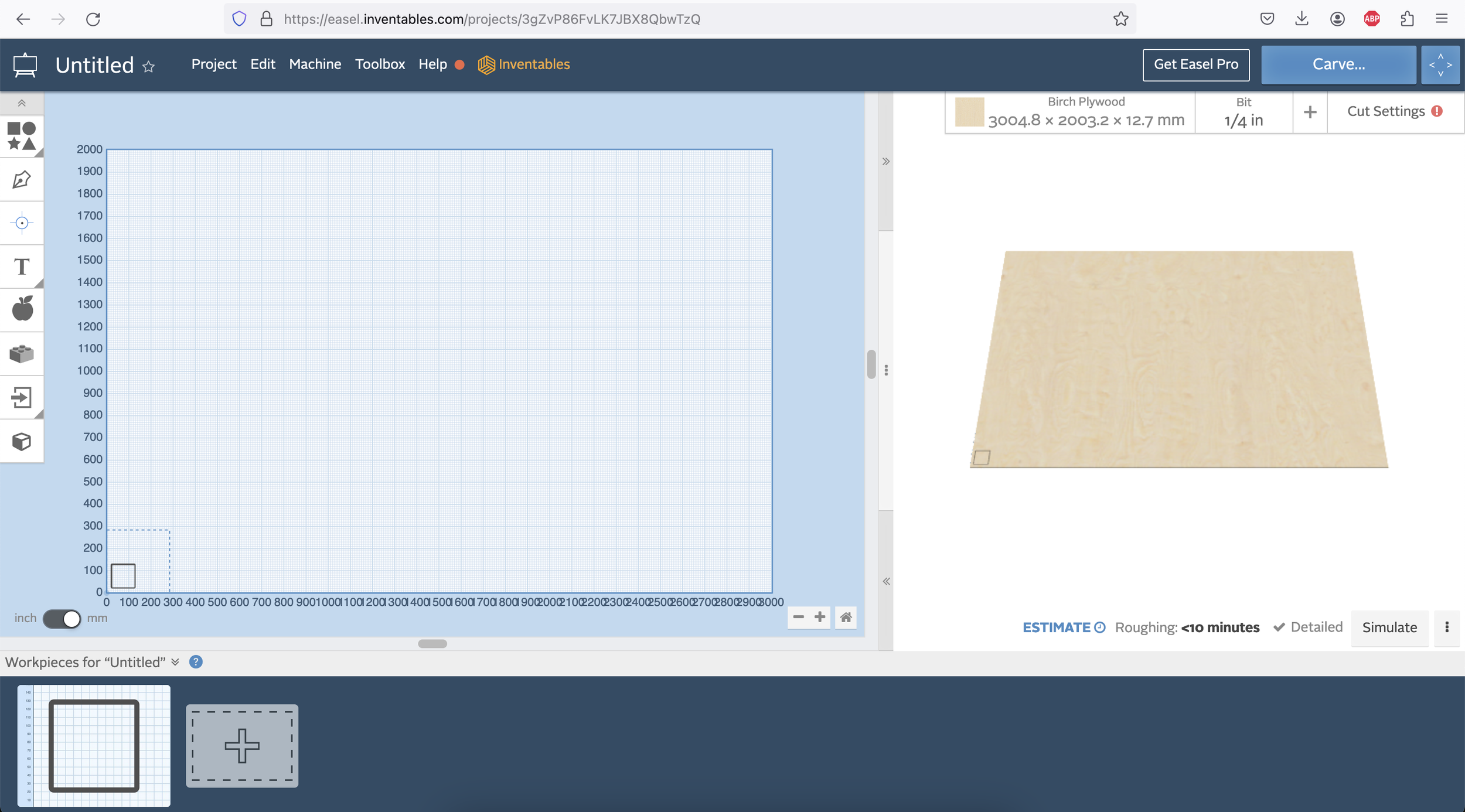

Easel
Easel is a paid ($233/year) CAM software. People like it for it’s easy to use interface.

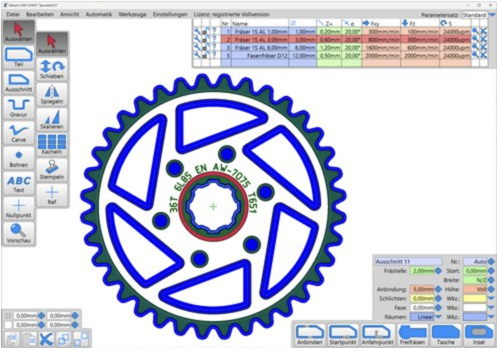

Estlcam
Estlcam is a paid ($59 to own) CAM software. The interface looks a bit more well thought out than others and the creator is active in our forums if you have any questions.

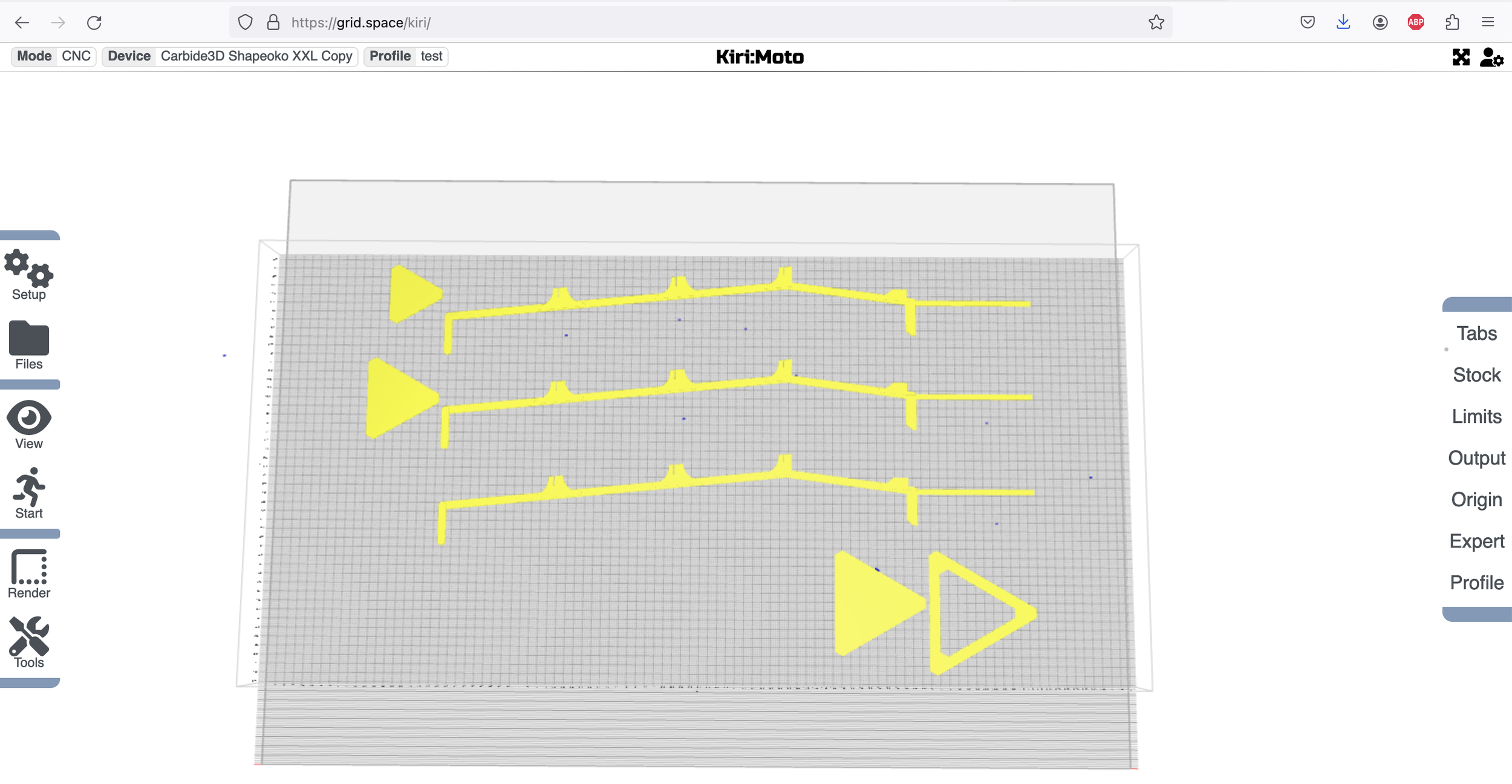

Kiri:Moto
Kiri:Moto is a free online CAM program with an unconventional interface.

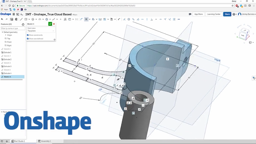

OnShape
OnShape is a free CAD software as long as you are fine with your 3D models being public. The interface is similar to SolidWorks
