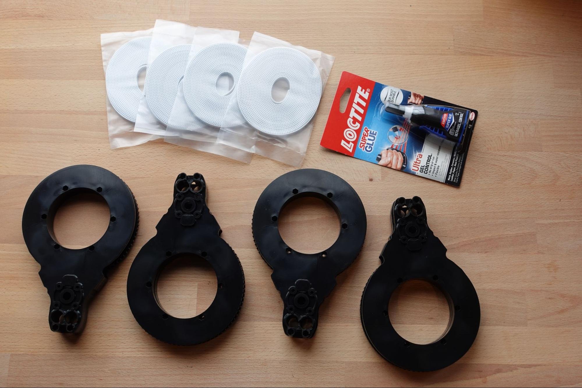

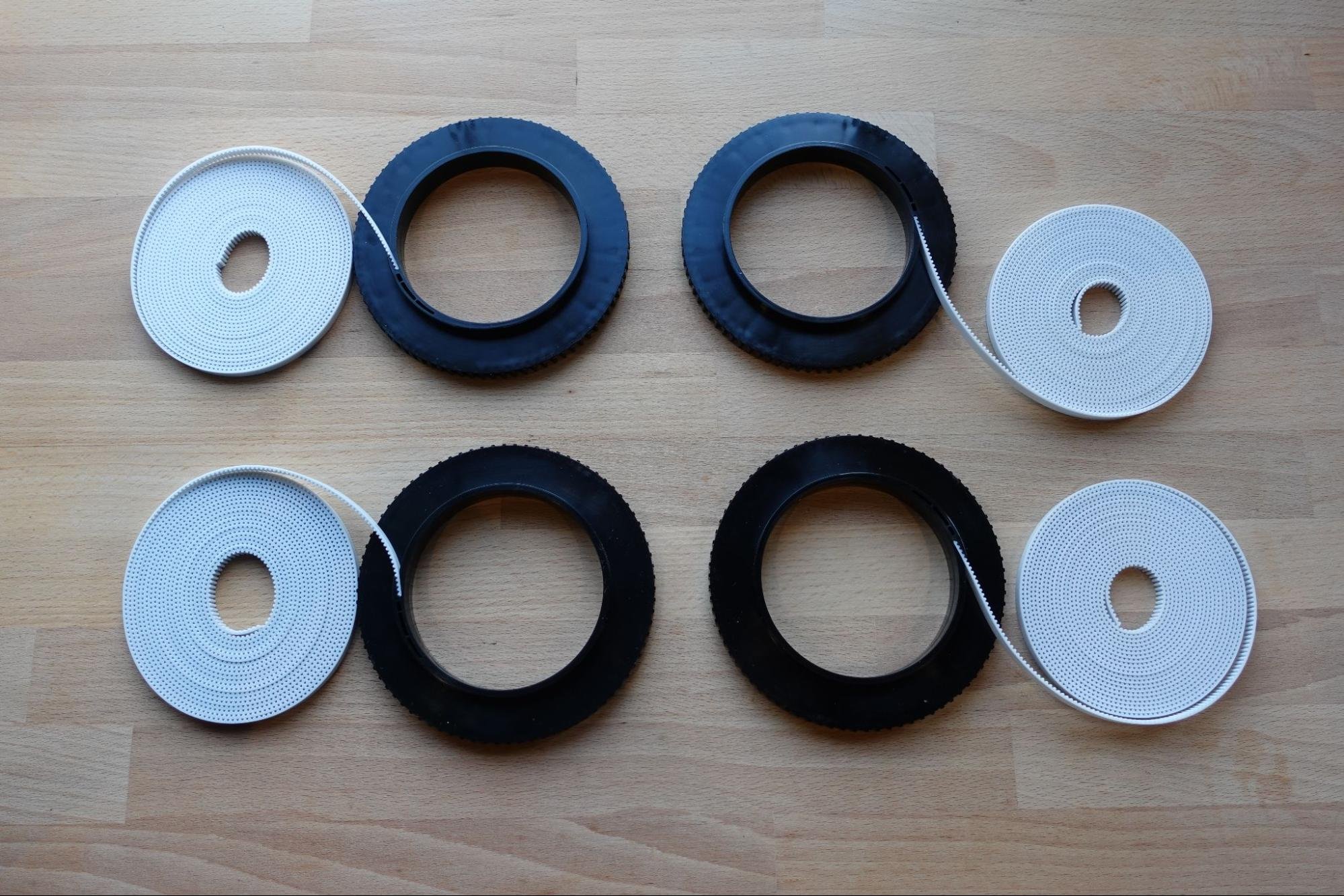

Gathering the belts, arms, and super glue
First we will gather the four belts, the four arms, and the super glue which we will need for this step. The top and bottom halves of the arms are identical.
Note: Due to issues shipping glue (a liquid) by air we have started gluing the glued parts at the factory. If your kit has these parts already glued you can skip ahead.

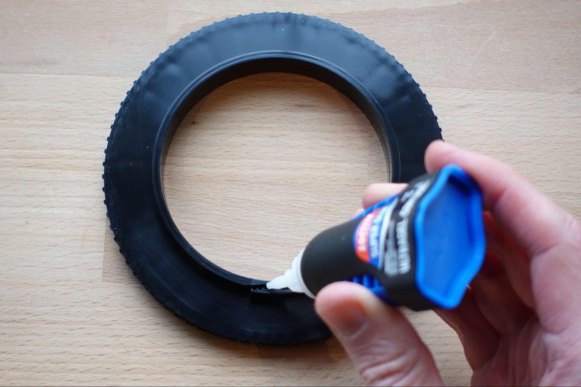

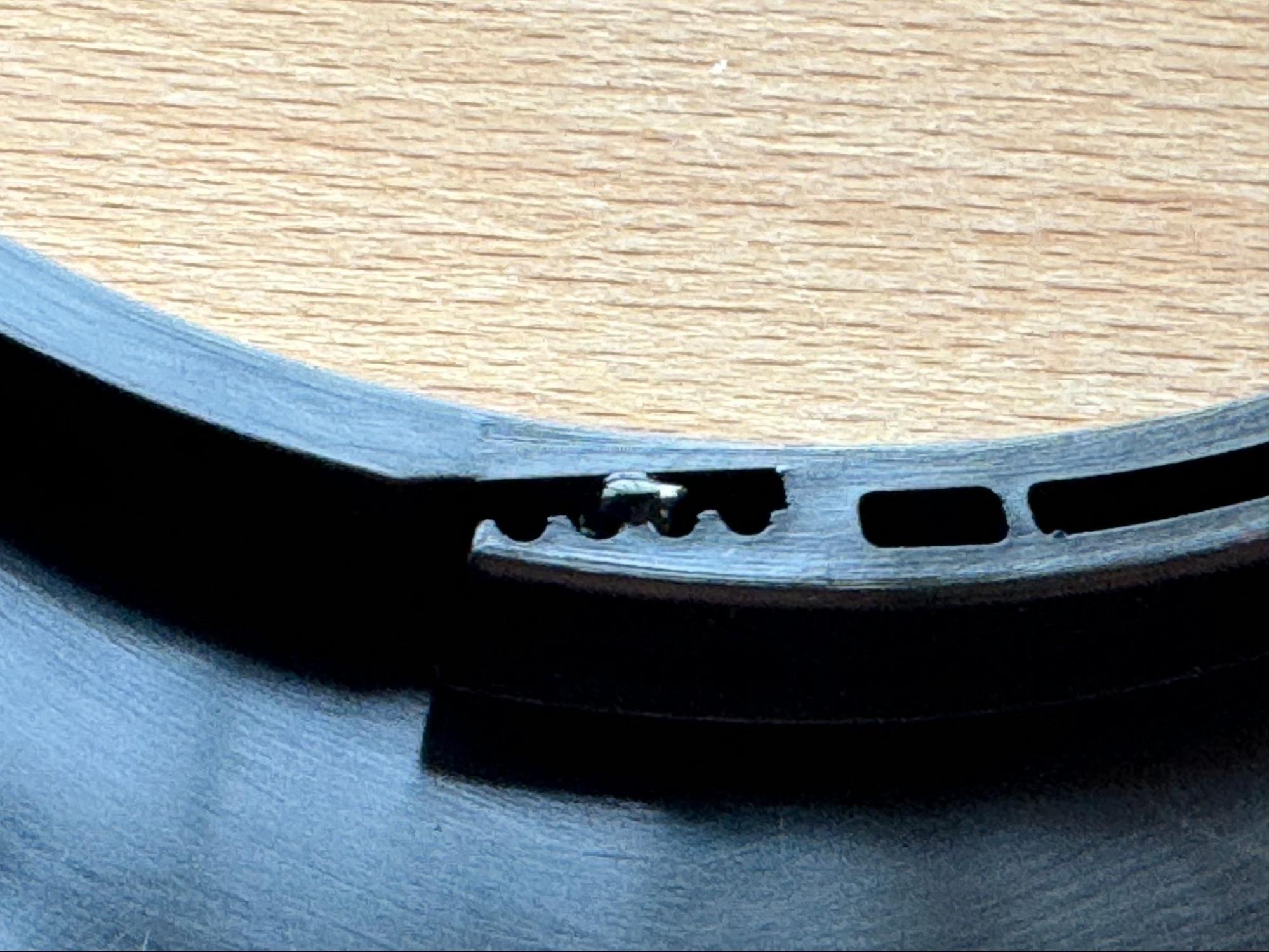

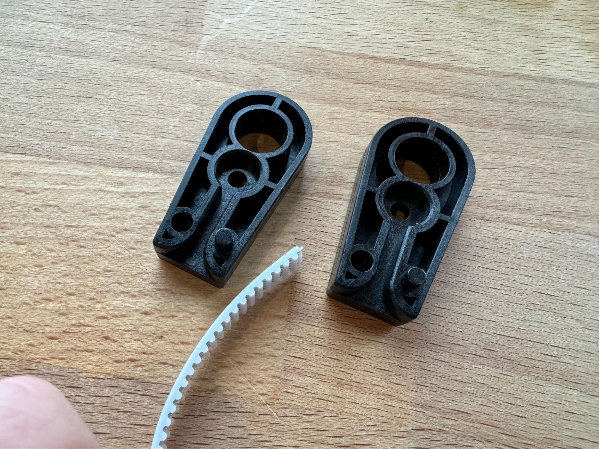

Placing a drop of super glue in the spool slot
Removing the spool from each arm, place a small drop of super glue in the slot where the belt will attach like this. A couple notes on this section. The super glue is opened by twisting the top. One end of each belt might fit into the spool more easily than the other so it’s worth checking both ends before starting with the glue.
A small drop of glue is enough
You do not need to use much glue. A very small drop is fine.

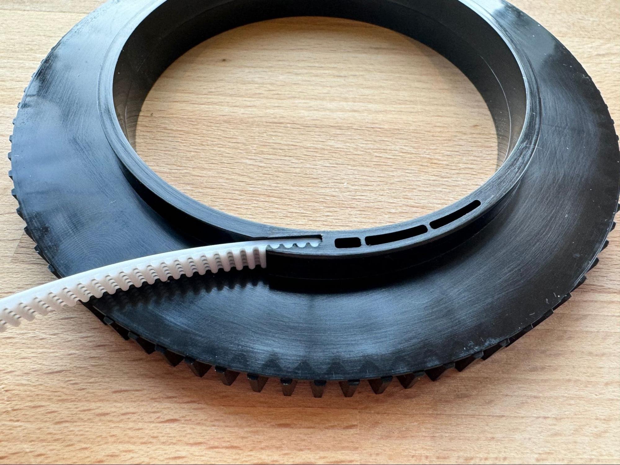

Pressing the belt fully into the slot
Then press the belt fully into the slot. It should not stick above the top of the slot.
Repeat for all four spools
Repeat this step for all four spools.

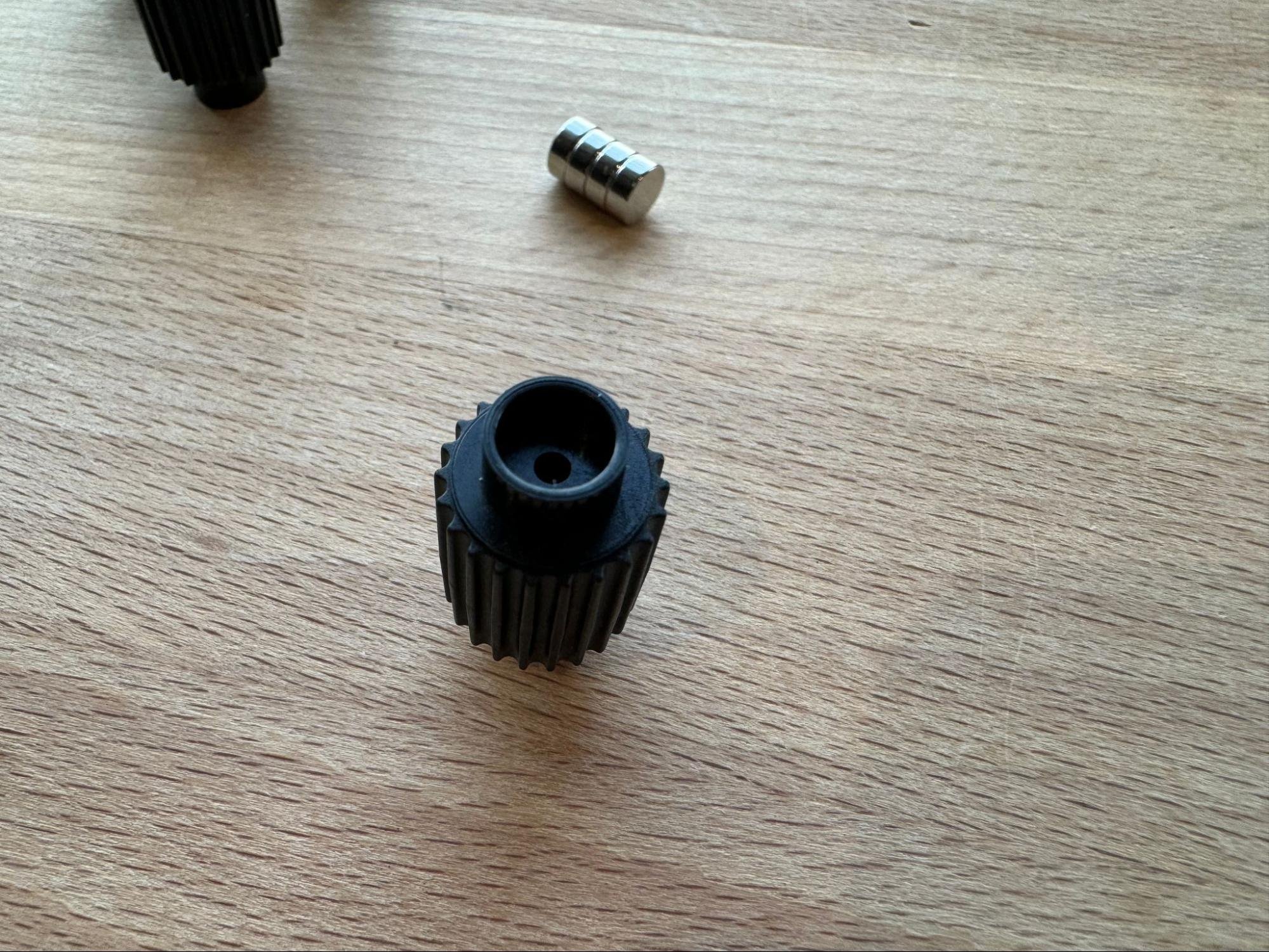

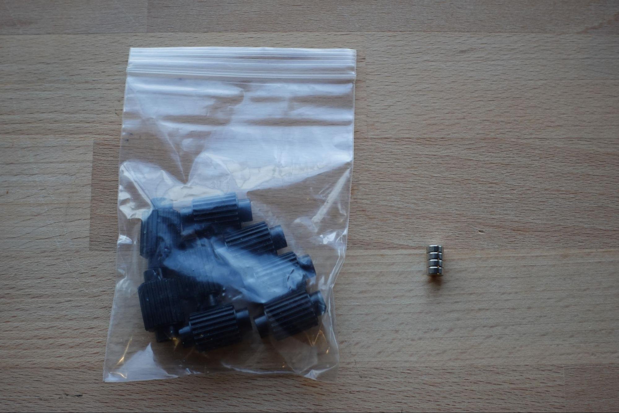

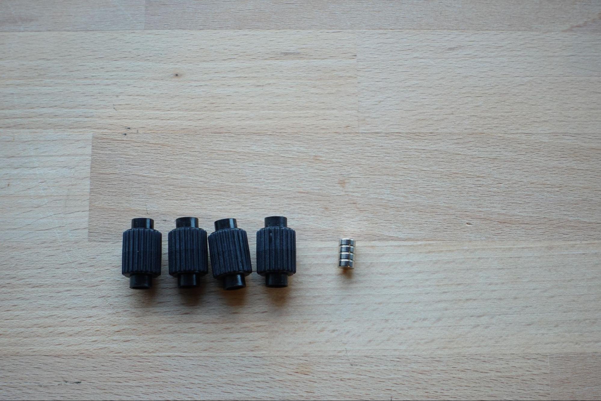

Gathering the rollers and magnets
Next we will glue the encoder magnets into the rollers. For this step we will need to gather the eight rollers and the four magnets. The four magnets will be stuck to the gears or to the Torx screwdriver.
We only need four rollers for this step
We will just need four of them for this step:

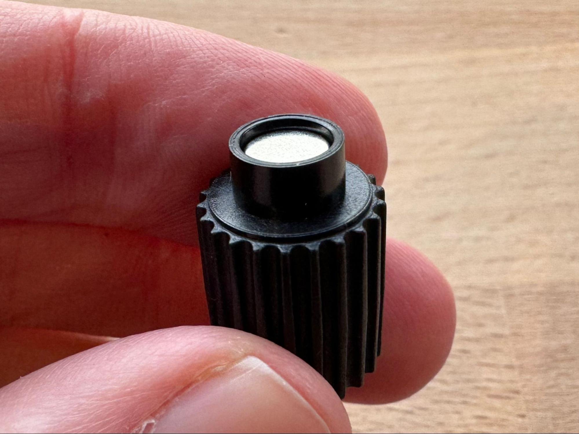

The roller end with the shallow recess
Note that each roller has two ends. One end has a shallow recess to hold the magnet. That is the side we want to use.
Gluing a magnet into each roller
Again using a drop of glue place a magnet in the end of each of the four rollers. Note that the magnet will be slightly recessed below the top of the roller.
Be careful, the magnets will try to stick to things while the glue is drying.
The magnet is symmetrical so it can be placed in either orientation.

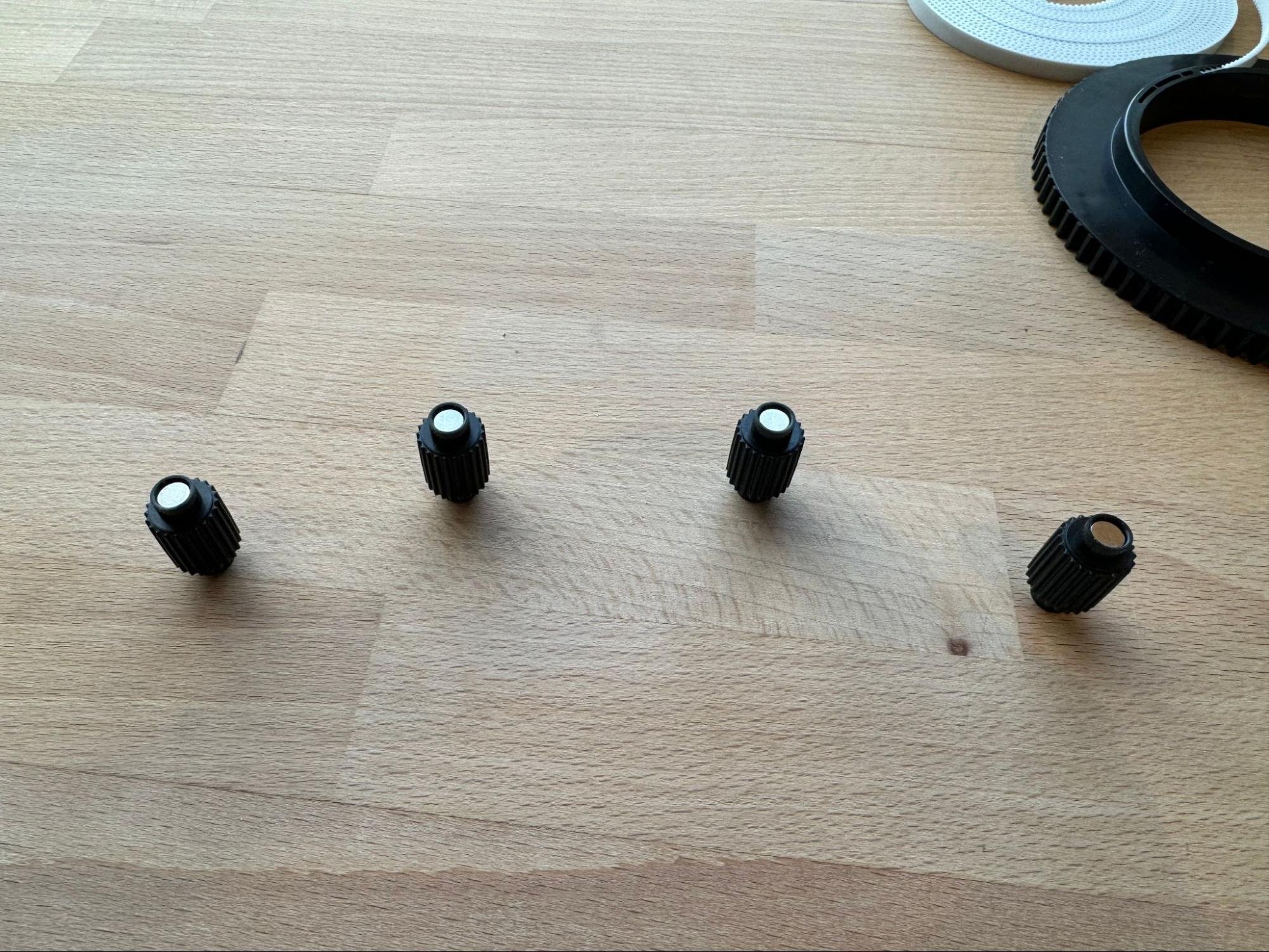

Setting the rollers aside to dry
Now set those aside to dry. Be careful not to put them too close together while drying because the magnets will attract and stick together. You have to place them further apart than you might expect.

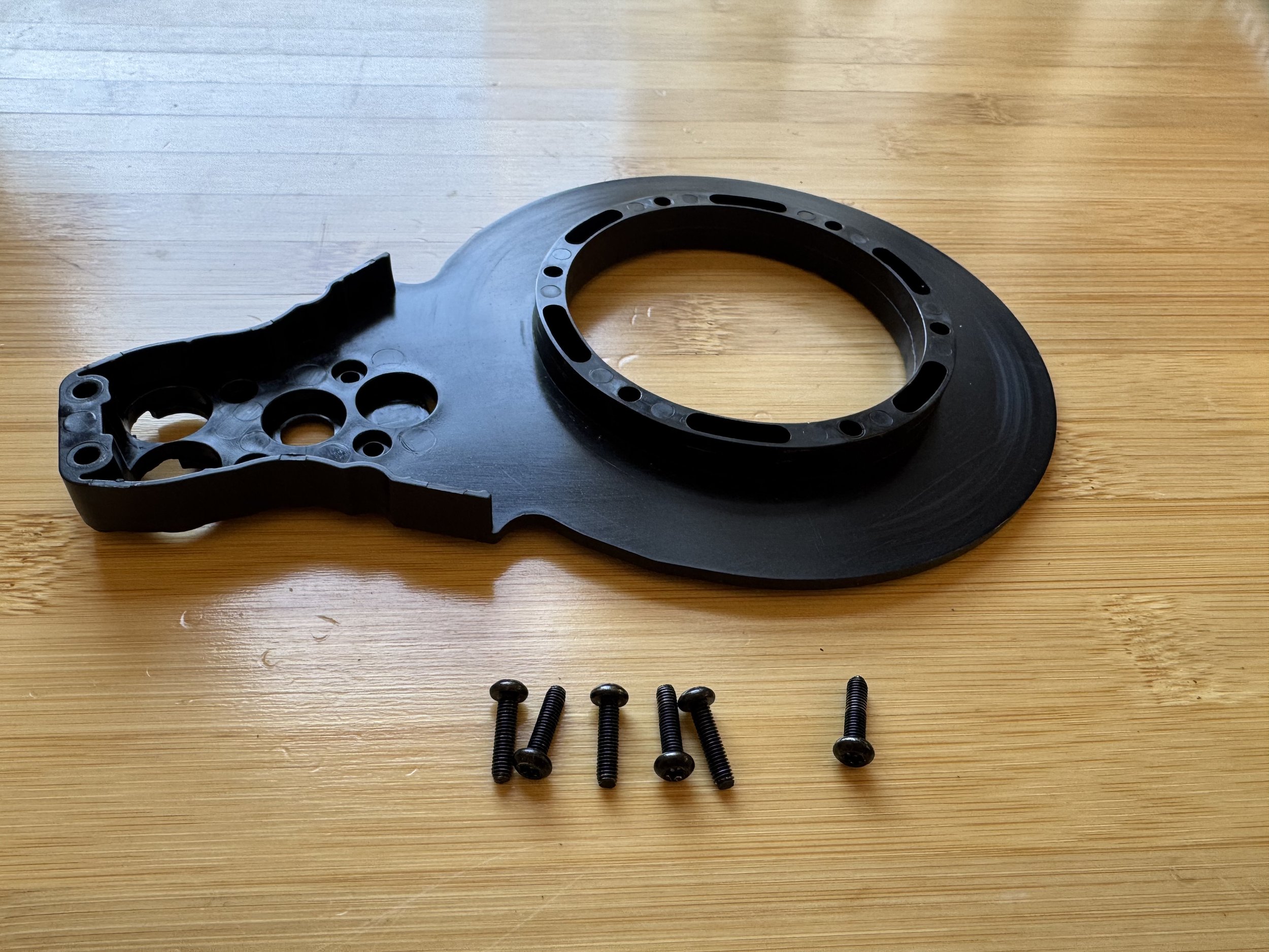

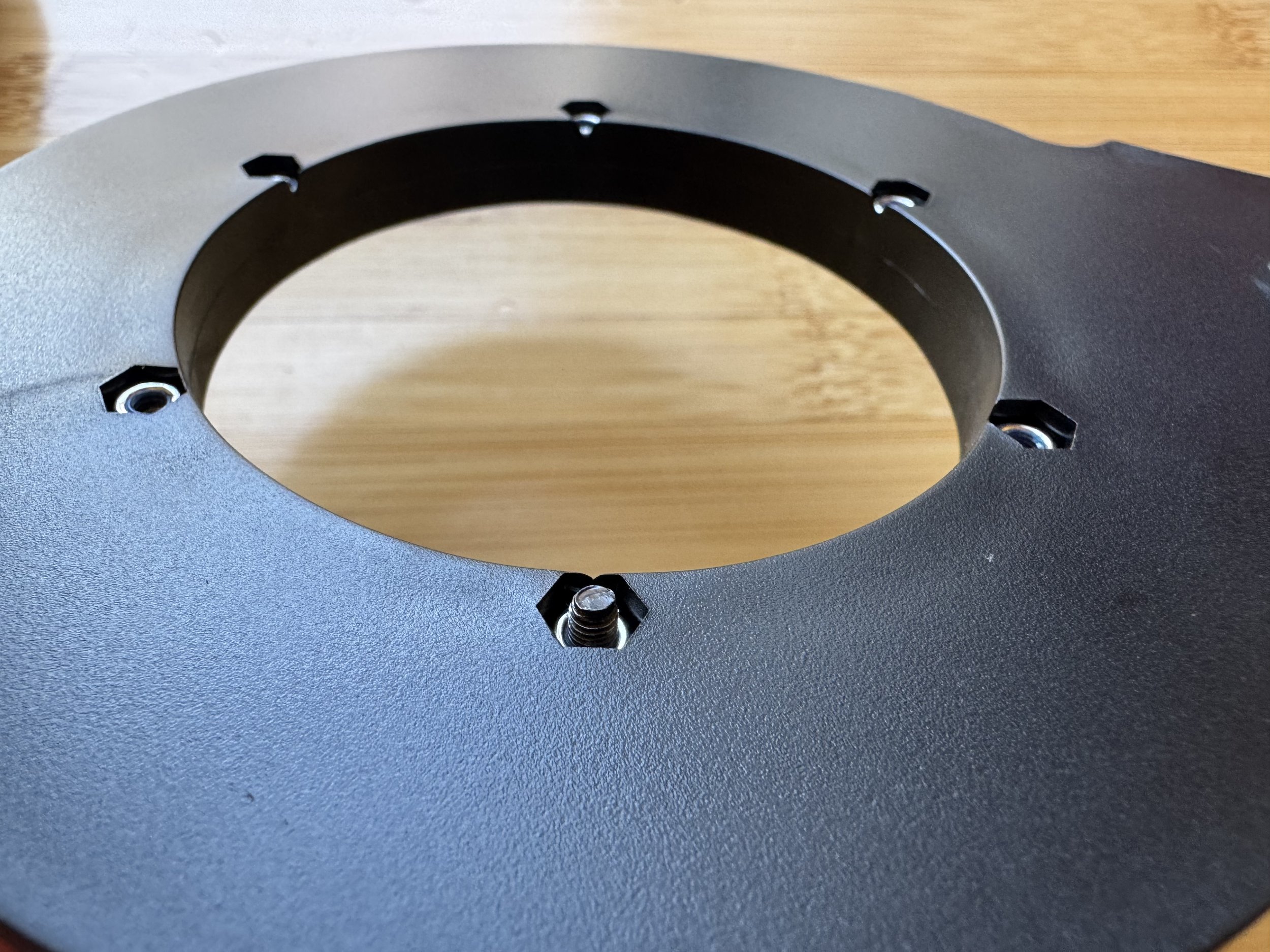

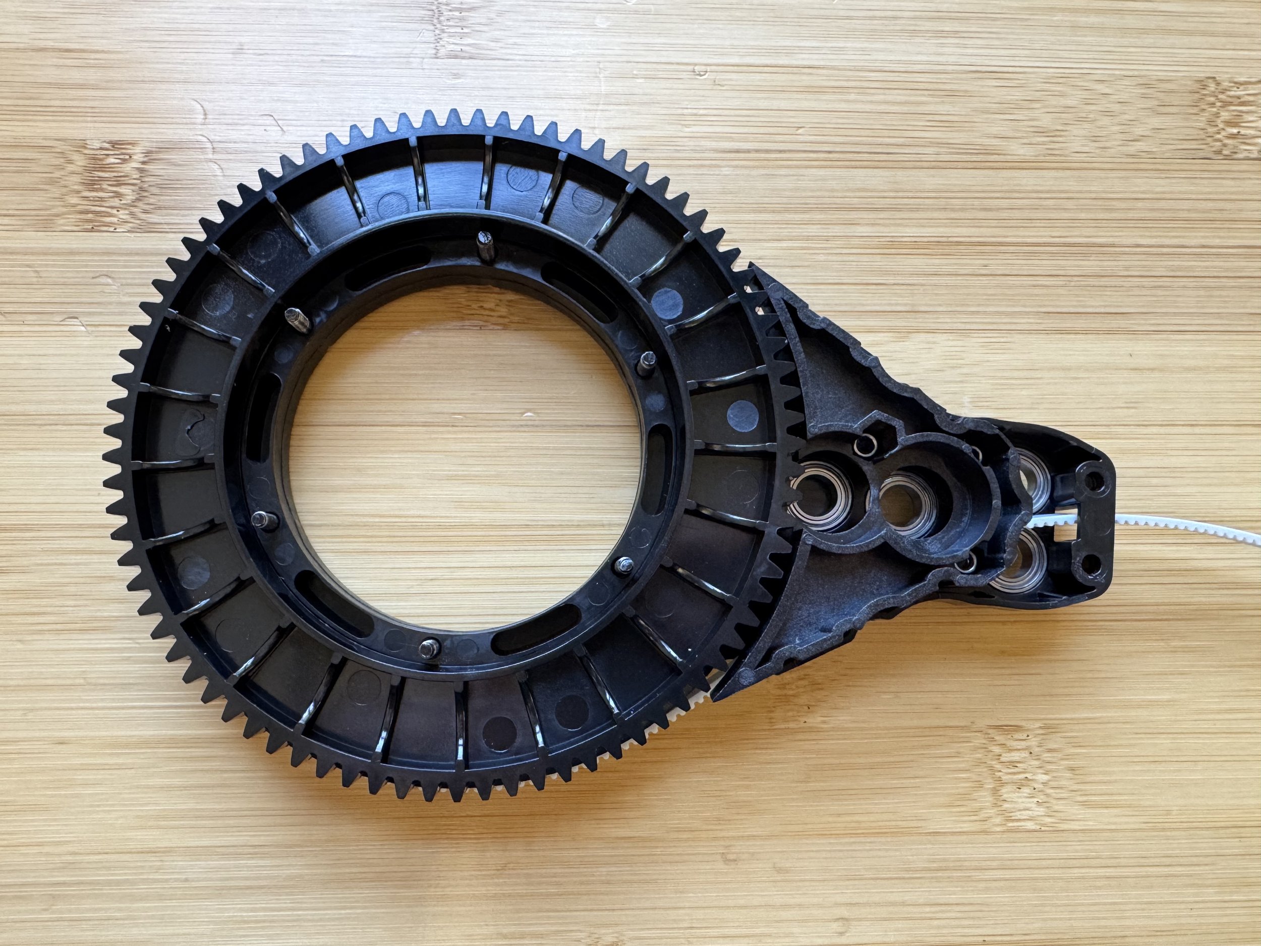

Installing six bolts into one arm half
Next, we want to install six bolts into one arm half. Be sure to use the bolts without the blue thread locker applied for this step.
Using a non-lock nut to pull the bolts into place
The bolts will fit into the arm half like this. Use a non-lock nut to help pull them into place.
Remove the nut once each bolt is in place.
A small socket or nut driver can help here to prevent the nut from spinning.

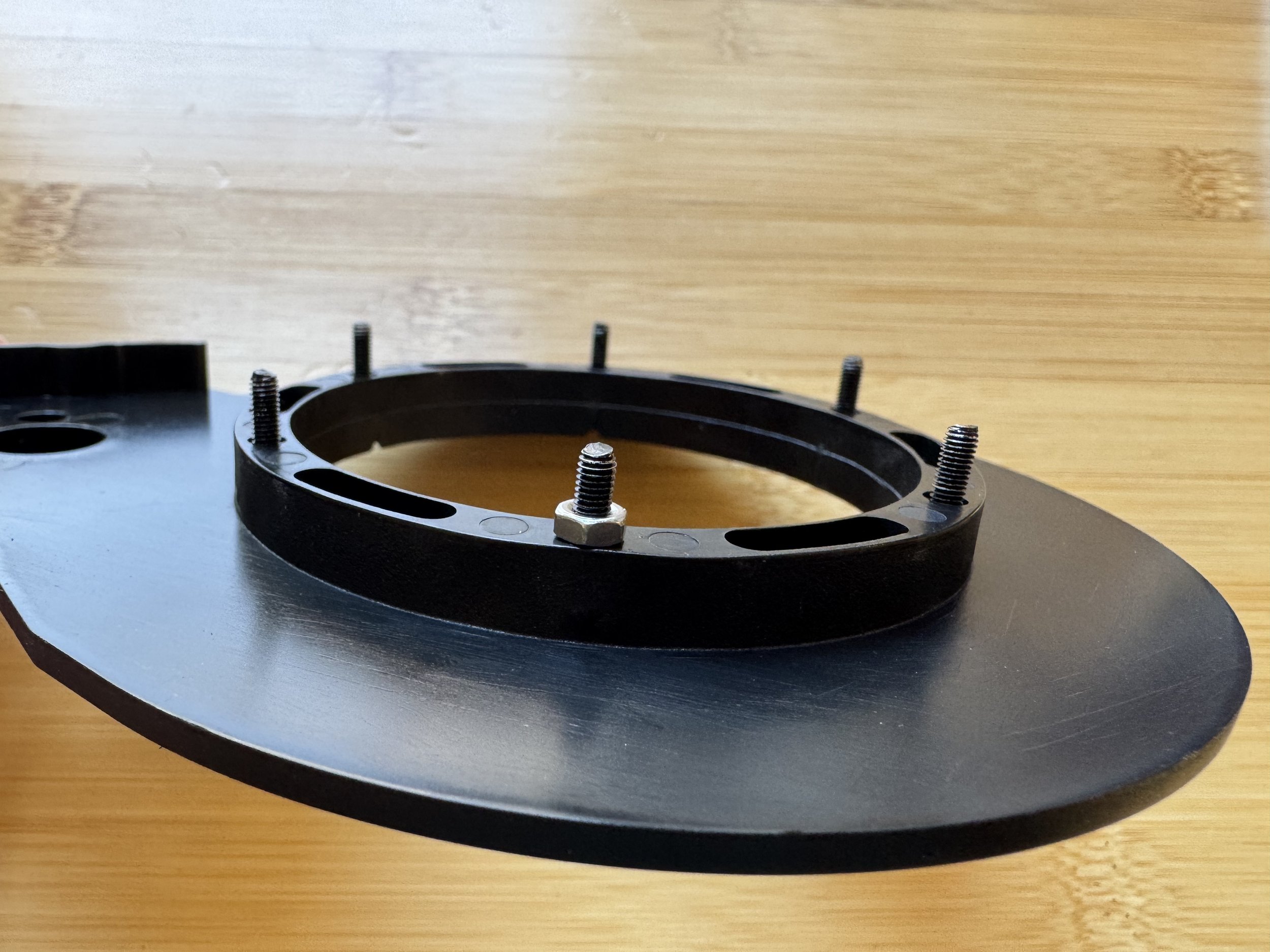

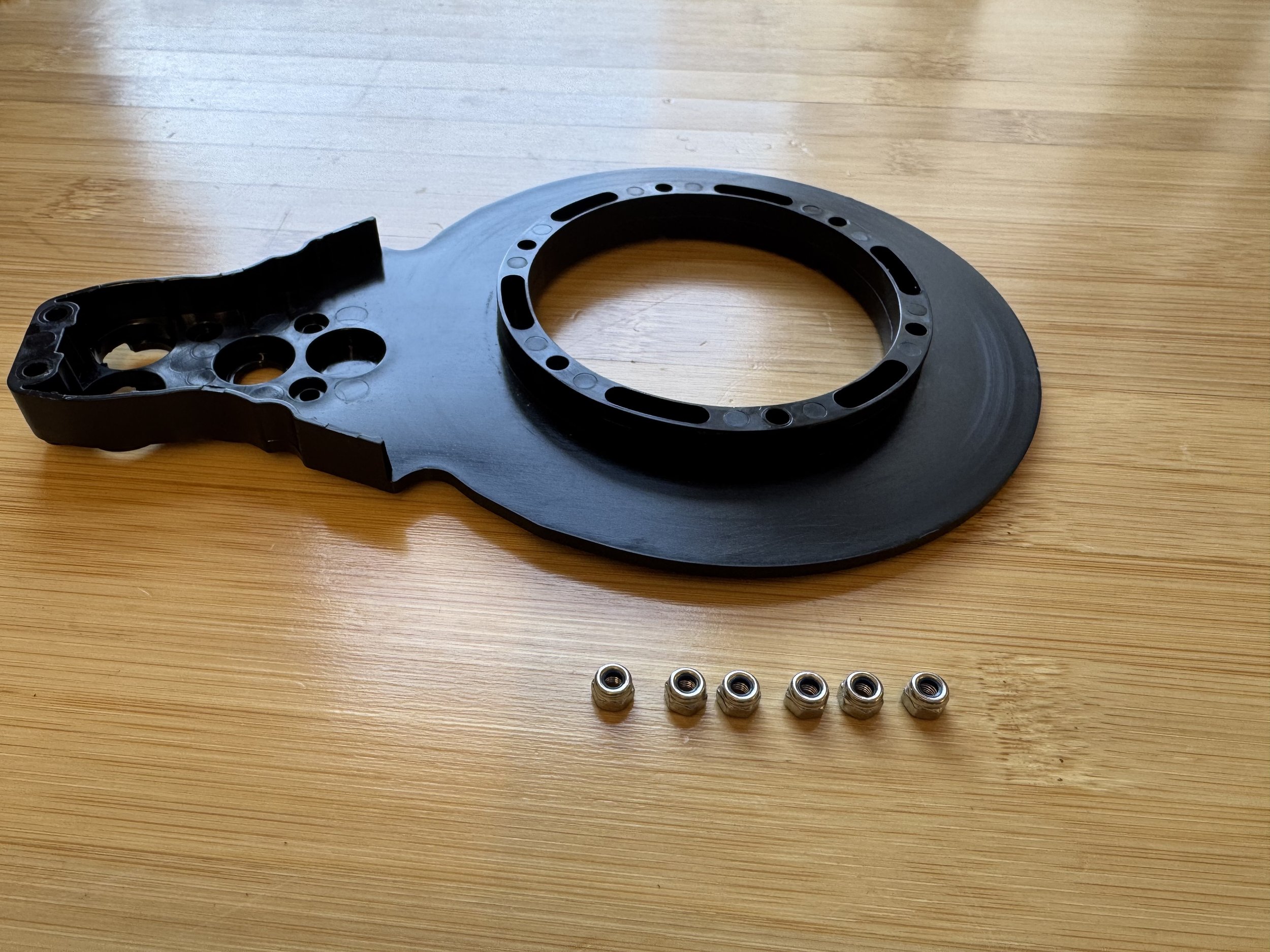

Installing six locking nuts in a new arm half
Next, install six locking nuts in a new arm half.
Pulling the nuts into place with a bolt
The process to install the nuts is the reverse of the bolts. Place a nut in each opening and then use a bolt from the other side to pull the nut into place.
Remove the bolt once each nut is in place.

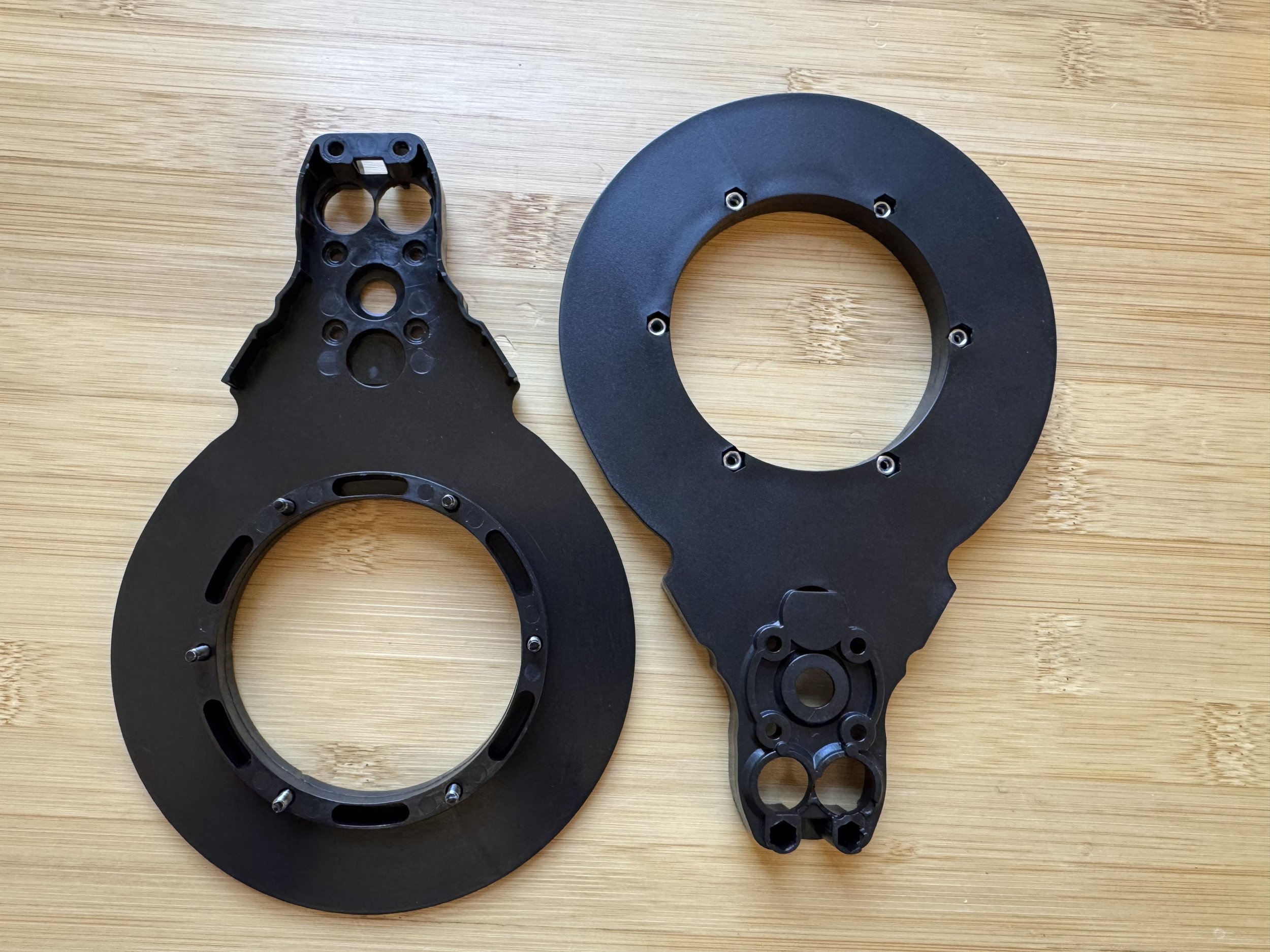

One half has only nuts, the other only bolts
When we are done with both halves one half should have only nuts and the other half should have only bolts.

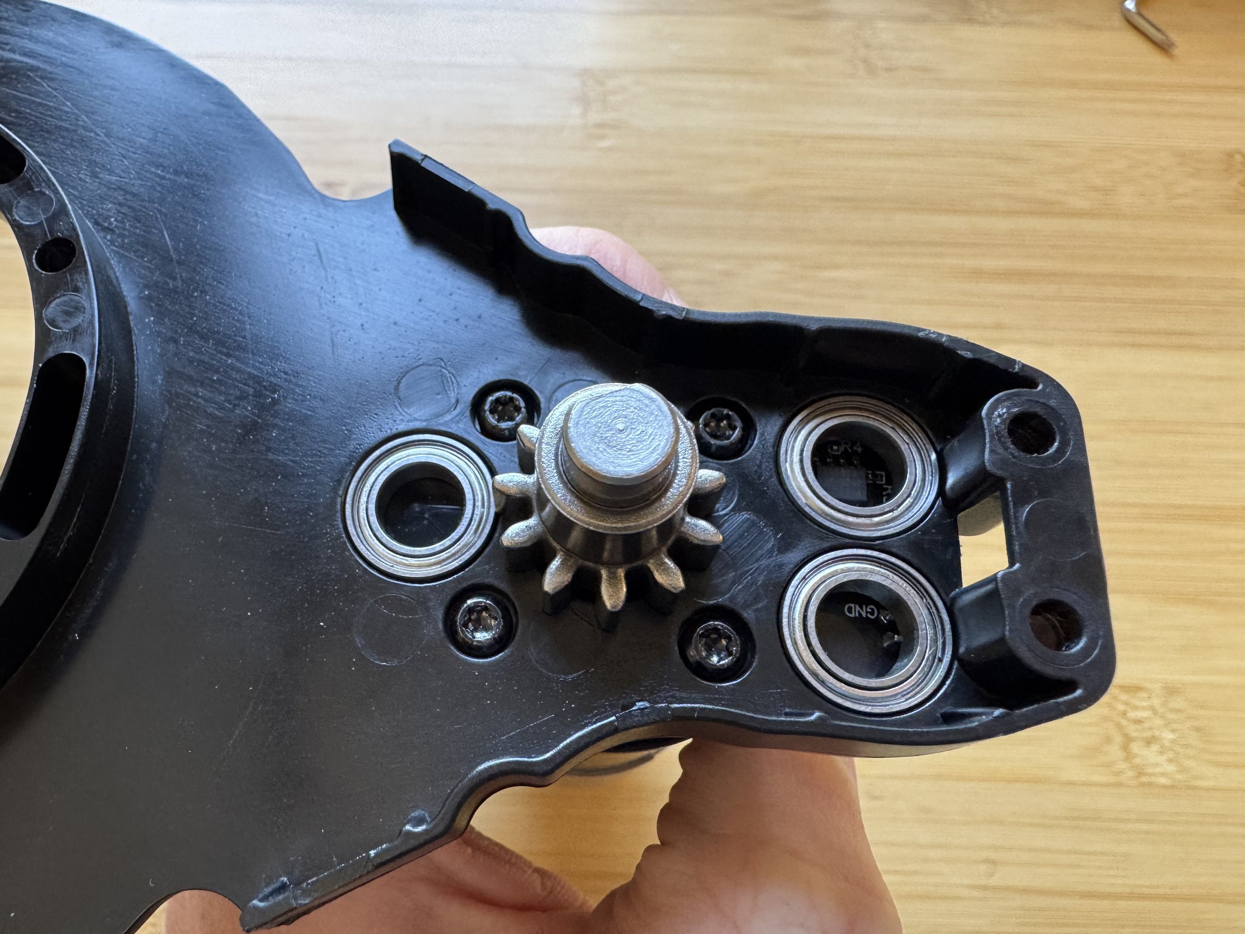

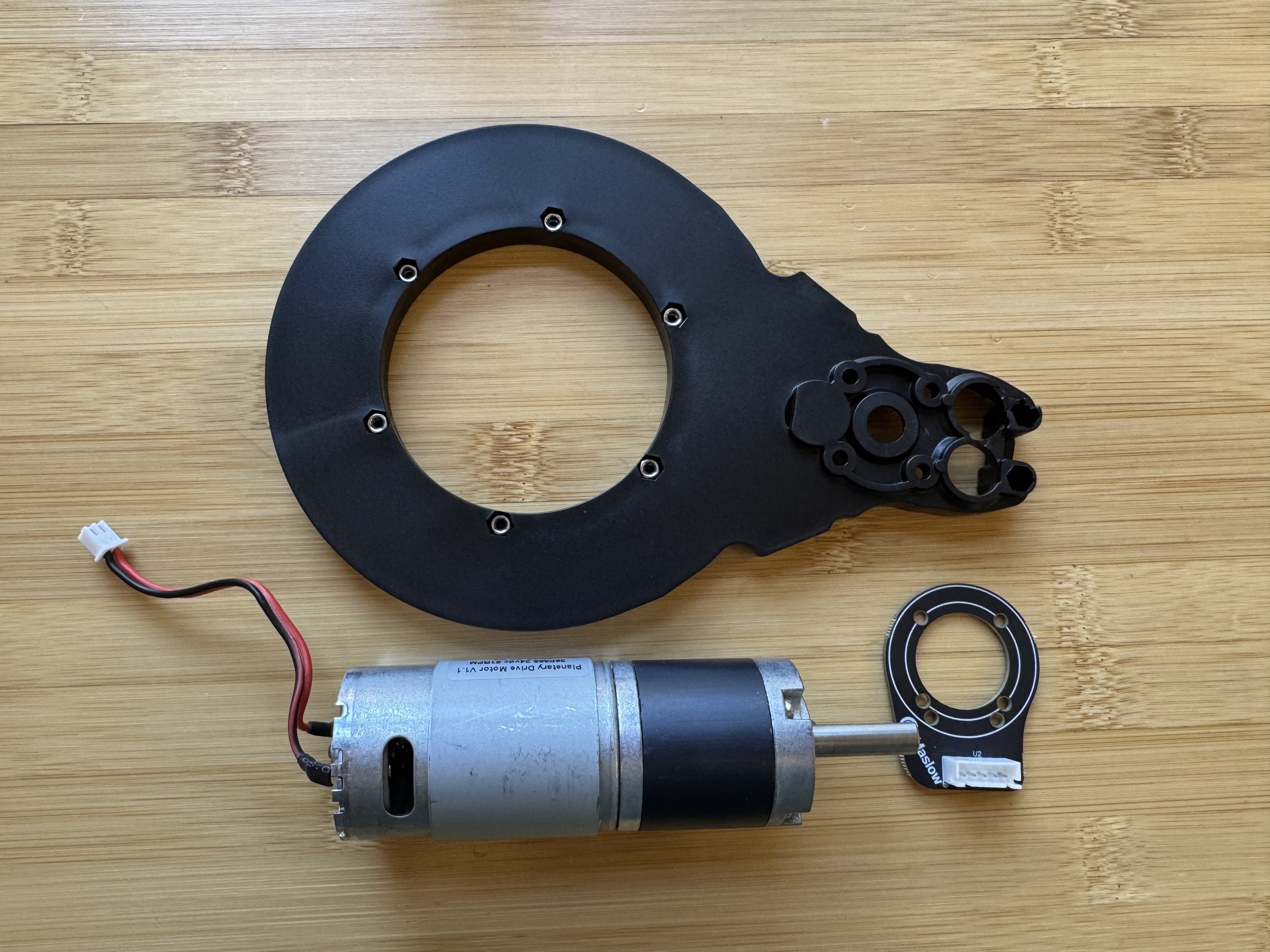

Collecting an arm half, motor, and encoder board
Next, we can start working on assembling the rest of the arm. To do that we’re going to need to collect an arm half, a DC drive motor, and an encoder board.

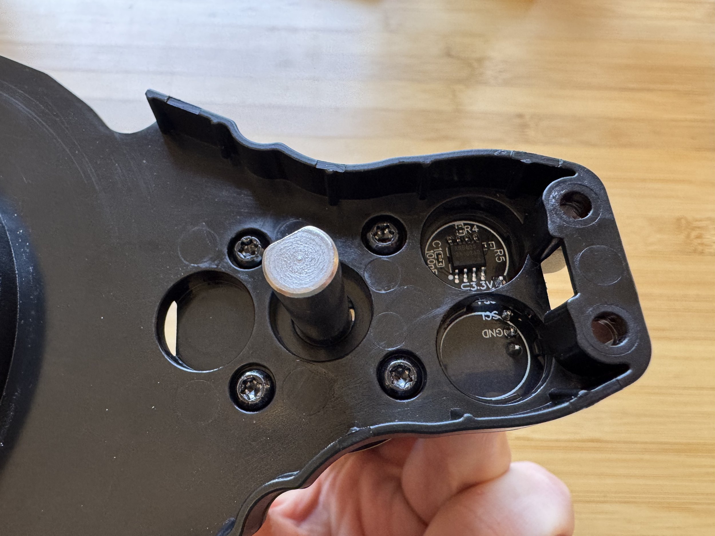

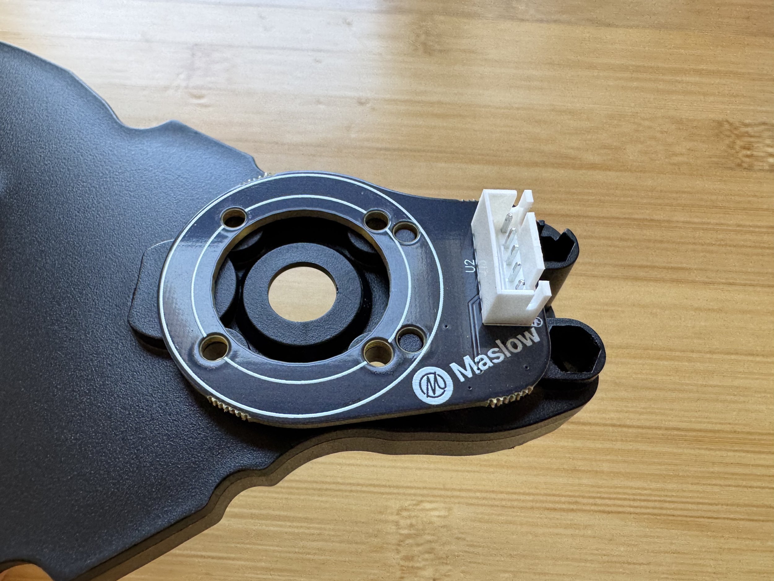

Placing the encoder board over the guide pegs
Next place the encoder board over them. There are two guide pegs which will hold it in just the right place.
Placing the motor over the encoder board
Then place the motor over that. The orientation of the motor does not matter.

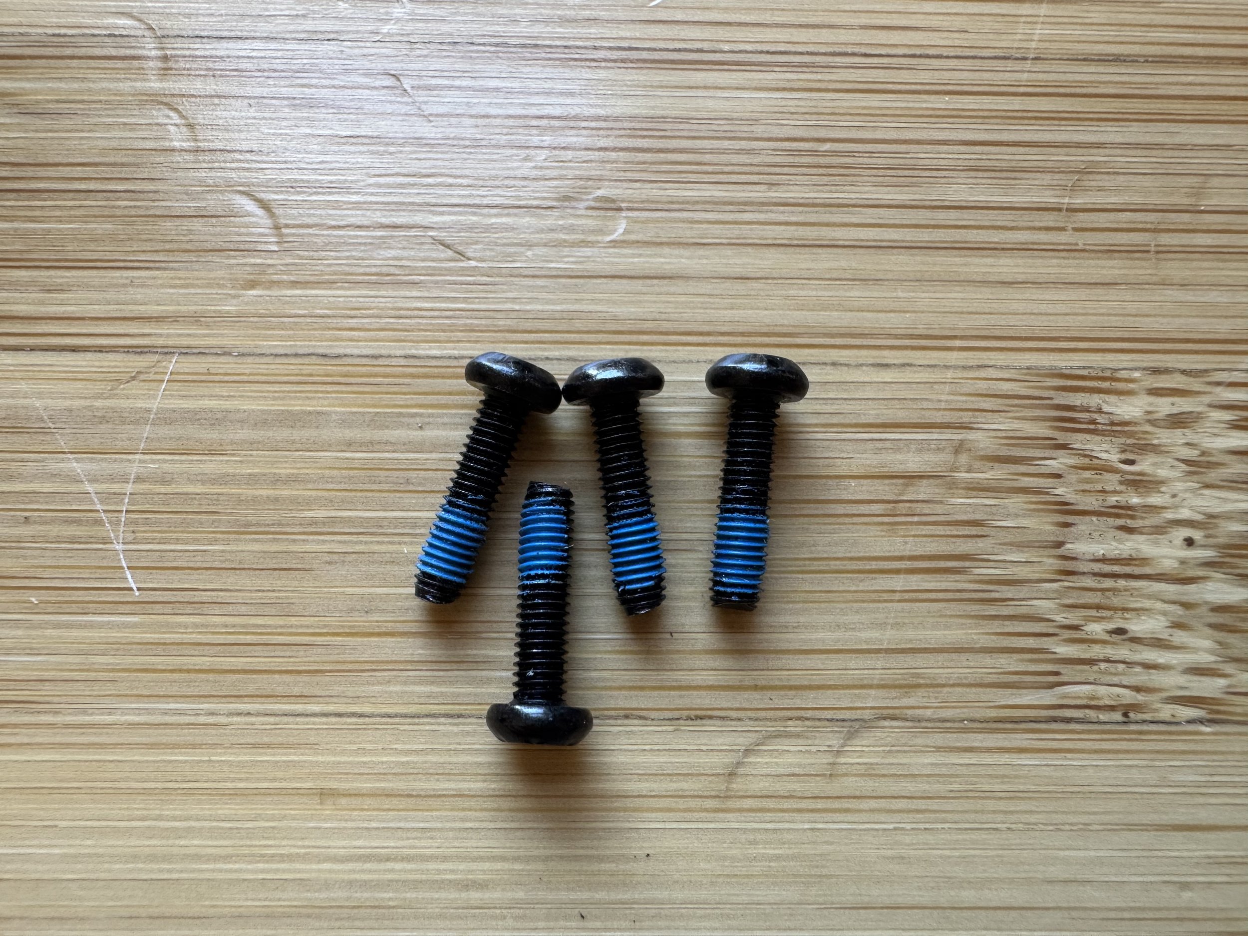

Bolts with blue thread locker for the motor
The bolts which connect the motor to the arm can wiggle themselves loose over time so we’ve included bolts with blue removable thread locker applied to them in your kit.
Collect four of these bolts.
The bolts with blue thread locker will only be used to attach the motors.
Bolting the drive motor into place
And then bolt the drive motor into place.
Community Note: There is some play in how these bolts attach the motor and having the motor further forward (to the right in the picture) is better than further back. If you find that the gears are too tight in later steps you can loosen them up by moving the motor forwards.

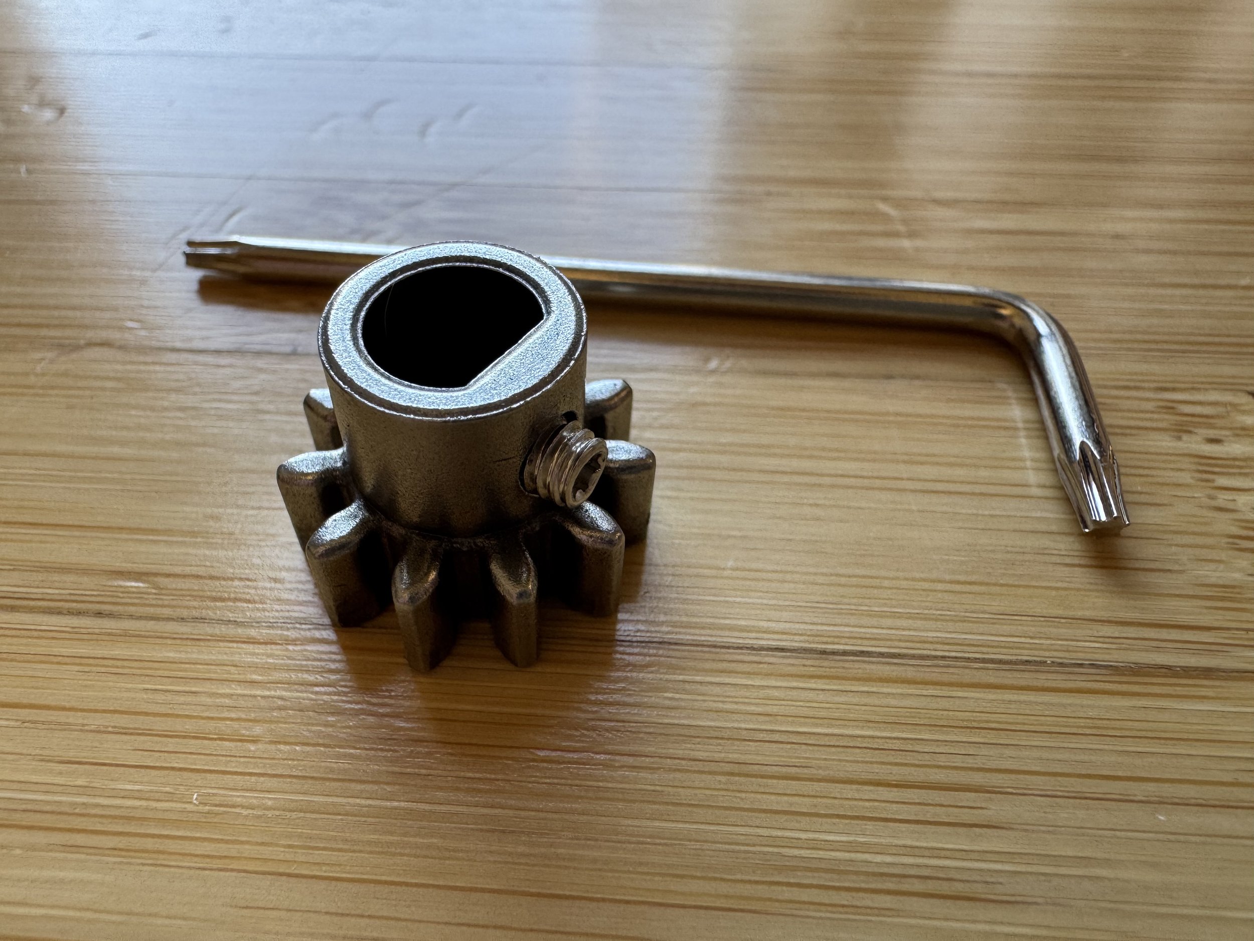

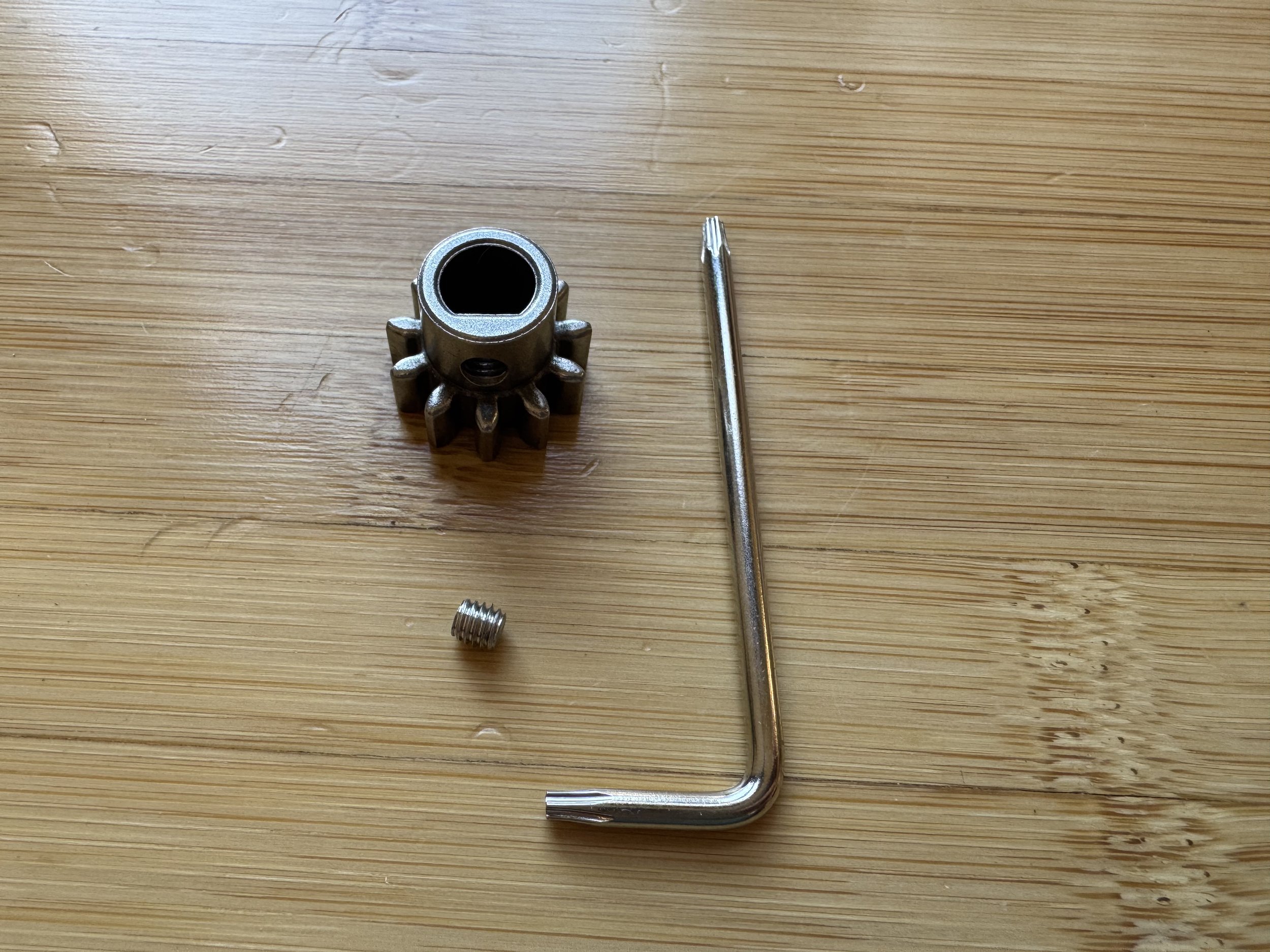

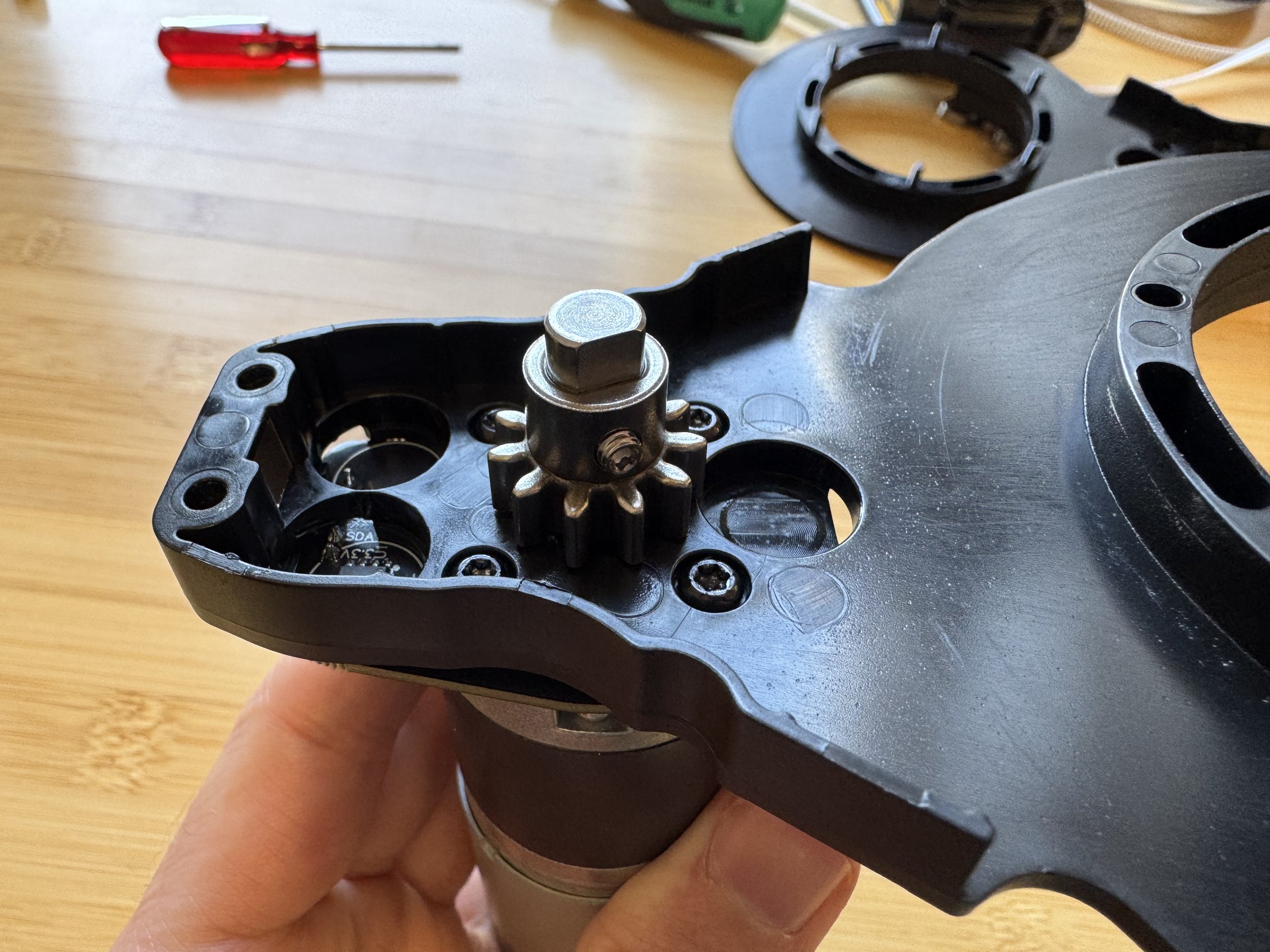

Collecting the drive gear, set screw, and T8 torx wrench
Next we need to collect our drive gear (which has a D shaped opening in the center), a set screw, and the T8 torx wrench:
Threading the set screw into the drive gear
Thread the set screw part way into the drive gear:
Attaching the drive gear to the motor shaft
Then attach it to the motor shaft. The gear should be almost but not quite touching the plastic or lifted up about the width of an index card or three pieces of paper. Tighten the set screw to lock it in place.
Note that there is no bearing under the drive gear.

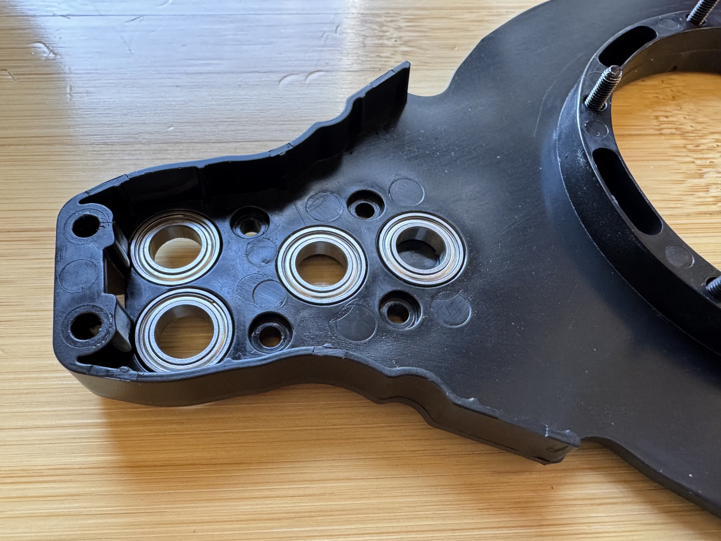

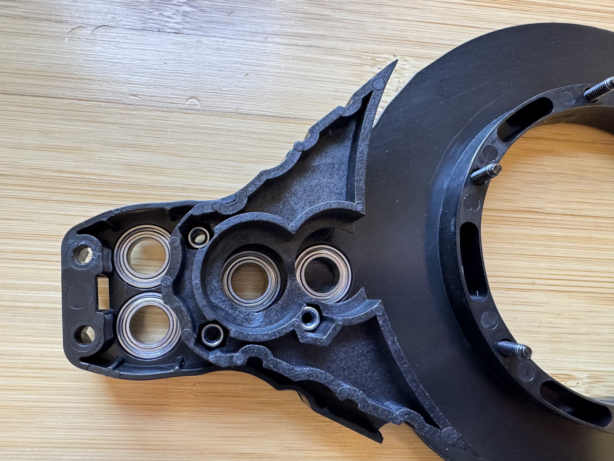

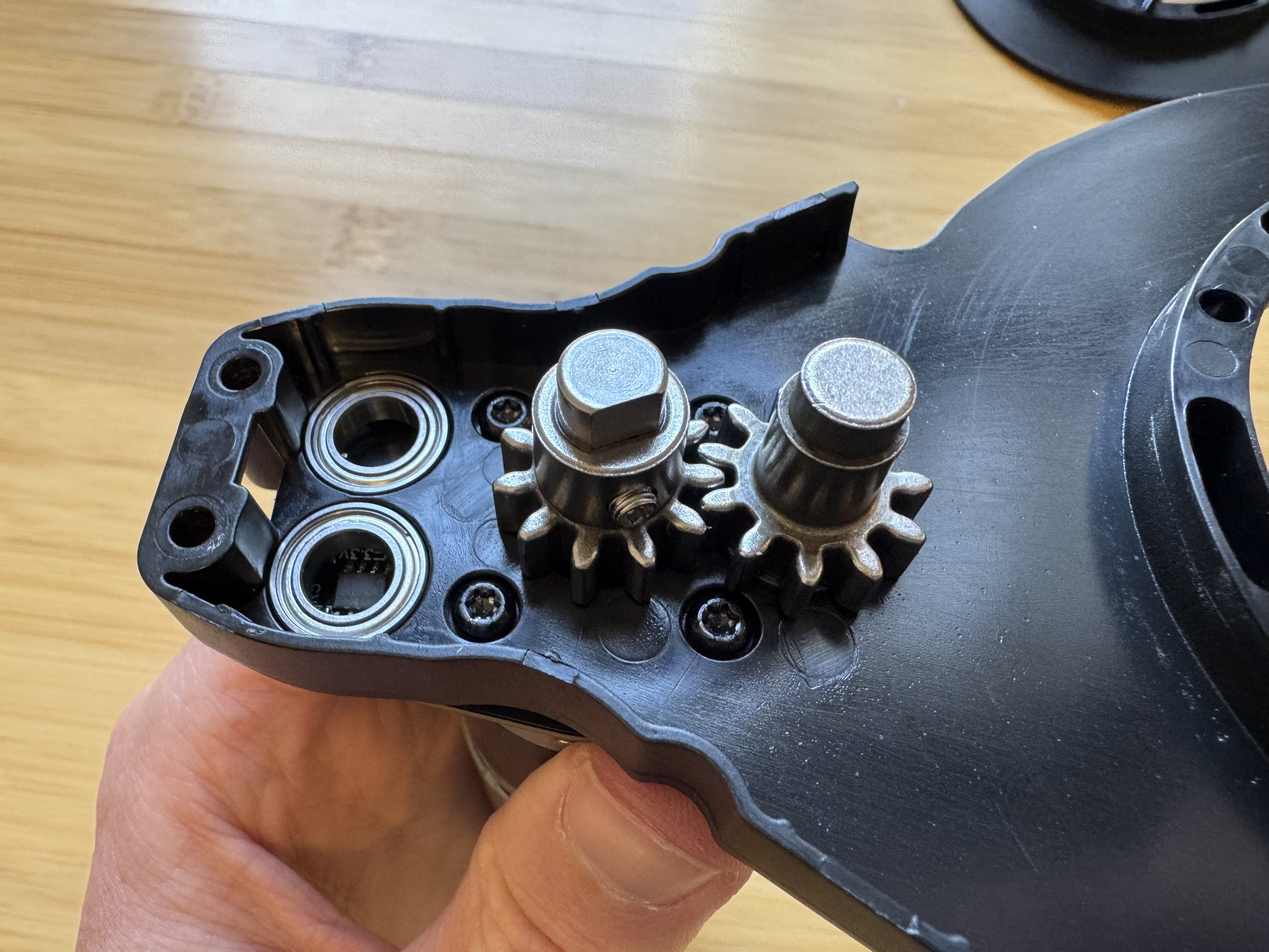

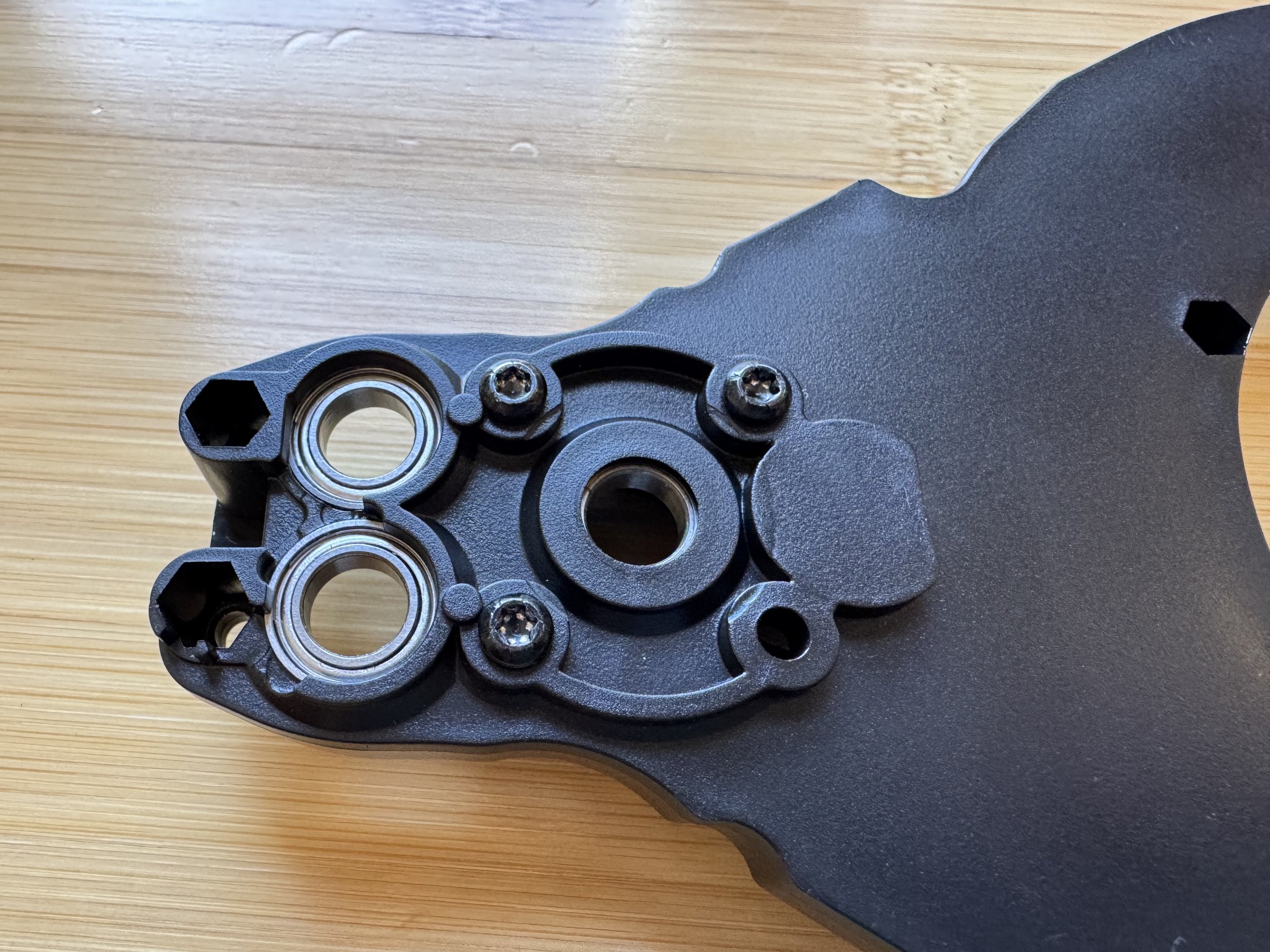

Pressing three bearings into the arm plastic
Next press three bearings into the three openings in the arm plastic as shown here.

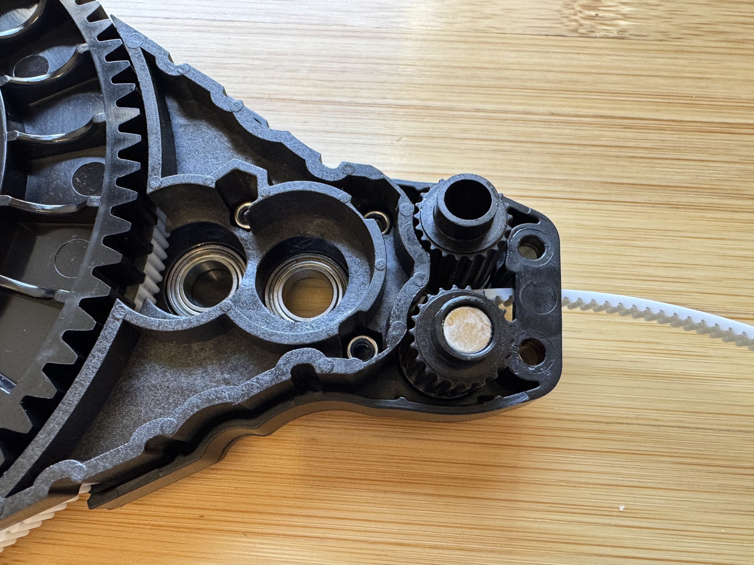

Inserting the idler gear
Insert the idler gear (the gear with the shaft built in) into the bearing next to the drive gear.

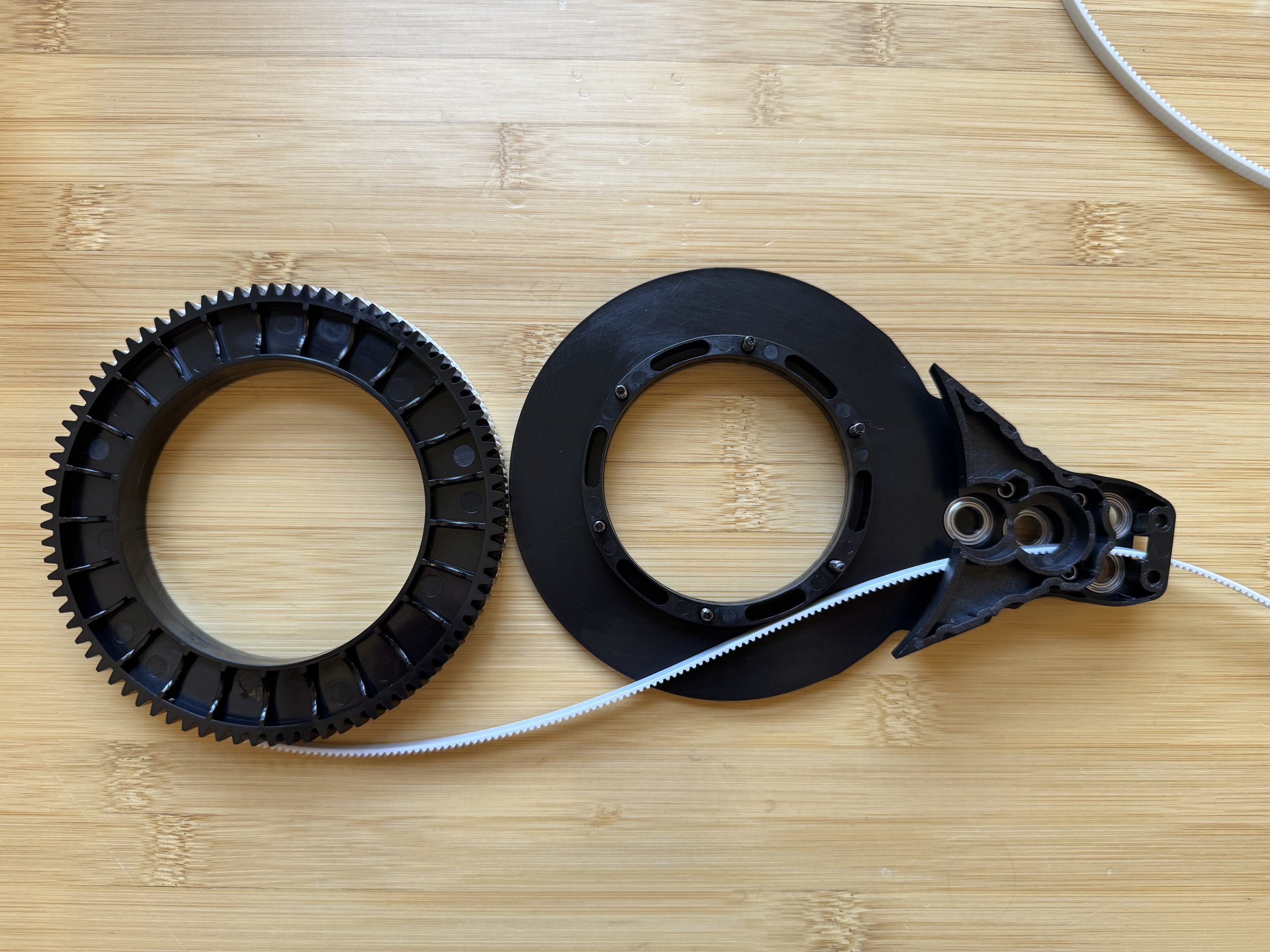

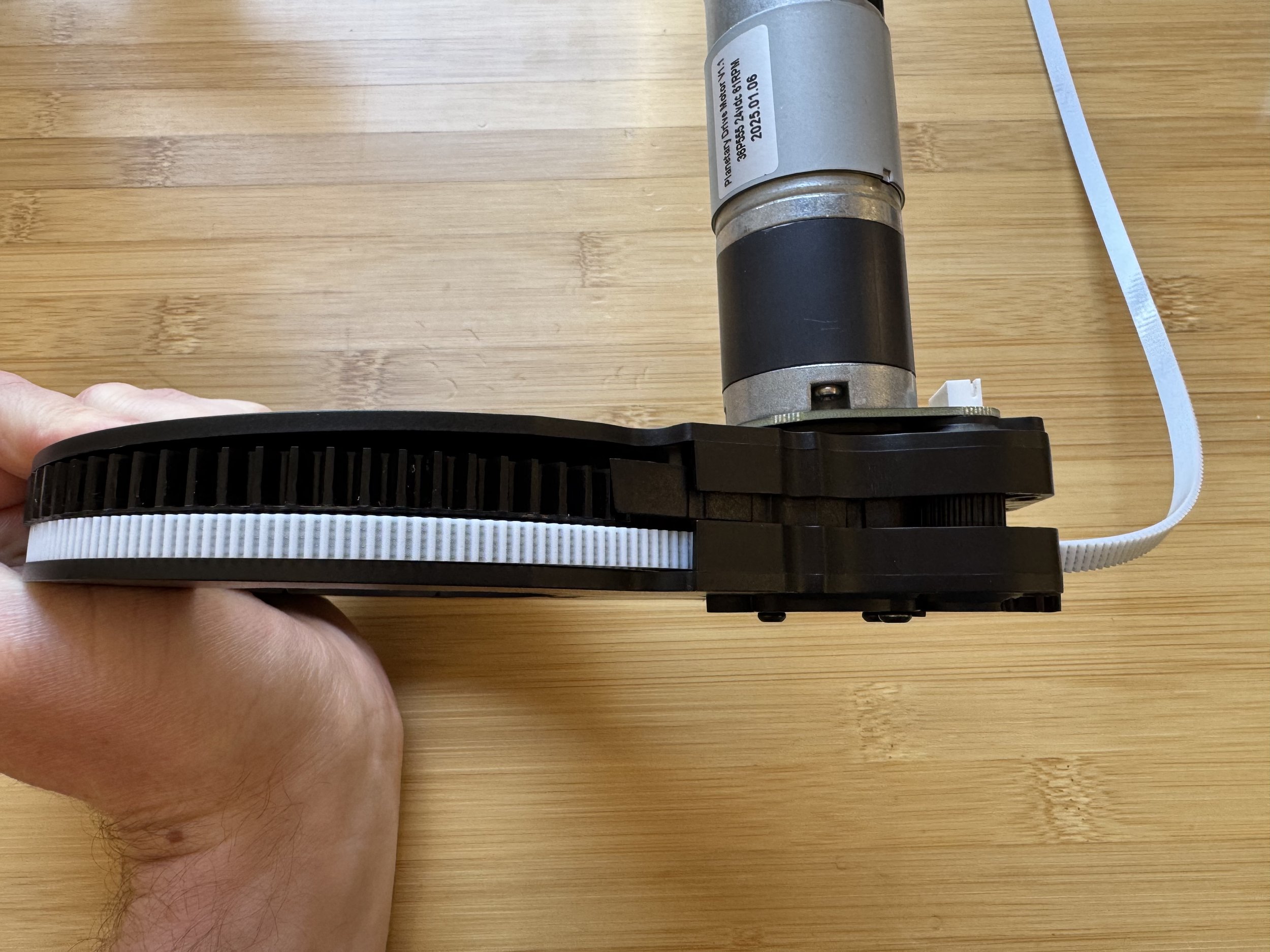

Feeding the belt through the belt guard
Feed the free end of the belt from the spool (belt side down, gear side up) through the belt guard.
Placing the spool onto the arm
Place the spool onto the arm.

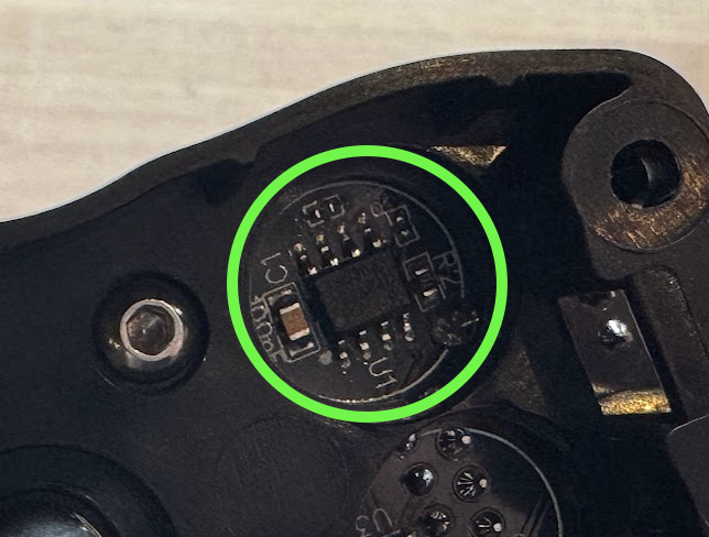

Inserting the two rollers
Insert the two rollers.
Note that one roller has a magnet and the other does not. The placement of the magnet is very important. It must line up with the sensor (in green on the right) on the other half of the arm when the two halves come together.
Magnet and sensor alignment

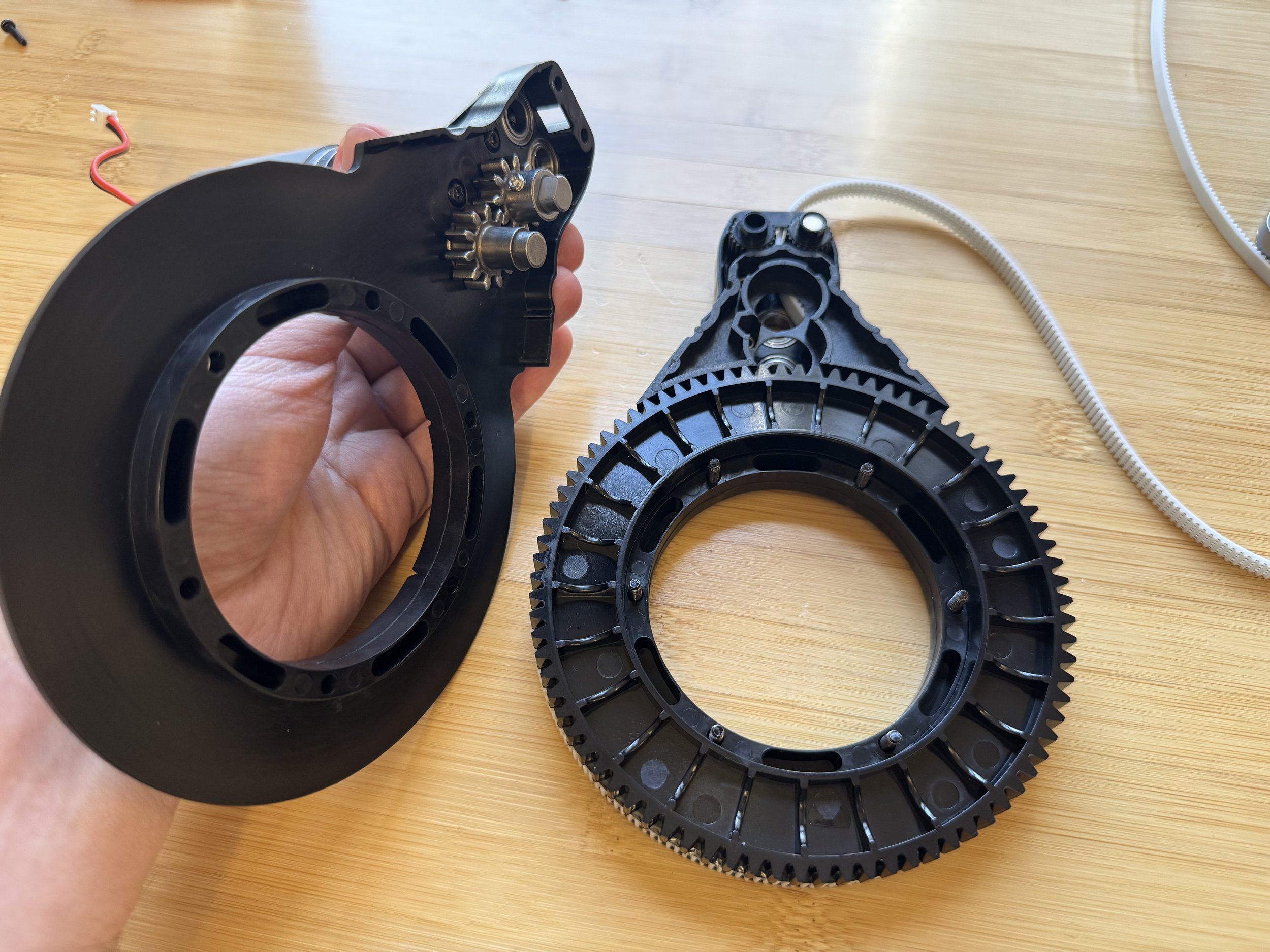

Lining up the two arm halves
Line up the two arm halves and then press the two halves together. This is much easier said than done and this is the trickiest step of the build process.
Generally I start from the back of the arm (the side that doesn’t have the belt coming out of it) and work my way forward.
The three alignment points
There are three things which will need to go into place. First the idler shaft needs to align with the hole on the opposite side. Then the drive shaft needs to align with the opening in the bearing on the bottom, then the rollers will need to line up with bearings on the other half.
I find that by checking each one of these locations in turn and getting them lined up the two halves will come together. It can be helpful to use the allen wrench to jostle the rollers around to make them line up.

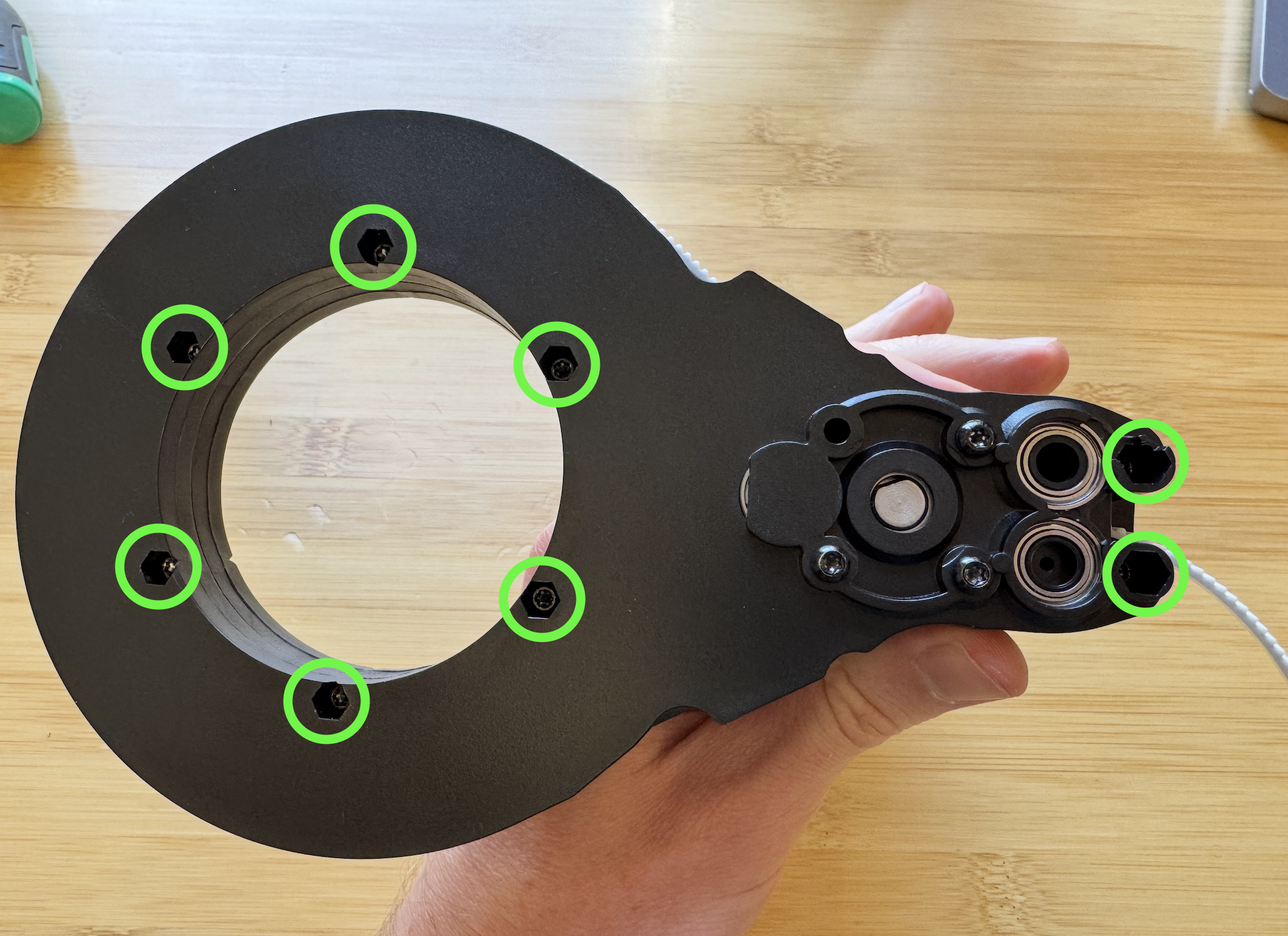

Joining the two halves with eight bolts
Then we join the two halves together with eight bolts.
Six of the bolts are the bolts we placed early on in the assembly process. The remaining two bolts are close to the front.

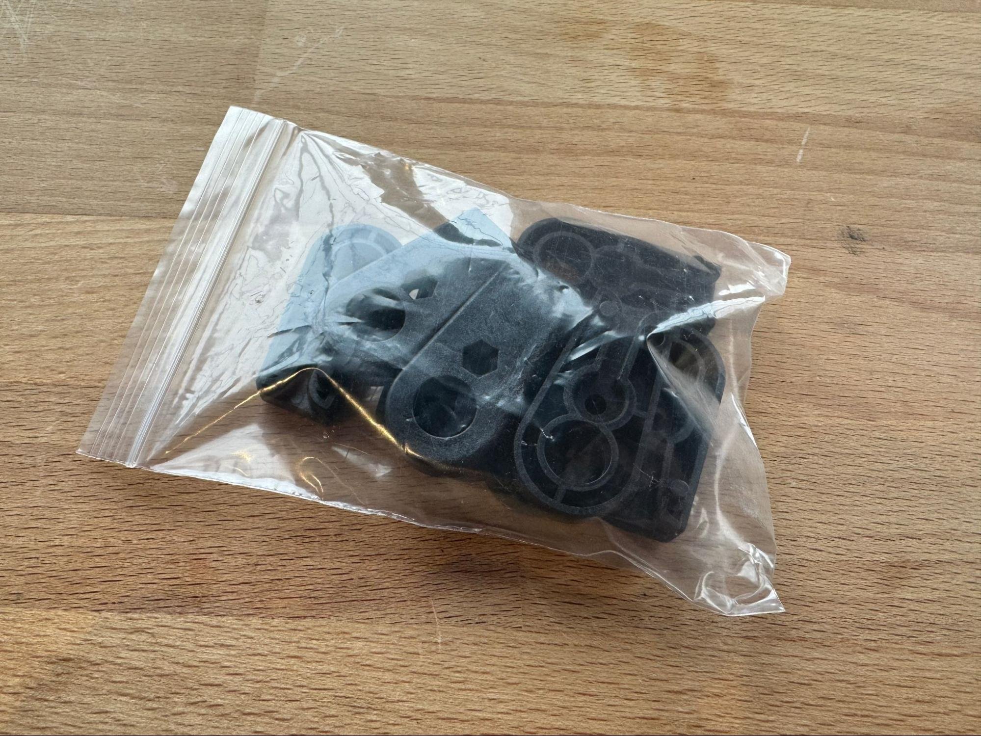

Gathering the eight belt end parts

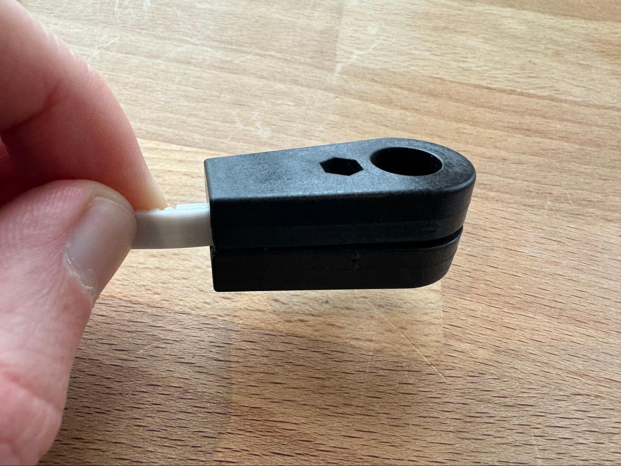

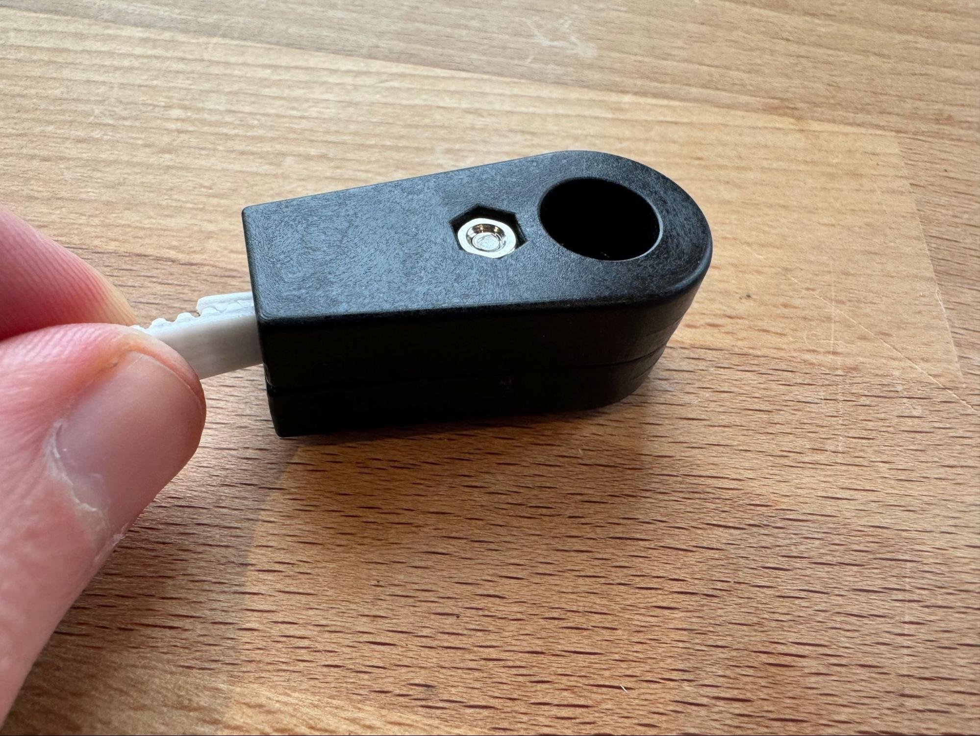

Finally we need to attach the belt end to the end of our arms. Gather the eight belt end parts:

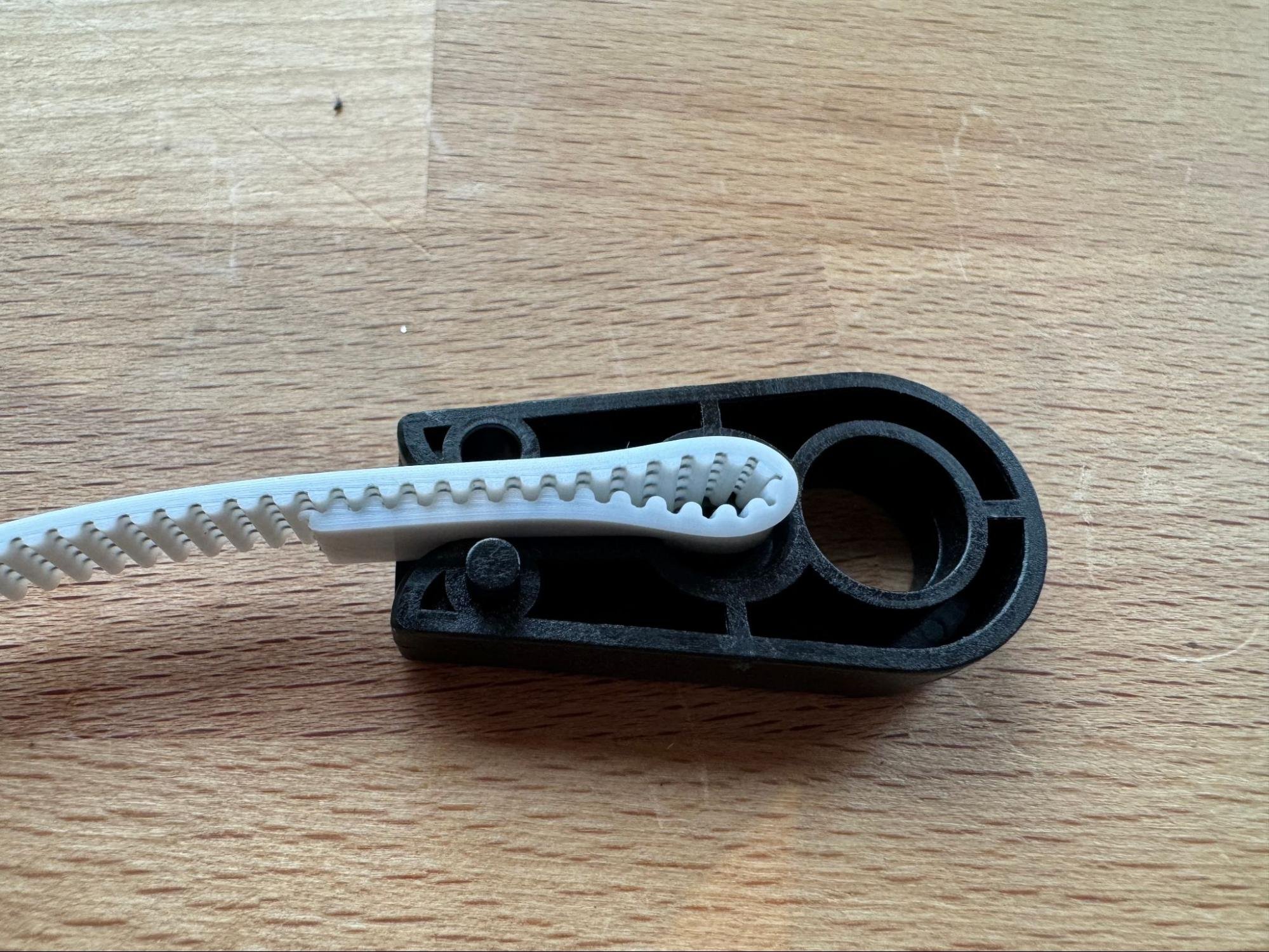

Taking two belt ends and the end of a belt
Then take two of the belt ends and the end of one of the belts extending from our arms:
Folding the belt into the belt end slot
Fold the belt over and press it into the slot in the belt end so that the end protrudes only slightly. This can be tricky to do because the fit is tight (it needs to be tight to handle the force). I find that starting with the loop in the belt at the open end of the slot and pushing it forward works well. You can use the torx wrench to lever it into place. Watching the video at the top of this page can help.
Pressing on the other half of the belt end
Then press on the other half of the belt end.
Securing with a bolt and non-lock nut
And secure it with a bolt and non-lock nut.
